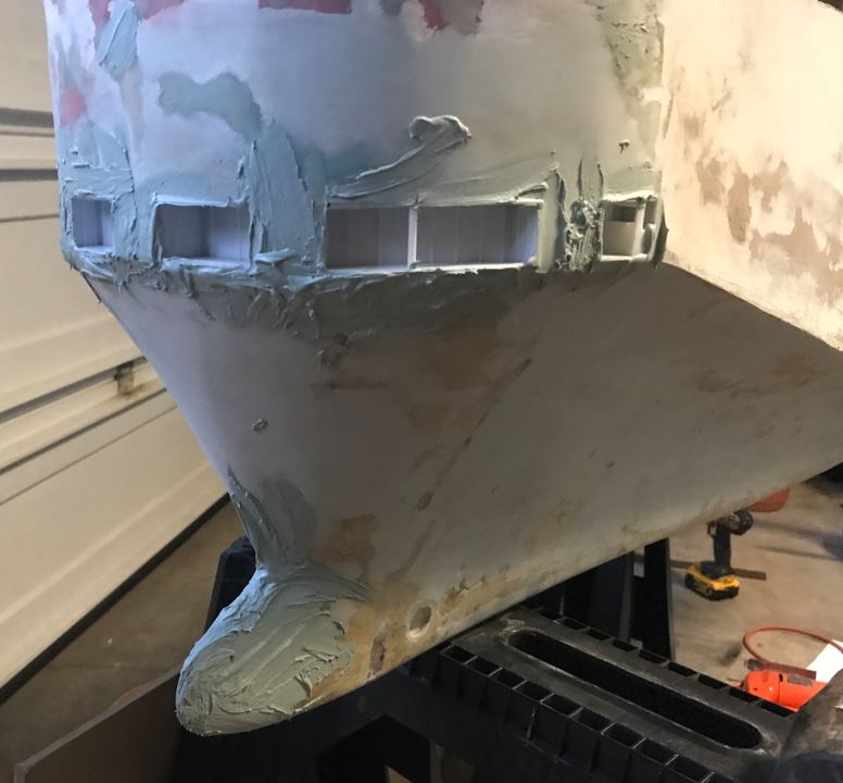

Progess on the Modern Express: lots of sanding, filling, priming, and finally - the first 2 colors
Working on the sternramp and lifeboats now.
Does anyone have a method for making DIY decals with white lettering?
MikeGR, using polyurethane foam allows you to fiberglass right over without it melting the foam
Current:
