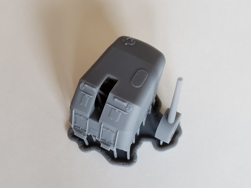

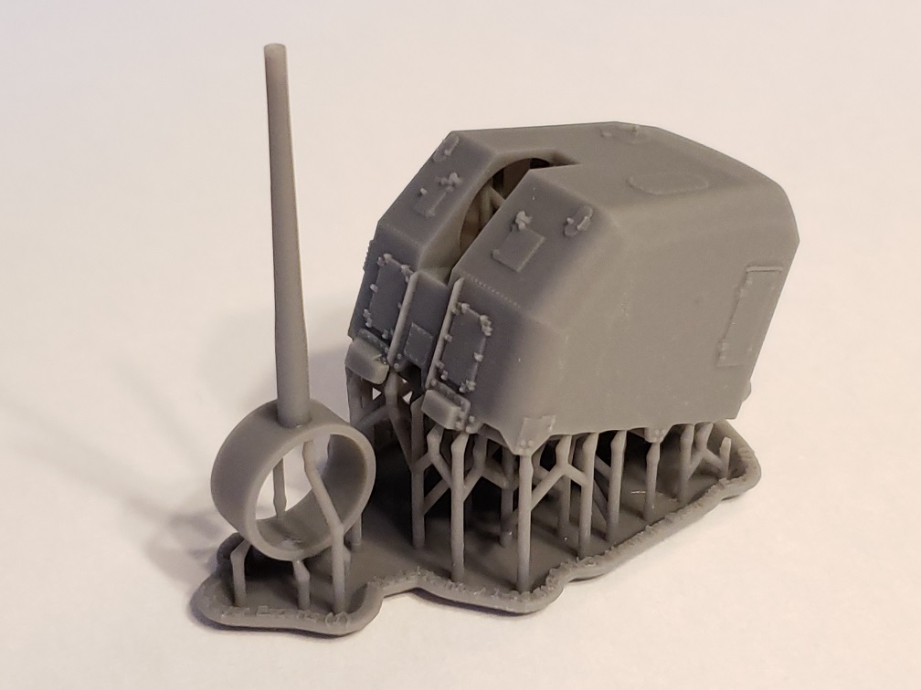

1/96 scale fans! Here's a 5"/38 cal. Mount for Destroyer Escorts:
Model Monkey 1-96 5in38 Mk30 Mount for Destroyer Escorts a.jpg [ 131.8 KiB | Viewed 2440 times ]
Model Monkey 1-96 5in38 Mk30 Mount for Destroyer Escorts c.jpg [ 123.98 KiB | Viewed 2440 times ]
Model Monkey 1-96 5in38 Mk30 Mount for Destroyer Escorts d.jpg [ 127.95 KiB | Viewed 2440 times ]
Model Monkey 1-96 5in38 Mk30 Mount for Destroyer Escorts b.jpg [ 135.28 KiB | Viewed 2440 times ]
Have fun, Monkey around.™

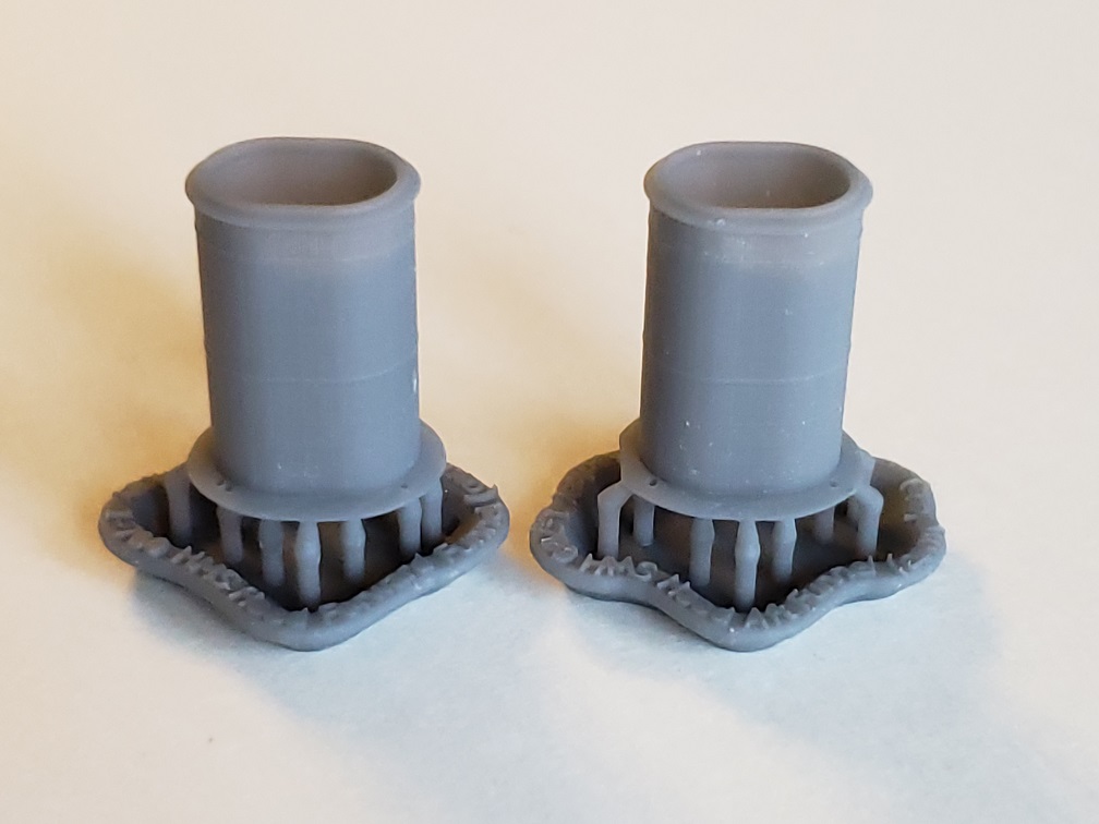

Model Monkey 1-350 Quincy and Vincennes Funnels a.jpg [ 117.61 KiB | Viewed 2346 times ]
Model Monkey 1-350 Quincy and Vincennes Funnels b.jpg [ 118.28 KiB | Viewed 2346 times ]

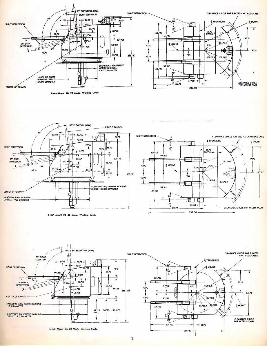

The next logical step was to evaluate the the single-gun Mk.39 gunhouse used by the Midways which did enclose a 5"/54 cal. Mk.16 gun, the same gun intended for the Montanas. Detailed plans and photos for the Midway class Mk.39 gunhouse and Mk.16 gun are available. Here's one good drawing.
Characteristics of the 5"/54 cal. Mk. 16 gun. Comparing Navy drawings of the 5"/54 cal. Mk.16 gun and it's position within a 5"/54 cal. Mk.39 gunhouse to the smaller 5"/38 Mk.12 gun within a 5"/38 cal. Mk.30 single-gun gunhouse, the 5"/54 Mk.16 gun extends 21" further to the rear from the trunnion than does the 5"/38 cal. gun. This is probably because the 5"/54 cal. projectile and cartridge casing were much longer than the 5"/38's projectile and casing necessitating the Mk.16s much longer breech block, and possibly to balance the longer and heavier gun barrel.*
Busting the gunhouse floor. Computer 3D modeling confirmed that the longer breech means that the gun has to be positioned higher in the Mk.41 gunhouse than where the 5"/38 gun is placed in its gunhouse. That in turn requires the gunhouse to be taller, too. When the gun barrel is elevated to it's design maximum of +85 degrees, the longer breech block extends downward further. If you put a 5"/54 cal. Mk.16 gun in a Iowa class 5"/38 cal. Mk.28 gunhouse, the gun can't be fully elevated because the breech comes into contact with the gunhouse floor long before the barrel reaches max elevation. To keep that from happening, the 5"/54's trunnion must be placed higher above the gunhouse floor than the trunnion of the 5"/38. Thus the gunhouse roof of any gunhouse enclosing a 5"/54 cal Mk.16 gun must be taller than a gunhouse enclosing a 5"/38.
Notice in the drawing above, the design of the Midway class Mk.39 gunhouse reflects the need for a taller gunhouse. The trunnion on the real Mk.16 gun in the real Midway class Mk.39 gunhouse is positioned nearly 15" higher than the trunnion of the 5"/38 cal. Mk.12 gun in a twin-gun Iowa class 5"/38 cal. Mk.28 gunhouse. Compare:
