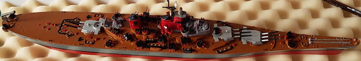

as said in the USS Iowa fan tread...gonna re-do my revell 1/535 Iowa kid I did almost 40 years ago...first...starting point....

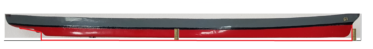

gonna use my Kangnam 1/400 USS Missouri kit as reference for stuctural modifications...and next pictures as always

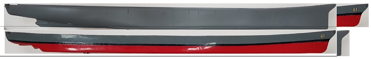

next step is looking what has to be done using computer ...let this be clear...I don't use plans to be 100% exact...(and doing only 1 project in my life lol)
it will be a mere visual approach...so in taking pictures of both...bringing them to same size...I now can see better...what to do and where to modify without re-doing the entire hull...luckily...the revell hull is a bit too low from bottom to deck...giving me the possibility to add and form some roundings as the revell is a bit square

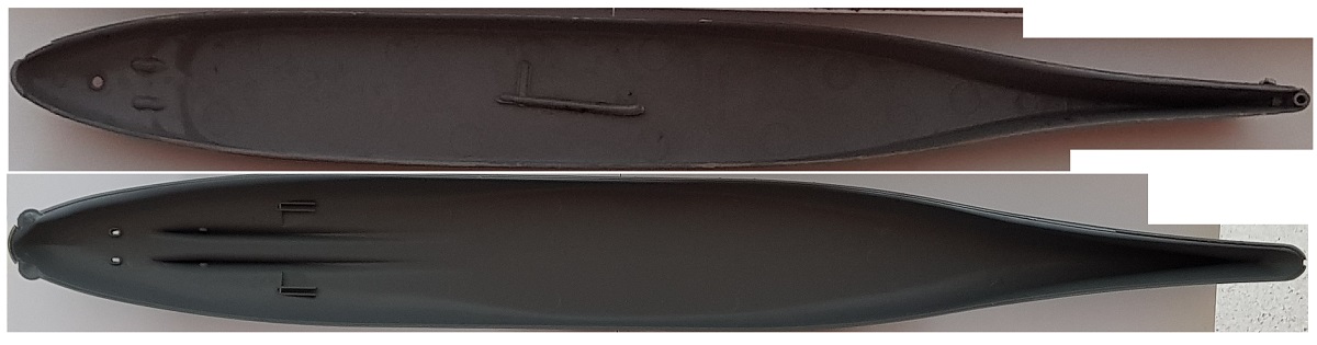

I don't see much trouble in the bow...even if a bit narrow....main hassle will be rear part...the revell is realy ...very square and wrong

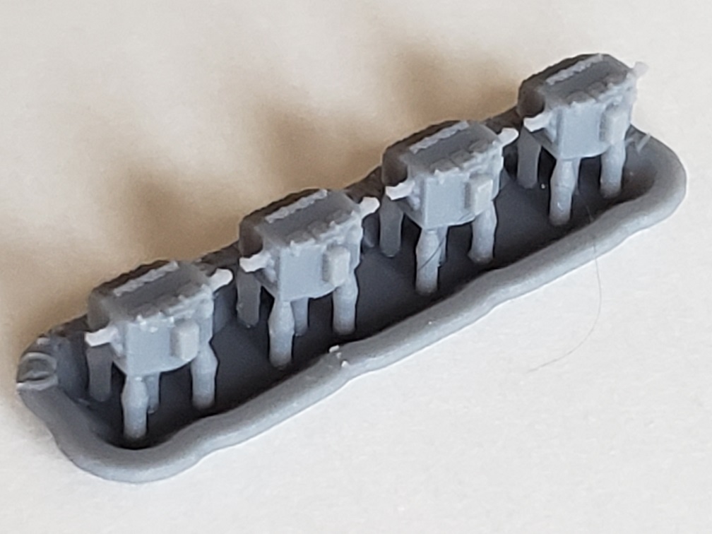

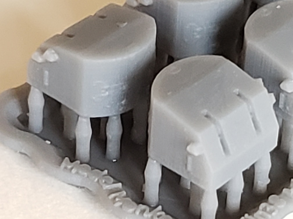

I just bought scale 1/535:
5"/38 cal. Mk.28 and Mk.37 Directors, "Angle-back" from Model Monkey 3D-printing
decided to buy the guns as one 5" gun is missing...its... or make all new...or try to scratch build it exactly the same...witch is not sure to be easy...lol
and the directors...well...as I already ordered one thing...better use the posting already payed for.....in adding some more, also bought the 1/400 Bismarck main guns with blast bag...have that one ...and Tirpitz in waiting for the make.
that way I can see difference and decide if I go for more 3D printed stuff
and yes I saw the quadruple guns @ 3dmodelpart....but they are out of stock

gonna line all on rear...say fins so ...make space to put in fins...and no more way back lol
