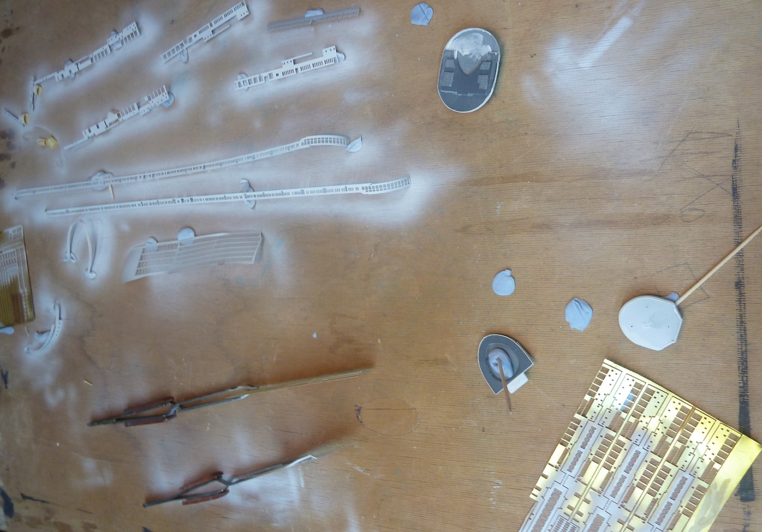

the funnels have received some colour-
and I have bought a new airbrush :big_grin: )

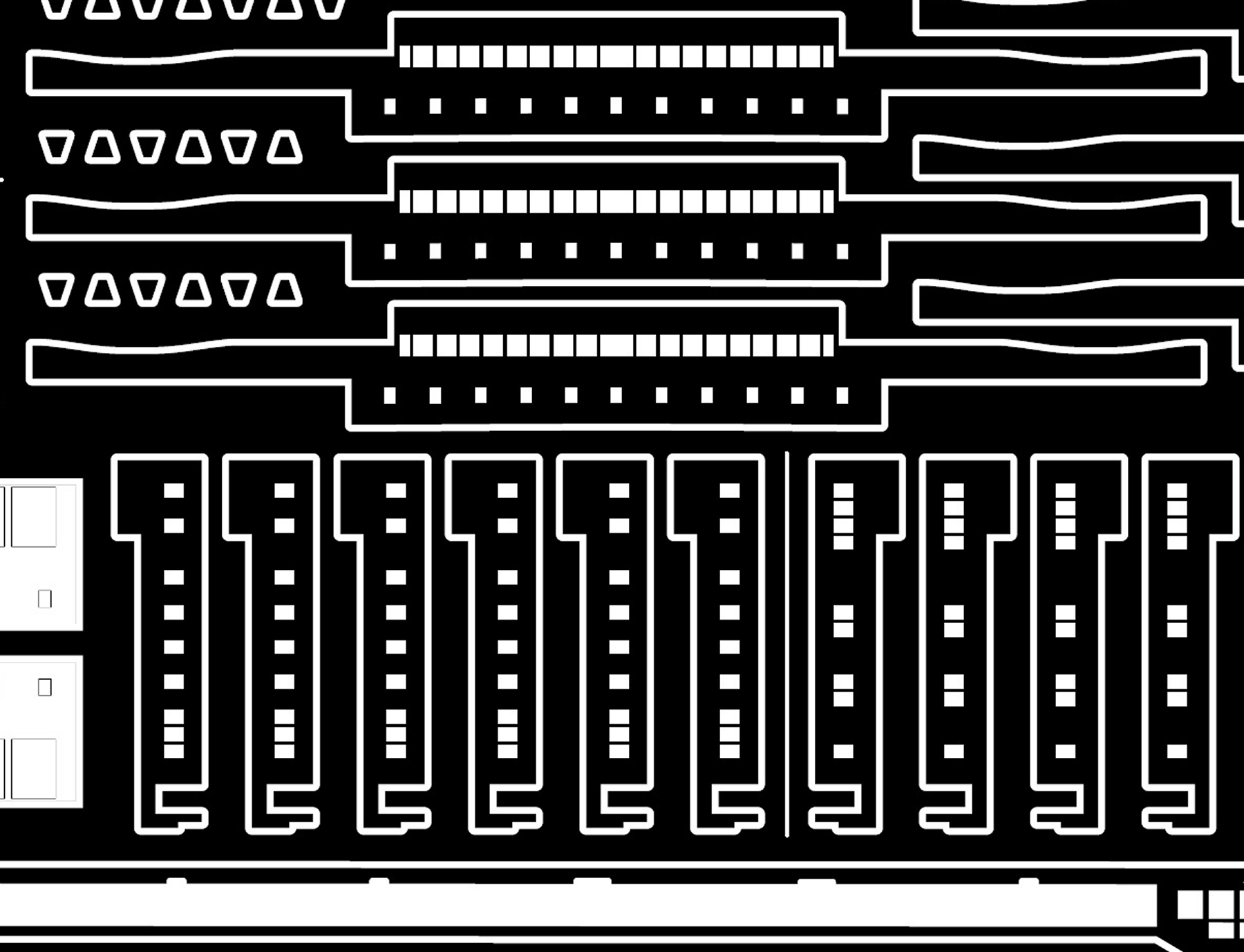

I have commissioned more PE---well actually the same PE...-- more precisely the promenade window overlays ( again !)
but slightly re-drawn with slightly thicker window mullion bars and this time being etched in stainless steel...
as the brass was a bit weak in " vertical column"-
-ie when manipulating the overlay strips, the vertical window dividing strips ( mullions) often buckled and/ or got a bit distorted / bent
Stainless steel is much stronger--so should give a crisper result

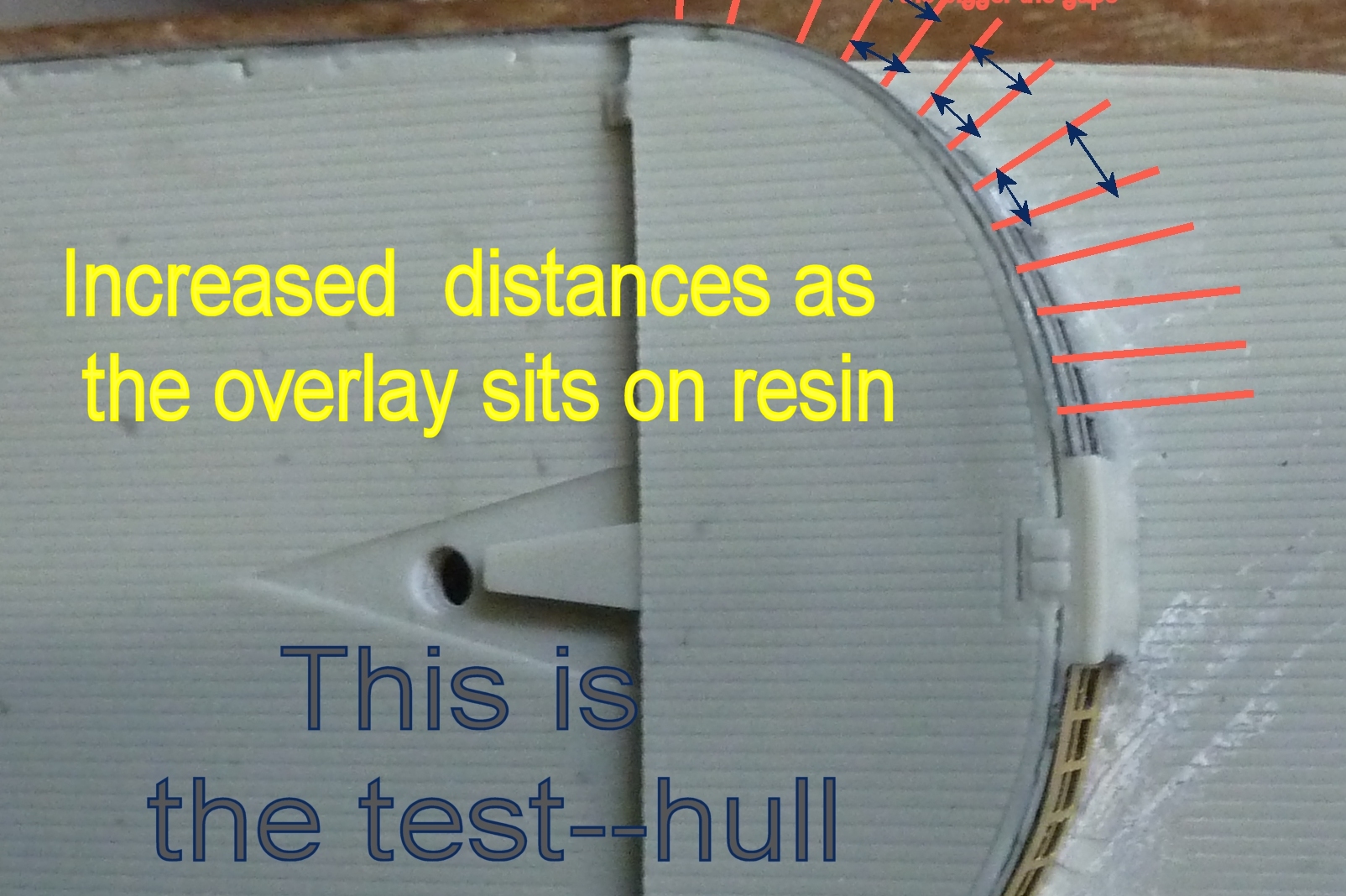

On the subject of promenade overlays..-- I have for the last 2 weeks continued to - every day -take the model from cold room to warm room.
==> There appears to be no parting of the glue , nor any visible distortion of the metal overlay.

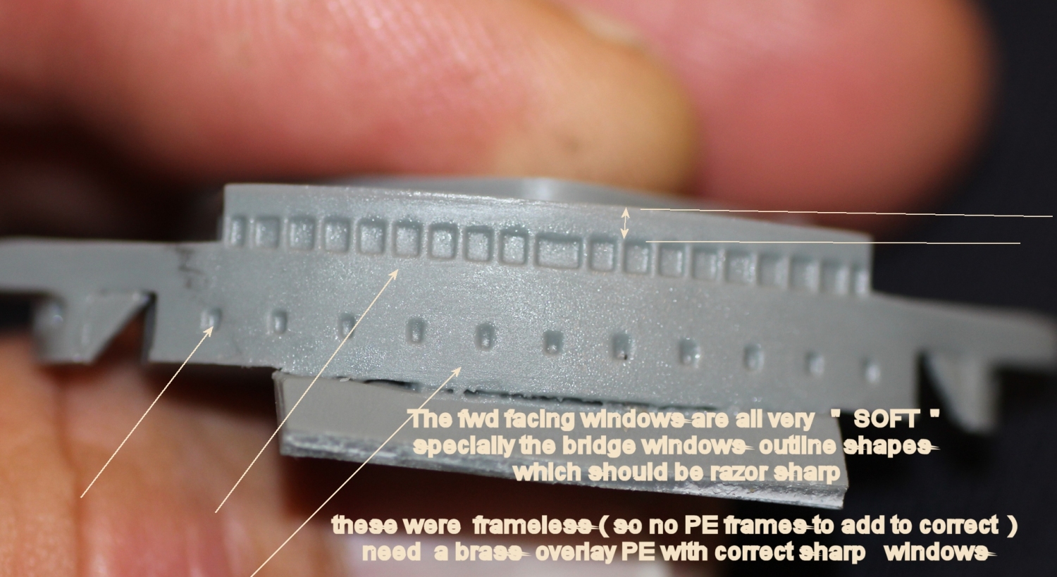

whilst having the PE re-drawn for the stainless frets , I also took the opportunity of getting a new bridge front and upper bridge sides drawn;
Mainly as the casting did not have quite sharply enough defined windows for my liking...
compared to the real thing
The bridge side windows had a very different layout from port to starboard, hence these are being done as PE overlays also, so that the sharpness would match! :cool_2:
over-thinking and over-planning maybe....

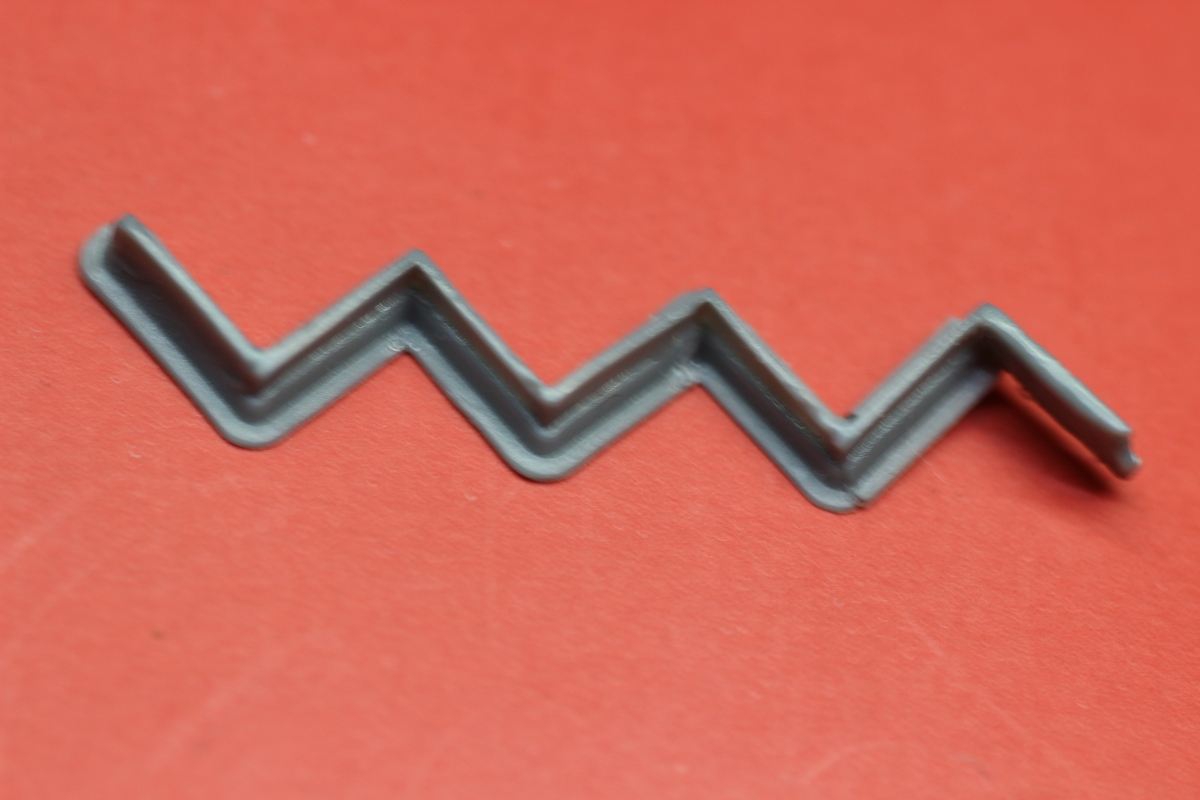

...The early version of the ship--with the "zig zag " seating ( and the above mentioned lamps)
My casting of this deck was not all that flat , bathing in hot water and heating made it flatter, but still not that good.
I also did still not much like the seating, as the casting on the undercuts was a bit lumpy
and in any case the seating would make the fitting of the paper deck rather more challenging (!!)
hence off they came...
I planned to re-mount the seating on the new deck coverings on styrene strip plinths to regain some sharpness
but cut around and clean up as I wanted--they did not look quite sharp enough .
( more precisely I could not get them sharp enough
Most models of this ship in this fit , even in in much larger scales, always seem to depict the seating in too lumpy a fashion
So I had some replacements 3_D printed! :cool_2:

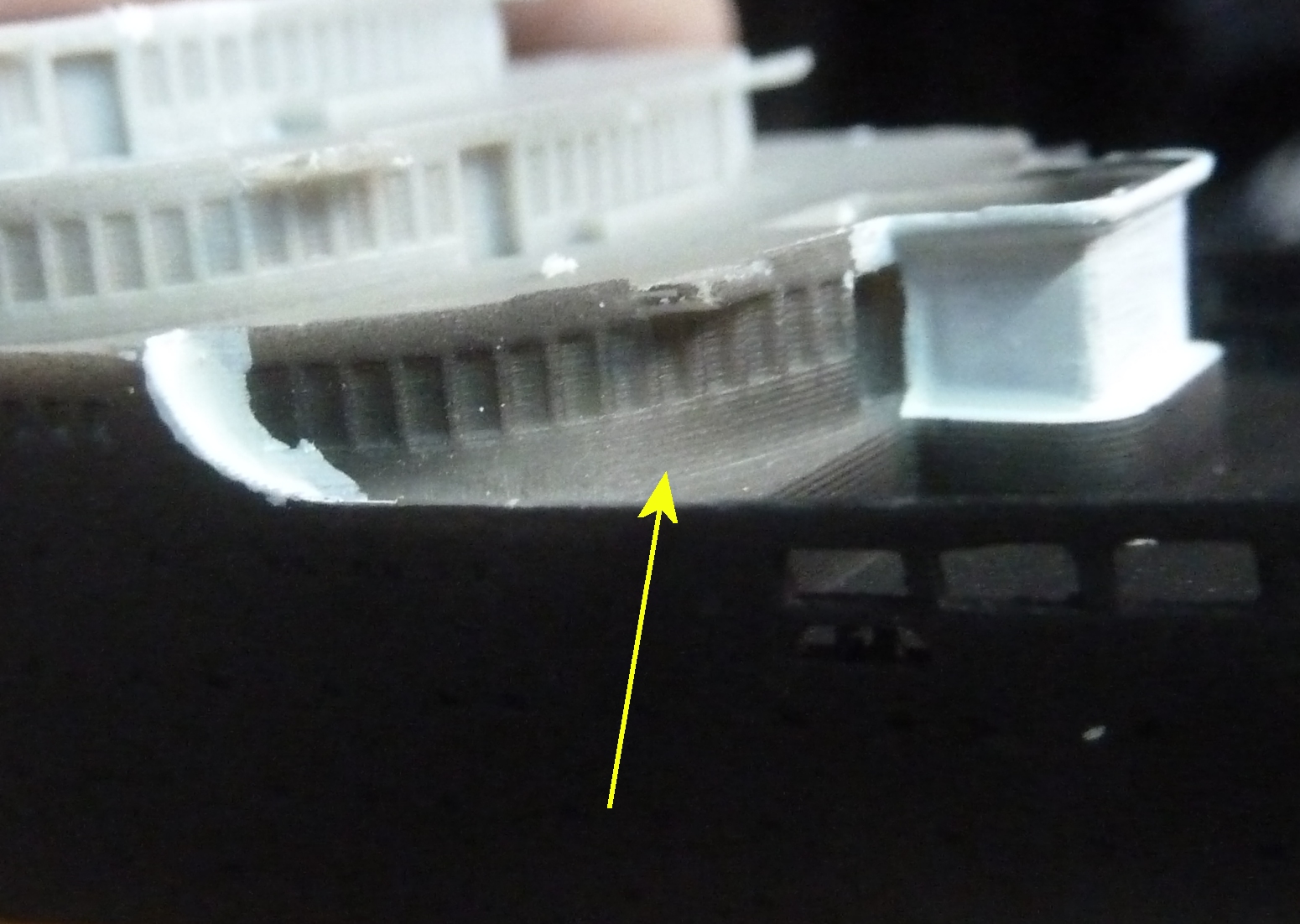

and been rather bothered by the large amount of 3 D printing lines left behind
which are the very devil to clean up in this kind of area

I am still somewhat irritated by the coarseness of 3 D printing
( this is a general malaise across many manufacturers )
( especially in window recesses-- which compounded with somewhat ' soft ' casting makes it all just that bit harder
with significant risk of damage.
Nothing and no damage is irretrievable-- but ...

I have continued observing the adhesion versus the thermal expansion issues
on my test-hull
and my findings ....of apply PE to resin casting when metal and resin are cold at just under 10 degrees C --
and pleasingly-- it seems to have worked as planned ( and desired !) on the new stainless steel also
( despite s/s having a lower expansion ratio than the brass PE of the earlier previous experiments)
Backwards....

I was bothered a bit that my fwd window overlays may render the inner PE window frame bars to be too far recessed.
this was the first one I did in the " actual " hull ( having made quite a few on the test-hull ! )
( The tiny , bendy and fragile pre-painted PE was floated on to matt varnish and jiggled until it was 'right'
The " cracks "were " filled " with white paint on brush
note that this will all be contained within the mullion and frame overlay and present a sharp apperaamce hopefully
as to excessive window recess.... I think I need not have worried too much
phew! :cool_2:

My original hull casting had a rather dished life=boat deck deck, which runs from fwd to right aft.
==> which was alas noticeable to the naked eye
The deck superstructure that sits atop that , tediously had a warp in its horizontal plane,
that I failed to straighten with heat , oven and hot water
Now then... Credit where credit is due;
an e-mail with a photo and a voice-call to Brandon @ Freetimes Hobbies resulted in a
pretty speedy transatlantic service , no quibbles and with a new hull and superstructure casting being despatched at top speed.
so onwards;
The new custom ( Mk3 and I think final! :cool_2: ) Photo-etch fret is being drawn up right now, and will be etched within 2 weeks .
again in stainless steel , again incorporating the re-re-redesigned promenade windows and new curved aft window galleries to match,
with a few subtle modifications, one of which brought about as a result of the differing radius build up when overlaying metal onto resin...
....and the surprising difference that the thickness of the paint on the mullions had ...
briefly as below
so that all the cast resin mullions and the PE mullions match exactly--(!)
the distance between the vertical mullions has to be increased gradually and fractionally
the end result looks like this on the PE drawing-- and as a "Fail-Safe" back-up.....
the same piece will be drawn with a 0.3 mm stretch-- just in case!
