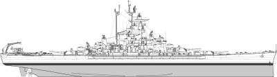

Hello
I am working also in the other two classes. Is the boot topping also tapered?
PostPosted: Fri Dec 14, 2018 1:03 am
Posts: 5060
I checked out the drawings in Garzke and Dulin and no taper is shown. But... The drawing for the Iowa's does not show a taper either.
Good question!
