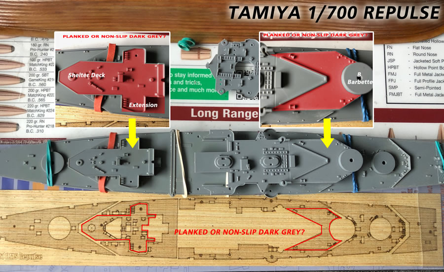

1. Deck Composition-Planked vs Painted Metal AreasI know that most of the large deck spaces on Repulse were planked in 1941. I also know that areas such as the focsle, bridge decks, platforms around the funnel, mast platforms, etc. were likely painted with non-slip paints. I plan on using an Artwox deck veneer for this model (I've always painted them before, but I figured I'd try an actual wood deck this time). They provide wood for most of the decks...including some areas that I find questionable. So, I'm looking for proof (or at least the latest consensus) regarding these areas:
A. Raised deck aft of B turret and forward of the bridge- the Tamiya kit (part A6) shows this as planked, but I’ve seen at least one 1941 photo of her at sea which shows a very dark deck which looks different in shade than the confirmed planked area ahead. It suggestive of painted steel. I also could’ve sworn I’ve seen earlier photos showing no planking in this area just behind "B" (but to be honest, I can't recall "when" the photos were from and they could've been from before the planking was originally added). What’s the consensus?
B. Shelter Deck- the Tamiya kit (part B29) does not depict the correct shape of this structure (I know to create the expanded Royal Compartment to starboard). Tamiya also shows this entire area as planked. I am unclear on whether this was actually fully planked. I know that the original area was planked, but am not sure if it was expanded to the two side wings (or if it was all removed or painted later). Has anyone ever been able to verify this? This is one of those areas for which I've seen conflicting info.
C. Aircraft Catapult Area- I believe this was planked. Can anyone verify this?
2. Missing DetailsA. Rear Superstructure- this is the Shelter Deck and upper structure just forward of “Y” turret (formed by parts B29 and B44). The Tamiya kit is very bare/plain in this area (just like their Hood) and in need of even the most cursory detail. Can anyone share an accurate plan scan showing the location of portholes, windows, bulkhead vents and doors in Dec ‘41? The only thing I ask is that you please not use Kagero or the Morskie stuff...after their flawed Hood products (sigh), I’m afraid I don’t have much confidence in them.
B. Various- I know I need to add vents around "B" barbette. I also understand that there should be no AAA gun tubs forward or atop "Y" turrets (but assume the ones abreast the aft superstructure and mainmast were indeed present). I also need to enclose the port side of part B45 (but am unclear about starboard).
