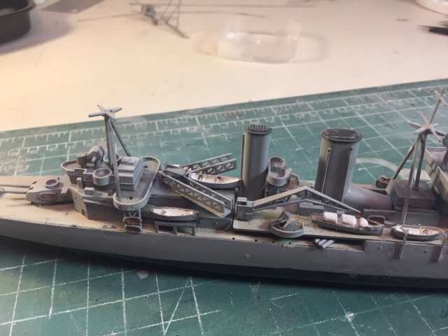

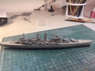

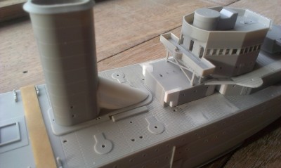

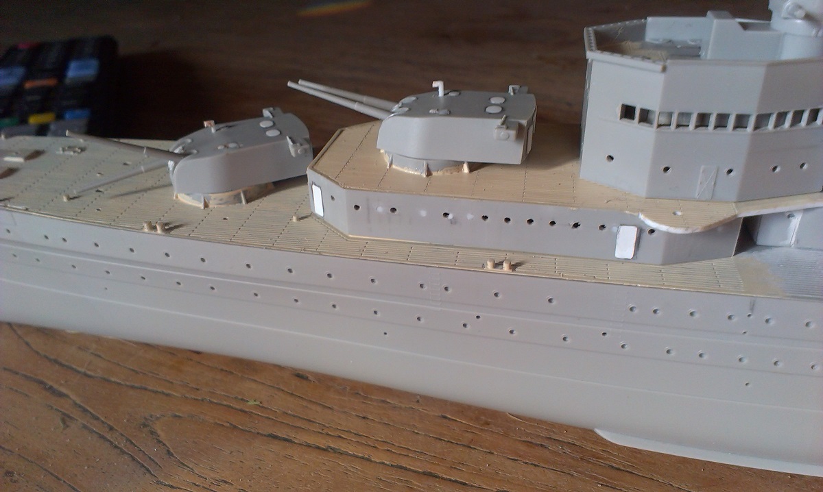

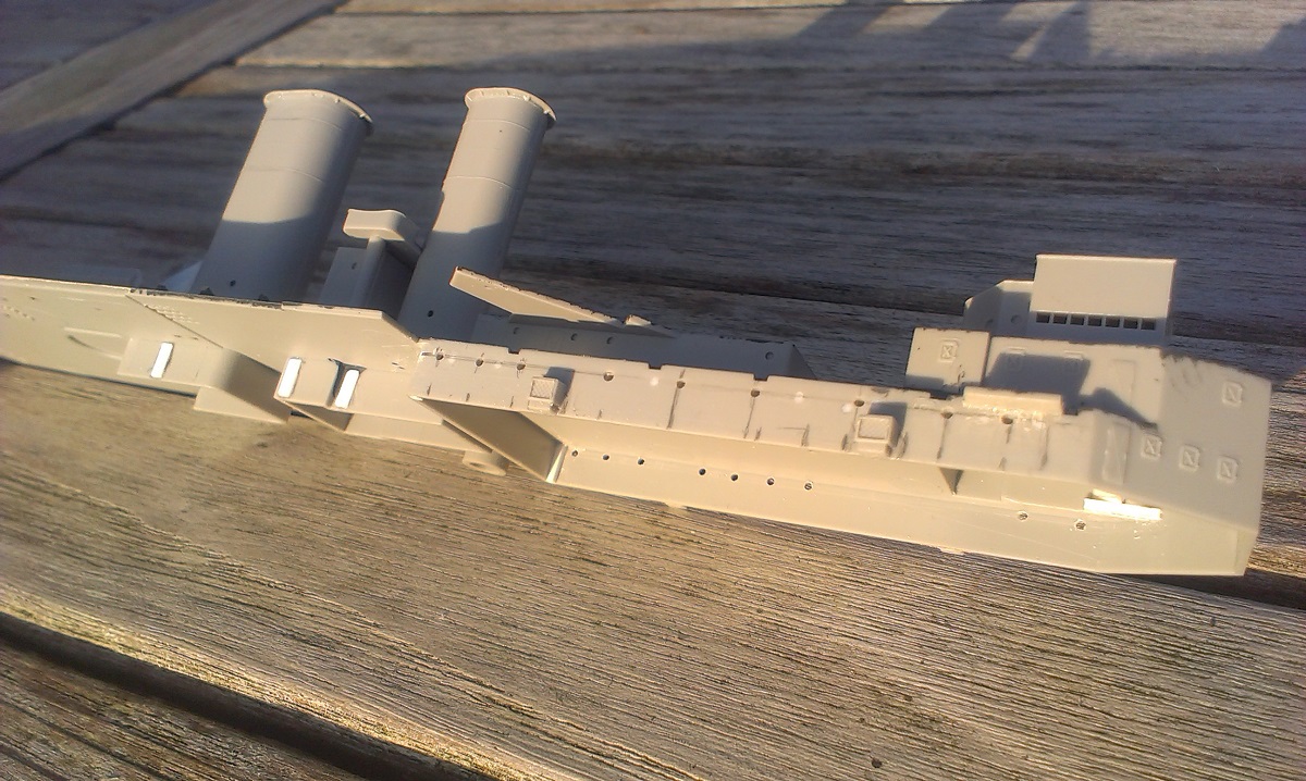

Continuing my attempt to improve the Trumpeter kit, I turned my attention to the forward funnel. It seems that the slant forward trunk is much too bulky, as it has the same width as the main funnel itself.
But as the Exeter was originally intended to have THREE funnels, the forward funnel was trunked into the middle one, as to relieve the bridge from funnel gases.
Therefore, the forward funnel was essentially similar to the rear one, and so should be the trunk.
So I cut off the slant trunk, and scratched a new one from Evergreen tube 8.7mm dia.

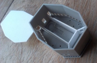

Further to the bridge. The well moulded part from Trumpeter is completely empty, so I made a middle floor. I added walls to suggest the wheelhouse and chartroom inside, so not to look straight across from left to right: it's not a squash court after all!
Apparently, there are two arched doorways to the searchlight platform behind, and a door in the middle, giving entrance to the chart room. The two side galleries seem to have open windows, I don't think these were glazed. Does anyone have an idea about that?

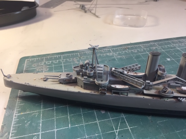

This is the FROG HMS Exeter in 1/500 scale. Built it back in the 60s and found it again at a model show a few years ago. For nostalgias sake I built it straight oob, no PE, rigging etc. A couple of parts were missing (Pom Poms and Walrus).
FROG ("Fly Right Off the Ground" I think) were a British company who made (in my opinion) some very interesting kits for the tine (not just the stamdards). As someone pointed out earlier they cast in 1/500 with Royal Navy ships like Exeter, Revenge, Torquay, Undine. In truth the detail was not great but at the time they were IMHO the best deal in town

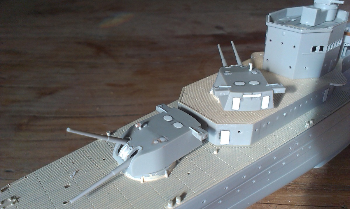

Continuing my set of improvements to the Trumpeter kit:

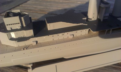

I revised all the doors and portholes in the lower part of the superstructure under the bridge. In fact only one door appeared to be in the correct position, and only one porthole. The rest needs to be filled up (see white spots) and new holes drillled (1 mm). Note the rather different pattern on the left (port) side, as there are the seaman's heads, like on most if not all ships of the Royal Navy. On the starboard side rather less portholes are needed.
The 8 inch turrets seem to be rather good, in shape and dimensions, but lack many details, like the sighting ports, maintenance covers on the top, periscope, and doors at the rear of the turret. I tried to do these details justice. One can also buy a replacement set from Micro Master (Simon Percival) offered through Shapeways, but I didn't want to go that far.

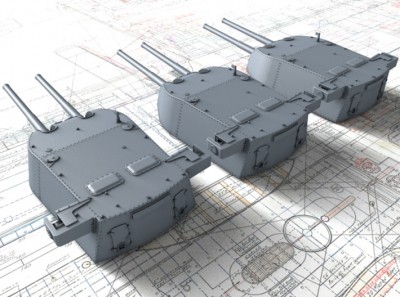

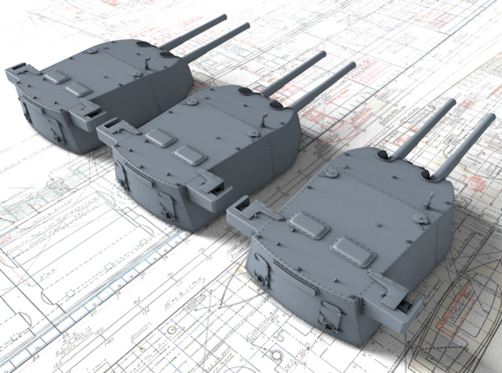

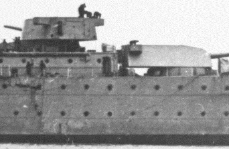

Can somebody share pictures of the rear part of HMS Exeter 8 inch cannon turrets (Mk II typer turrrets)? Can't find any. Looking for the details, i.e. doors, ladders, etc.
Marco
Maarten Sch�nfeld
Posts: 1842
Re: Calling all HMS York class (HMS Exeter-WWII) fans
Post by Maarten Sch�nfeld »
I found no original pictures, but our friend Simon Percival made these renderings from his Shapeways entries of the 8" turrets. I guess he must be close, but I find the two hatches on top of the turret too thick and not quite the right shape.
Roger Whittaker +9/13/2023

Post by Brett Morrow »
Are these images any help?

Brett Morrow wrote:Are these images any help?
In my view certainly, Brett! Thanks :thumbs_up_1:
And the first image confirms another issue I found in the Trumpeter kit: there are twelve reinforcement triangles around each barbette, not eight as Trumpeter made it.
Furthermore, the triangles on the Y turret (quarterdeck) are much smaller than the two forward turrets, so in this case I replaced them all
So back to the workbench, remove four from each barbette and add eight new ones. I'll make a picture when I'm done.

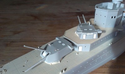

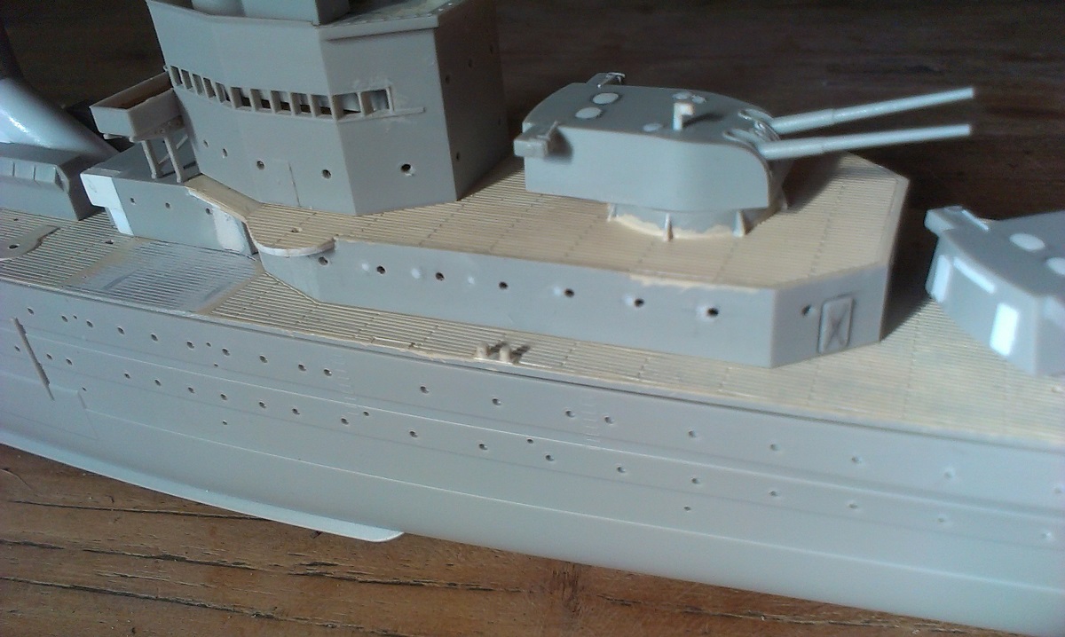

It is very difficult to do the scribing evenly, instead I used Evergreen 2025 V-Groove plate, with grooves at .025" spacing, replacing the deck altogether, except for the rim.
