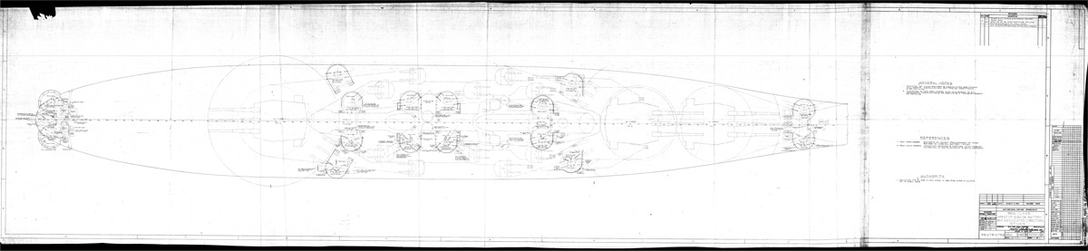

The forum doesn't display .tif files, so I've resaved it as a .jpg here:

I have an August 1943 plan for the New Jersey from the PNY.
The plan shows 41 x 20mm single and 8 x 20mm twin mounts.
The twin mounts are:
The four at the bow (Mounts 1–4) main deck
P/S at FR 146 on the O2 level (Mounts 35–36) (At the aft end of the superstructure)
P/S at FR 161 on the main deck (Mounts 39–40) (The aft most of the pair alongside the #3 Turret)
However, I have never seen a WWII era photograph that clearly showed a Twin 20mm mount on the New Jersey. I have seen them for the first tour in Korea before all the 20mm were removed prior to the second tour.
Does anyone know of a WWII picture showing a twin mount on the New Jersey?
