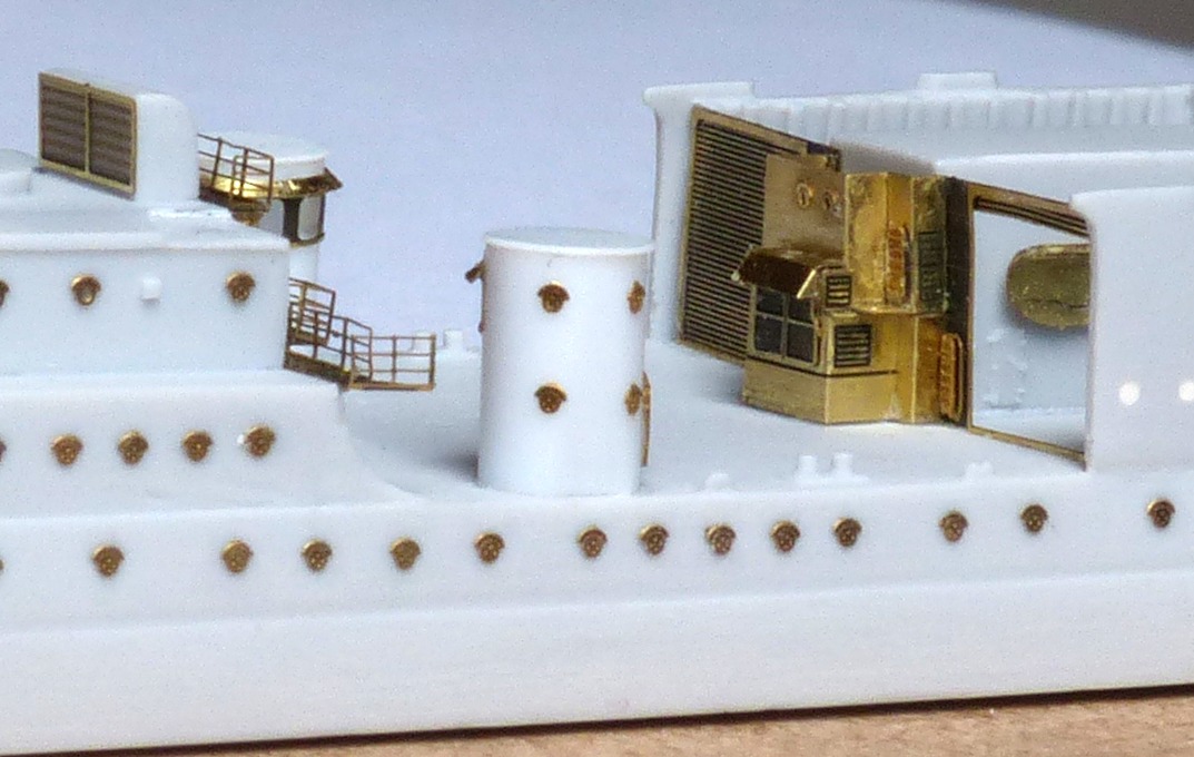

After some testing of my PE parts I came to a conclusion they needed a second attempt. I needed to adjust positions of holes for both tripod masts (it was not a good idea to rely on Profile Morskie plans in this very respect – although I admit they were quite fine in general). I created a simple 3D model for this purpose in the end. I also wanted to add some more details and I had some more findings in the meantime (like about hangar doors discussed in the CASF Northampton class thread).
While waiting for the second version to be etched I worked on adding portholes to the hull and hatches to the deck. I scratchbuilt two large mushroom vents on the stern and used Rainbow brass parts for the smaller ones.

I want to show one of the two hangars open with a SOC-3 with folded wings inside so I built some internal detail and provided for the PE folded wings.
