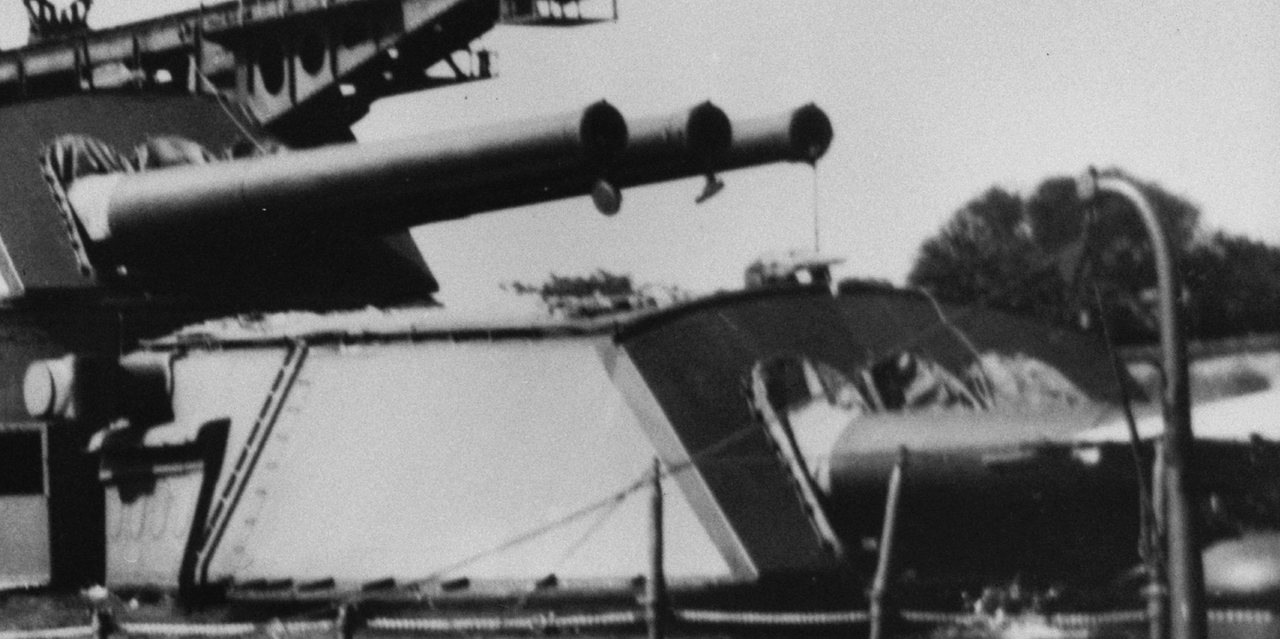

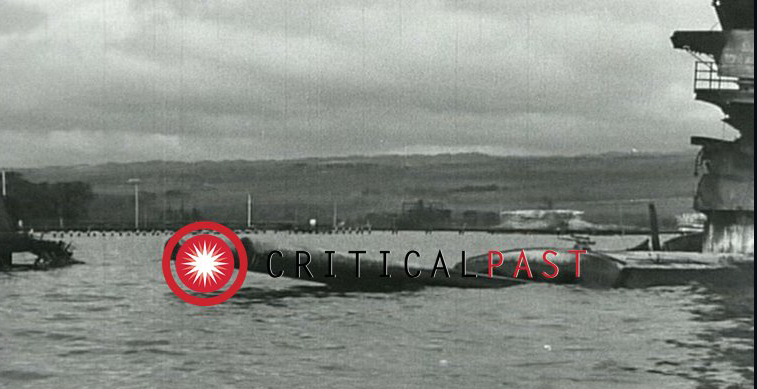

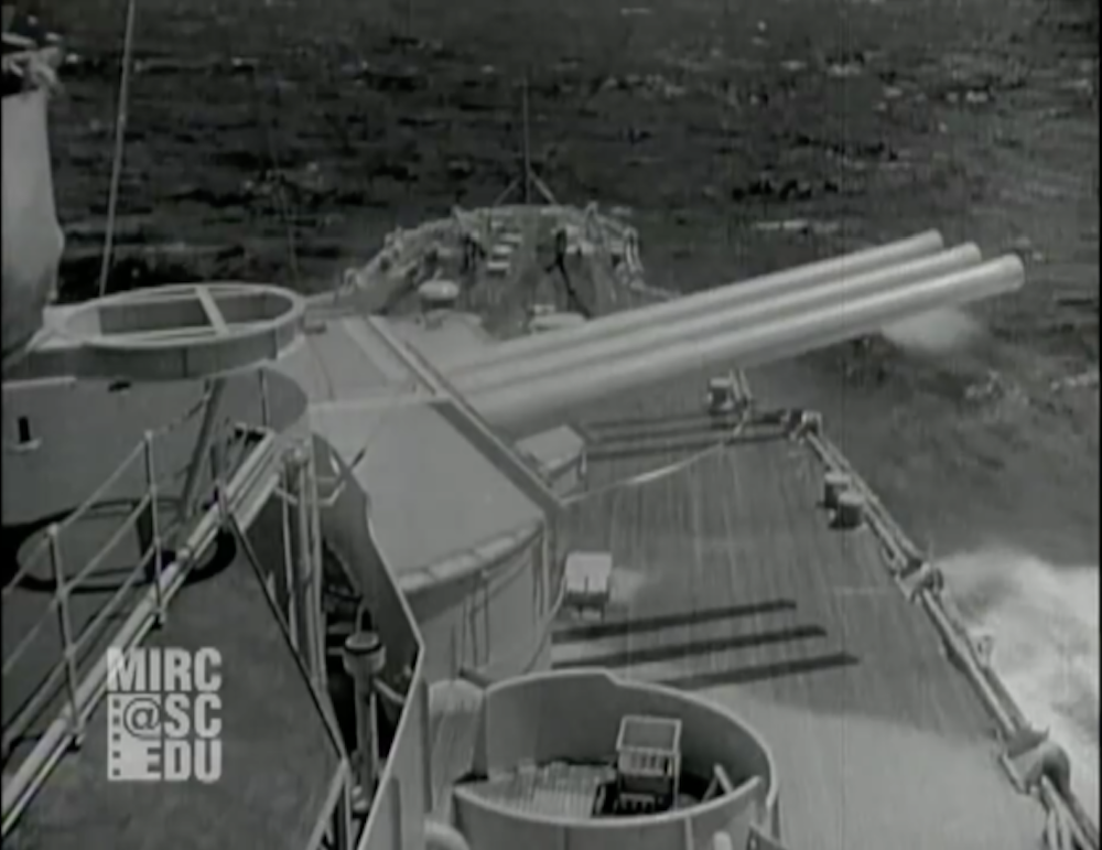

Rick E Davis wrote:
I have to wonder if there still weren't two-three paravanes onboard, they just are being stowed in a different, difficult to see location. The King Board Mods required several rearrangements.
You would have to believe if there was more than 1 paravane, then logically they would have to be stowed somewhere on the forward deck if not on the #2 barbette. There is not a whole lot of places on the forward deck other than the #2 barbette to put them. The April 1st film gives us great views of the forward deck both port and starboard and there is no paravanes to be seen other than the one on the port side #2 barbette. The boat deck was very crowded with splinter shields and 5" guns. Unless they were stowed by the stack, the boat deck doesn't seem a possibility.
Here is a still of her in 1939 with a paravane on either side of Barbette #2.
April 1, 1941, no paravane on the starboard side barbette:
Port side:
I wonder if there was enough room on the front side of barbette #2 to stow a paravane? I don't know what kind of clearance there was behind turret #1.
