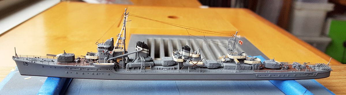

PostPosted: Tue Apr 16, 2019 12:22 pm
Posts: 6865
I have the both the Fujimi "regular" Yukikaze kit and their Yugumo NEXT kits (which is only missing the Kagero class bridge pieces to qualify as a Kagero class kit) and IMHO, the NEXT kit is superior in terms of detail and sharpness. Plus the hull lies flat. I had used the Aoshima hull and a Fujimi regular kit aft deckhouse for a build of Isokaze in late 1944 (gallery to be posted eventually), but that was before the NEXT kit came out. Doing it again, I would definitely use the NEXT late war hull, though that degaussing cable pattern precludes Isokaze.
Now, having said that, the ideal would be to kit-bash the Fujimi regular and NEXT kit parts. Which is pretty much what I'm doing in a very slow, very low priority side build. The NEXT hull and aft deckhouse are clearly superior, the bridge likely so. OTOH, the regular kit funnels and RDF compartment don't have the sink holes that the NEXT kits has, and the funnels are superior. Plus, the regular kit waterline plate fits almost perfectly (see below). If you are going to use styrene masts, then the regular kit parts are better scaled.
It is a bit of a pain to eliminate all the holes in the decking where the NEXT small parts go, but one could actually glue in those next parts and then slice them off at the deck level, before inserting and/or gluing the deck piece into the hull There are plenty of good aftermarket styrene accessories for things like 25mm AA, davits, boats, etc.
As far as PE goes, Fujimi's own set for the NEXT kit looks decent. Five Star also makes a regular and an "easy" full PE set for the Fujimi kit, and these are likely superior to the Fujimi set. (For the life of me, I can't see what the difference between the two Five Star sets are.) The only qualifier for all of these PE sets is that these all use solid splinter shielding around the 25mmAA positions, when in fact they were just canvas covered railings.
