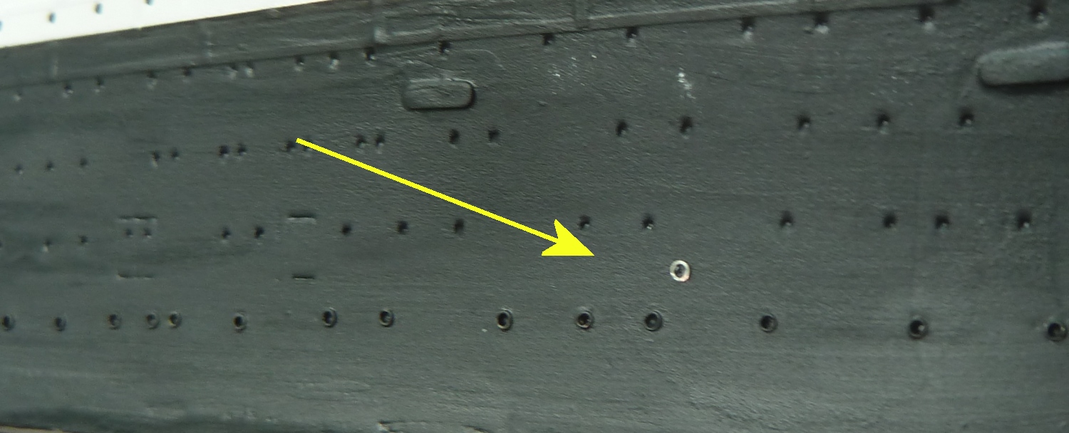

I have been trying out various ideas to 'circumvent ( pun is intended!) ( on the spare practice hull ! _)
the wretched square-cast-should-be-round(!) portholes.... ( a lot of ... arghhh! )
such as ,...
1) spinning a 3B pencil in the aperture --this works REALLY well when the aperture is round...
2) drilling with a larger drill bit ( portholes end up too large ==> looks toy-like ..)
3) using a soft spring-loaded centre punch ( this did reform the resin very nicely and was totally repeatable
but the resulting dish was too large
==> Good for 1/350 though-- and for for future reference .
4) PE portholes--OK but on Normandie the portholes were flush
my findings are further down below
Truthfully-- Giving up was considered, but was a non-option--too much money and effort invested already
and I am not the the giving up-sort !

Using the afore mentioned spring loaded centre punch
the point of which created a shallow divot to make a repeatable and safe centre -
-as opposed to a catchy square edged hole..(!)
--into which I popped a 66Y drill bit
and then inserted my rings -- bedded on matt black paint-- so that they would sit flush
( using a sightly radiused end of tweezers handle ) so as to roll the eyes into the hole to sit dead flush
( the join in the circle sits at the top and will be disguised by the eyebrow above ( where applicable )
==> that's another brain-ache for later next week
the only drawback is that there are many hundreds of them to do...
(maybe I will see you in 2022) :cool_2:
when painted they left a nice sharp round hole
and look a long way superior to the original flawed offering...
brutally enlarged image alas... :whistle:

Have you considered the 'default' technique of filling and redrilling the portholes?

the obvious answer would be a fret( or 6 !) of correct sized ( probably custom made ) PE portholes...
alas that would take even longer to get --- and the clean up of PE porthole snip edges might take almost as long ..? ( :scratch: probably not! )
@ Marijinn...
Lack of foresight and planning ahead on my part alas....(!!!!!!!!) :Oops_1:
I thought I would get away with spinning a penciland paint effects --so wrong!!
... soas I did not want to disturb all the previous windows with dirt and dust...
I made life just that bit harder for myself!! :big_grin:
