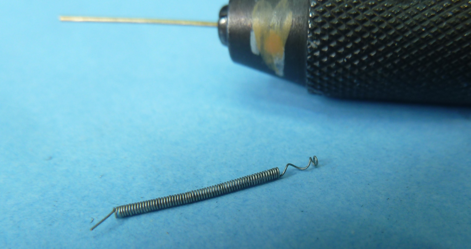

but first I had to make them ............using fine copper tinned wire
I have been asked many time show to do this-- so here is how goes with pictures!
1) select correct size rod/ tube that matches the INSIDE aperture of the porthole and insert into fine jaw pin-chuck
2) cut a short length 4 inches ( 100 mm) or so, insert a kink on the end --this will locate the wire in the pinchuck
3) pull wire gently and apply 1 x turn
4) rest the brass shaft on a finger to apply light pressure to wire and let finger act as an ' inclining' guide and turn the pinchuck slowly but firmly
5) when the end of the wire is reached stop turning and leave a small tail
6) slide off and admire your coil spring!
7) cut single turns off in the same place using a sharp blade on a hard surface
8) The resulting rings are flattened ( sandwich between metal blade on bladeand appl;y light pressure, tweaked to join in a ciurcular

the obvious answer would be a fret( or 6 !) of correct sized ( probably custom made ) PE portholes...
alas that would take even longer to get --- and the clean up of PE porthole snip edges might take almost as long ..? ( :scratch: probably not! )
@ Marijinn...
Lack of foresight and planning ahead on my part alas....(!!!!!!!!) :Oops_1:
I thought I would get away with spinning a penciland paint effects --so wrong!!
... soas I did not want to disturb all the previous windows with dirt and dust...
I made life just that bit harder for myself!! :big_grin:
@ Strategos Augustus
I have bought a LOT of different nail tapes ( they are so cheap!!!) but some of them are stickier than others.
The really thin and narrow tape I used for the rivet strips ...the moment I had applied mine ...I sealed the ends on with matt varnish brushed )
and then sealed them on with paint and varnish
