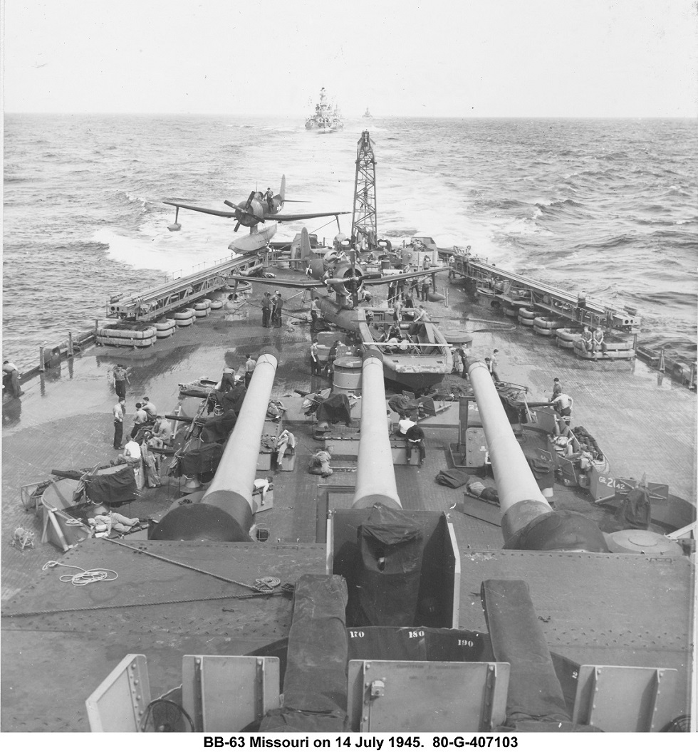

Here is MISSOURI 14 July 1945 and this shows the boat in question:

Posts: 3374
BB62vet wrote:
Chuck/Jim:
Thanks.
A couple of interesting thing I noted in the photo:
1. The boat in the July 1945 photo is definitely not the same as the one in August 1944 photo. The July 1945 photo definitely shows a 33 foot re-arming boat because the torpedo cradle inside the boat is visible, and the front of the boat terminates in a blunt cut off. The boat in August 1944 has a sharp bow. I think it is a 35 foot rearming boat because it has flat sheer, and bumper all around. See But the canvas cover (which interestingly is clearly not watertight as it leaves gaps where it is laced to the side of the boat) obscures the inside so I can’t be 100% sure. See https://maritime.org/doc/boatcat/index.htm#toc for drawings of both types of boats, and photo of torpedo being loaded into the boat https://www.gettyimages.com/detail/news-photo/torpedo-being-lowered-into-plane-rearming-boat-news-photo/615313652
2. The inner face of the splinter shield around the 20mm Oerlikons are repainted in a light color, possibly haze gray, in July 1945. In August 1944 the insides of all vertical splinter shields and bulwarks were a dark,color, possibly deck blue.
