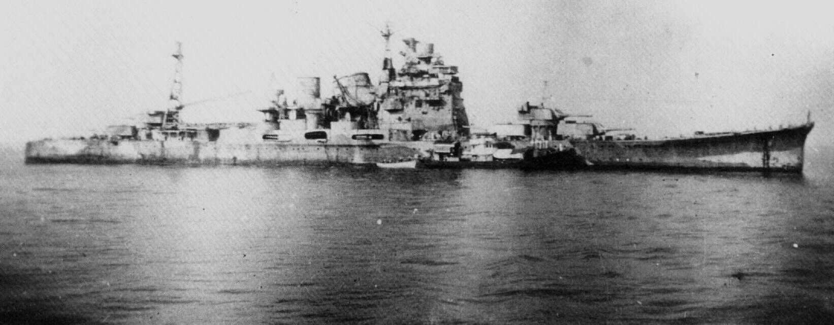

the photo of Maya, Tawi tawi,may 1944
I´m afraid the photo was taken against the sun,and it is hard to see existence of the degaussing cable, but camouflage patterns are seen all over at the hull and on the surcface of the upper structrures. Chokai had the same. :)d
cheers,

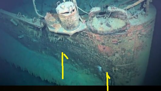

About visual proofs of the degaussing cable Chokai has this here, in some R/V Petrel photos.
A logical thinking may be needed ,if one claims sistership Maya didn´t have the cable at the time of the last battle of the Rengo Kantai.
cheers,

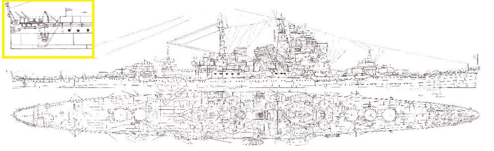

By looking into the R/V Petrel´s photos in the above I took a time in re-arranging the cable of Chokai around the stern, 1944 and on the drawing as a side task to do, so the cable here runs below the place of the ship name plate.
cheers,
