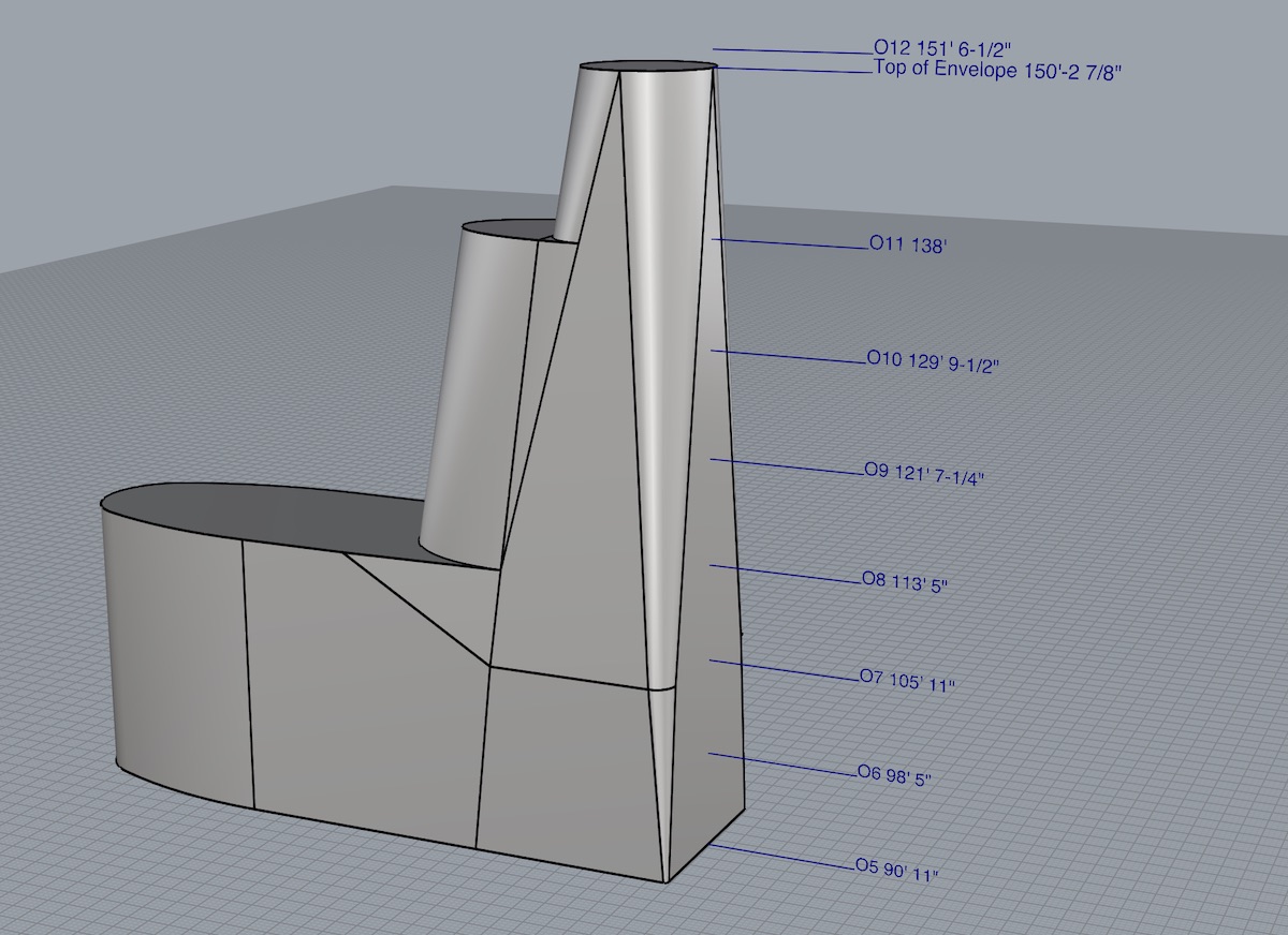

On another typic, I noticed a new kit error on the 08 (secondary conn) on the Tamiya kit. It is not symmetrical. The shape of the deck as ot goes around the fire control tower is correct for the the right side but not the left. It extends farther aft on the left side than on the right. This is because of the ladder on the right side that is not on the left.
While I am at it, here is illustration of another common defect I have seen in kit (including above). The sides of the director tower start to taper in at the 07 level. The forward part of the 08 level weather deck (where the stack is) cuts in to meet the sloped in tower side. That creates the triangular panel in the side of the structure. This is visible in photographs.
Kits ignore this and start the taper at the 08 level.
