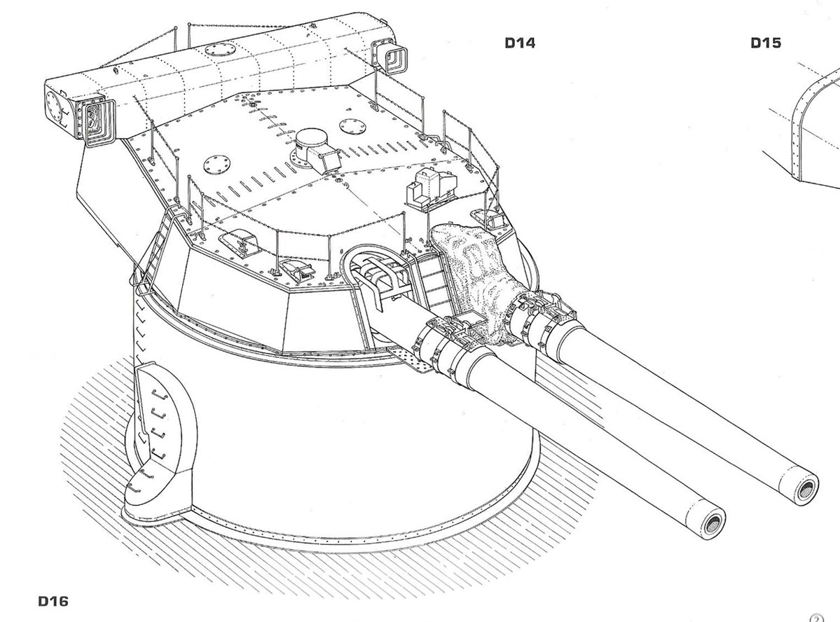

- blastbags : were the small structures/platforms with series of holes just under the main guns visible ? or fully hidden under blastbag (just visible if blastbags removed) ?
Those perforated platforms appear to be the anchoring base for the blast bags. I think this illustration from the AOTS book makes it clear.
If you are talking about the platforms to the R/L of the barrels, near the front of where the Blast-bags attach....
Those are platforms that were used when mounting (and using) the 3" practice guns on the larger 12" to 14" barrels.
You can see the smaller 3" "Practice Gun" mounted in the bracket above the barrel, which is empty on the PE set.
I think that some PE manufacturers sell either resin or brass practice guns that can be mounted in the brackets, if needed.

nope. It is the small vertical/horizontal platforms at juction of gun and turret
I indeed see them when there is no blast bag, and never visible when blastbags are fitted (as on your picture).
but what is strange is that PE and model engineers often create those pieces WITH blastbags fitted also...
like 1/350 fujimi's FUSO...
A bit confusing sometimes.
