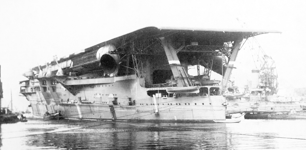

I got the IJN Carrier bug this fall and tonight I broke out the Kaga Triple Deck. I'm seriously considering scratch-building the flight deck, and I have some questions in that regard.
Does anyone have any info on the girder-structure of the flight deck aft as originally constructed? Unlike other IJN CA's there isn't a PE flight deck option for this. The Fujimi Kaga 3 Deck Kit has a rather blank underside to the back end of the Flight Deck. I've found that looking at various kits and models of the Kaga in her final form is both illuminating and confusing. The various aftermarket and kit manufacturers seem to be interpreting this area differently. Any help from the wonderful experts here would be very greatly appreciated. :thumbs_up_1:
Also, it appears from the famous Starboard quarter view of the Kaga fitting out that there is quite a bit of girder extending along the edges of the flight deck forward, extending behind the horizontal funnels. Does anyone have any information on the structure of the ship in this area?

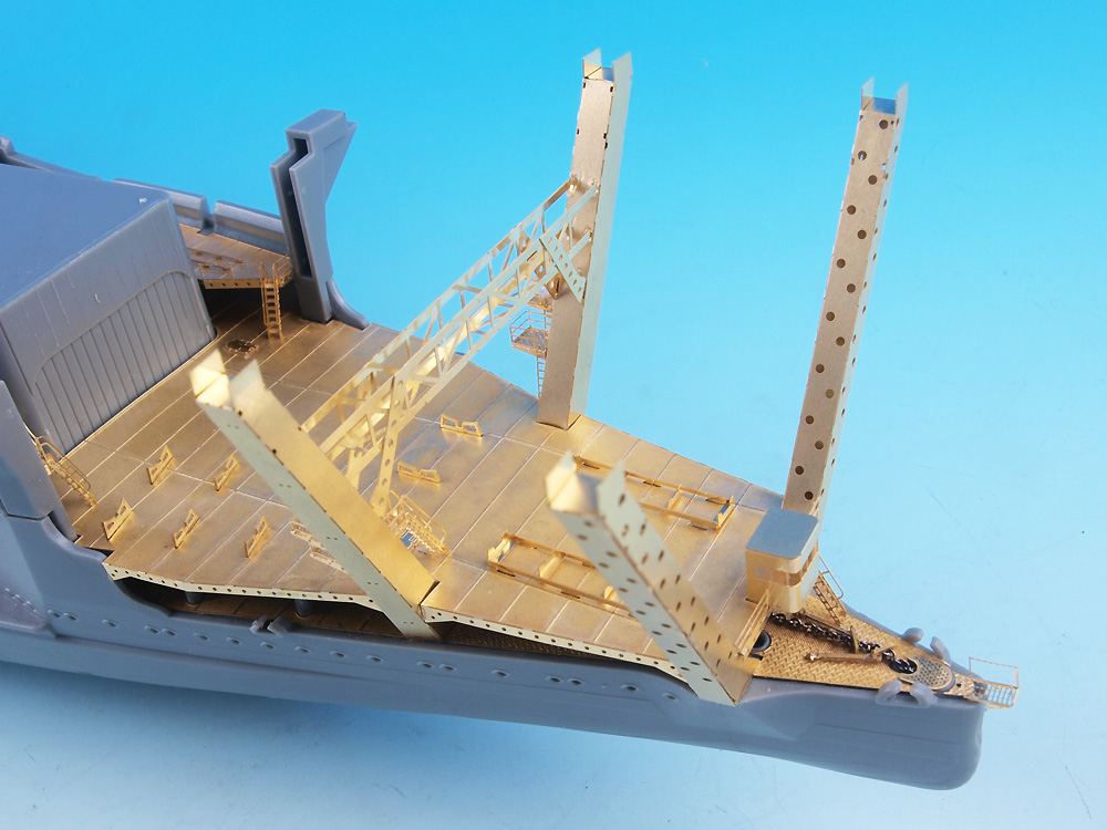

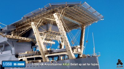

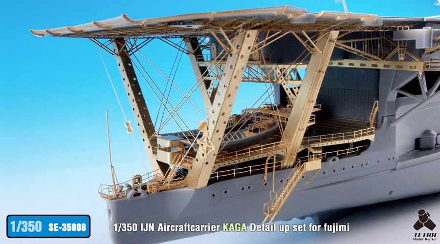

So, there are no readily available plans or drawings. However, do not let the photos of the Kaga construction deter you, as much of what you see is just additional scaffolding.
My best advice is to follow the Tetra set for the modernized 1/350 fit. Her stern was lengthened, and the flight deck lengthened with an additional set of column supports aft, but the portion of the ship under the flight deck from the third elevator back to the original aftmost girders was mostly unchanged. The most obvious change has to do with the original support columns to either side of the aft end of the elevator. They were original built as open latticeworks, and enclosed after the refit.
I think if you follow the pics below, you'll get my drift.

There are several suppliers that offer 1/700 IJN perforated bar, but the structures under the lowest deck look more like trestles to me.
