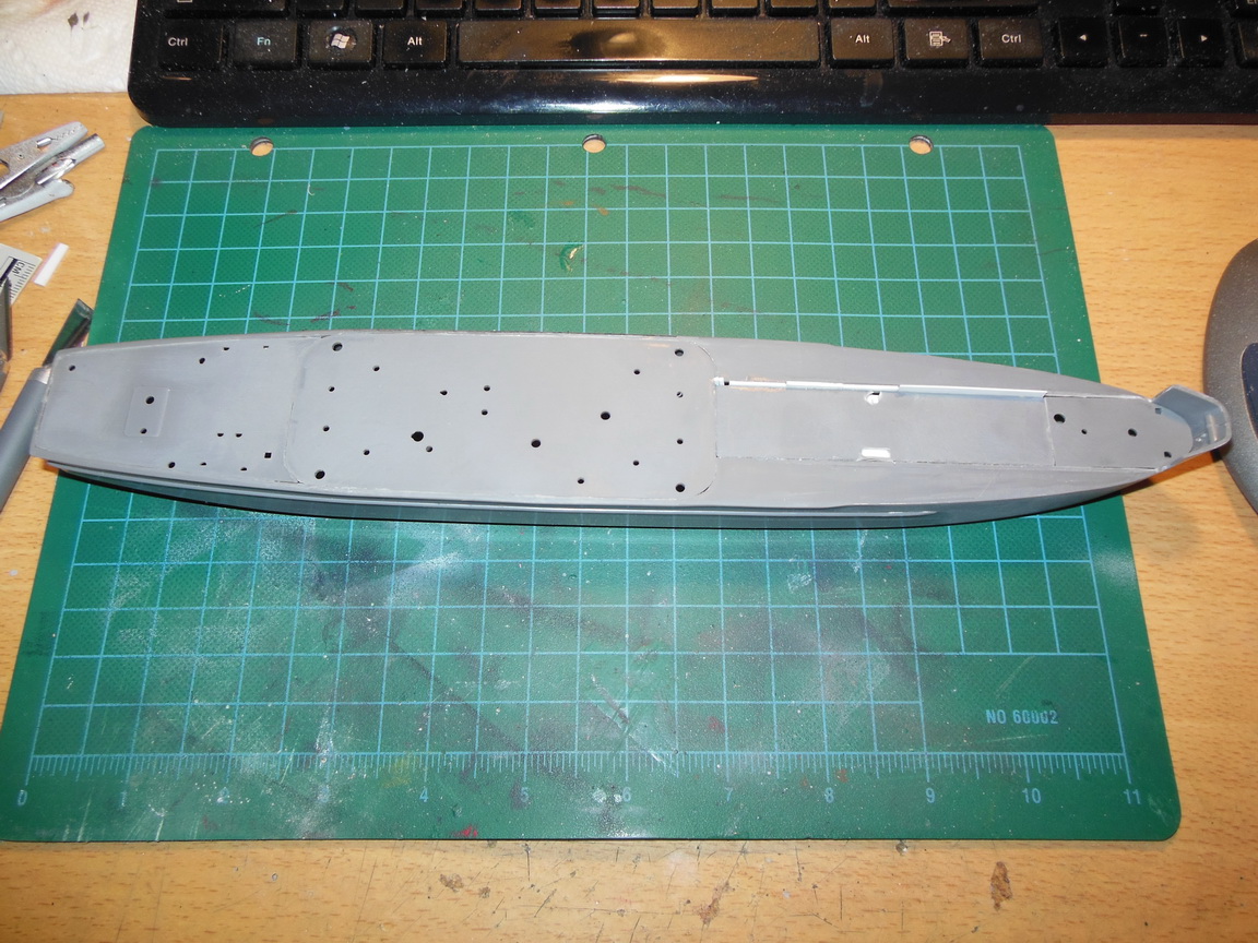

The line art I had of the LCSL design figured out to about 1/130th scale on my computer so I was able to convert the measurements to 1/160th scale pretty easily. I started by cutting away those sections of the deckhouse sides and bow that were a part of the main hull halves. Using the deck house roof to fill the gap in the deck, I then cut a new deck of .020 styrene. I sanded the ramp extensions from the hull halves and cut the forward splinter shields from the main deck and moved them outboard to the deck edge. I knew the armament mounted on the -24 so I looked up on Shapeways and picked up a 3"-50 cal deck gun, two twin 40mm guns and a set of 20mm guns. Other fittings from shapeways included the anchor on the fantail, the winch, the Ship's Wherry and the lifeboats, Mk.51 gun directors and Rocket Launchers. At the time, no one made Mk.7 Rocket launchers so I had to settle for Mk.20 launchers. Not the best solution but all I could get at the time. I've recently found someone who produces them and have them on order. PE rails and ladders were added where needed.

The hull with the decks, deck house roof and fordeck installed as a base for the styrene deck to come...
