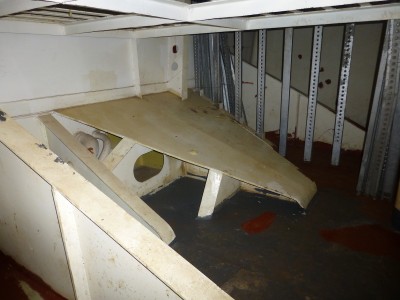

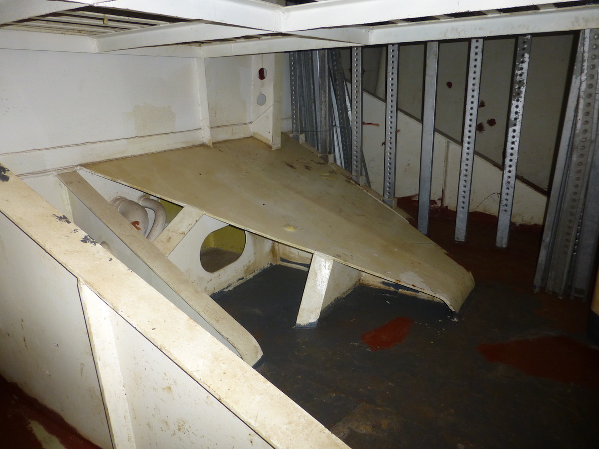

I could not find a picture of this detail so I made one. This is the transition from double bottom to triple bottom. The triangular sheet is the rider plate on the keel.
