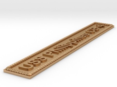

In other news, nameplates for many Cannon class destroyer escorts, including USS Slater DE-766, USS Cannon DE-99, all six Free French DEs, three post-war French Navy DEs, one Dutch DE, three Italian DEs, two Taiwanese DEs, two Brazilian DEs, all Gangut class battleships, all Danton class battleships, and a nameplate for China's aircraft carrier Liaoning have been added to the catalog.* See also "The History of The American Sailing Navy: The Ships and Their Development" by Howard I. Chapelle, pg. 516
