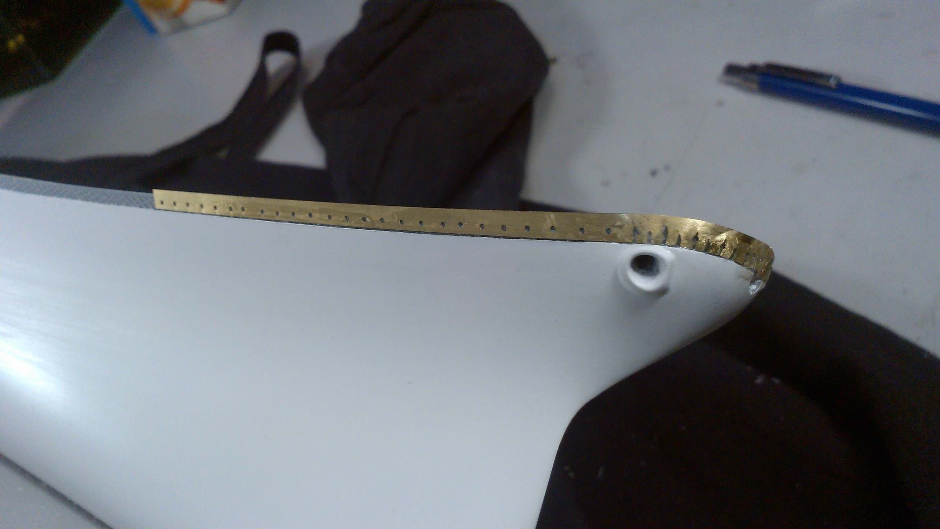

On my model in 350 scale, I tried to make a waterweiss..
PostPosted: Tue May 19, 2020 1:00 pm
Joined: Sun Feb 26, 2012 12:34 pm
Posts: 55
Location: SIBERIA,NOVOSIBIRSK
A strip of brass is glued on the cyacrin...

Many thanks to everyone! Guys, your knowledge is very helpful in work!
