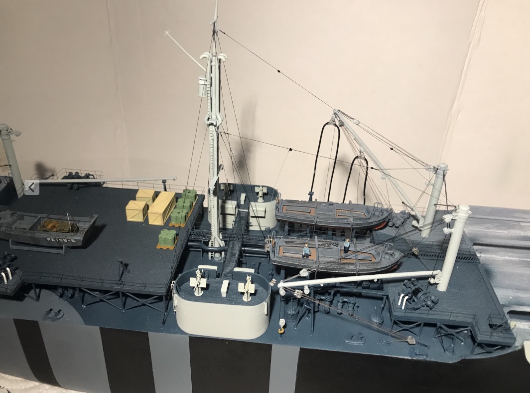

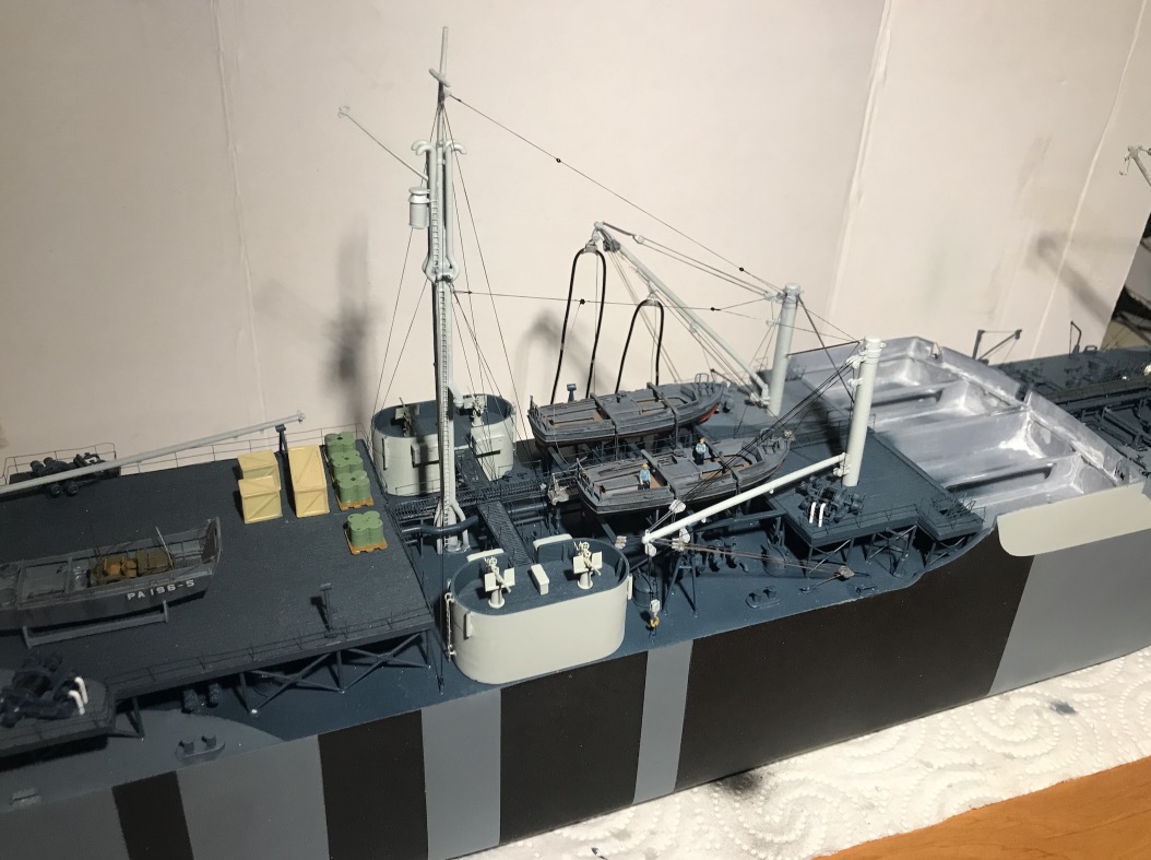

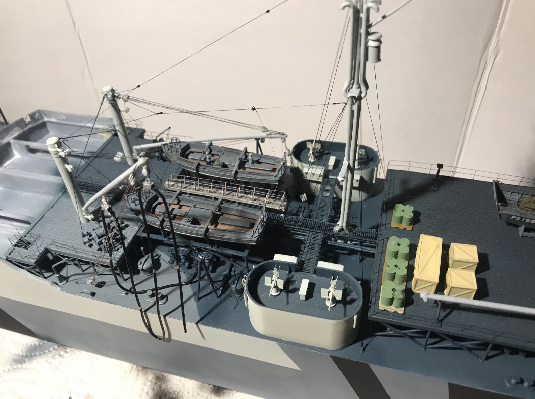

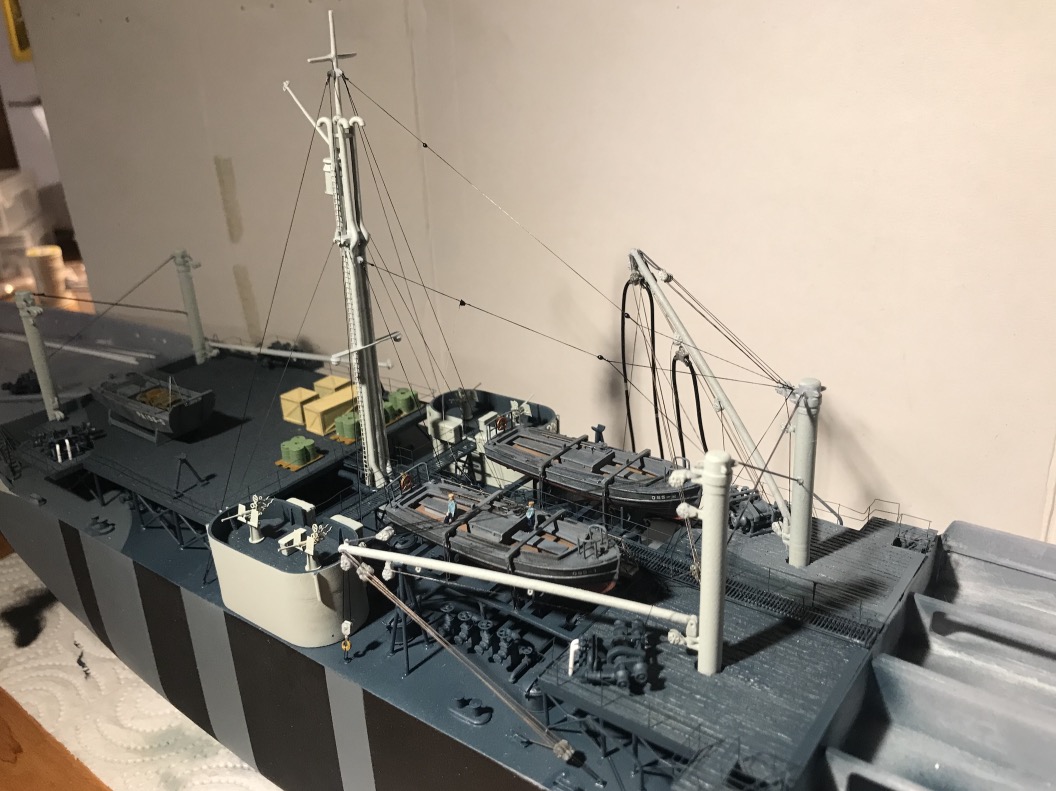

I just spent 2 days on this part of the ship to almost finish it, I'm missing stairs coming from the Arsenal 2.0 (White Ensign), I know it doesn't show much...
The rigging is always a part... of pleasure. You have to take your time and start again if it's not at the level of what you want. I used the stretched plastic method for a rigging, it was a first, it works well, and I have the expected effect of bending with the wind. To be renewed.

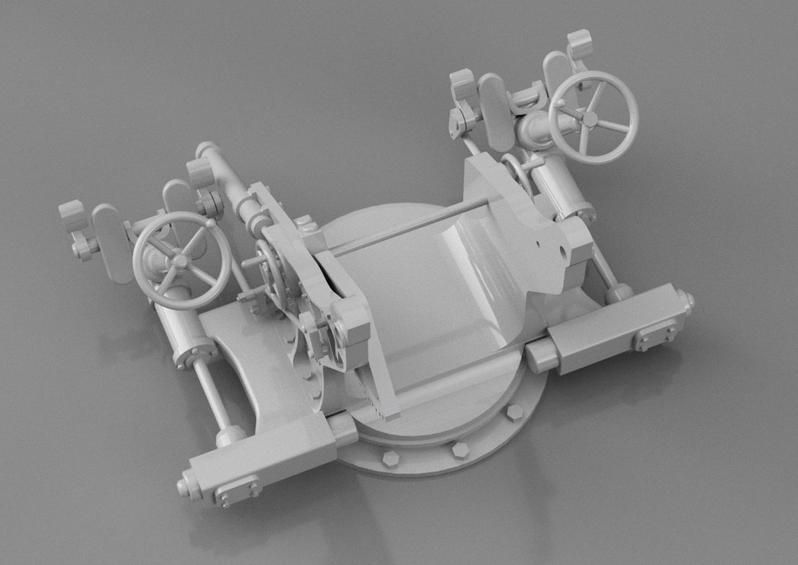

I also started the design of a very French 13.2 mm quadruple anti-aircraft gun (Affuts Hotchkiss) at 1/72 which will be found on Japanese IJN ships as well... It's for a friend, I wouldn't have the use of it for the moment.
In terrestrial too:

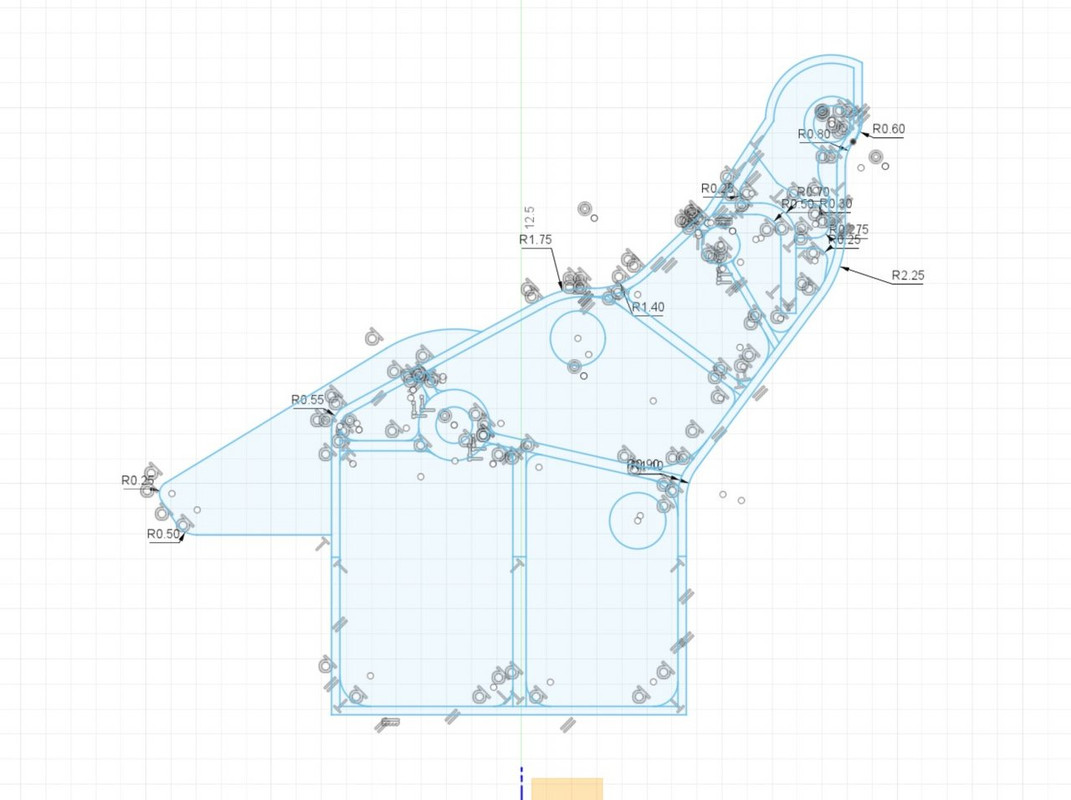

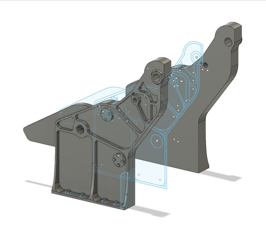

A small point tonight on this drawing. I've made good progress, although I'm missing some visual information about the base, so I have to improvise, but I can't be far away, moreover, there are a lot of models a little bit different... Once you understand the mechanisms that animate the whole thing, it's already easier.
Pascal

When I first glimpsed the photo of the quad before reading I was surprised! Nice progress for a friend!
About the oil hoses, they are draping quite nicely, how are those constructed?

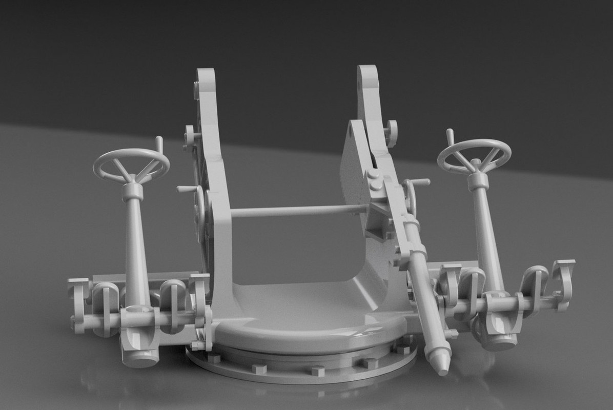

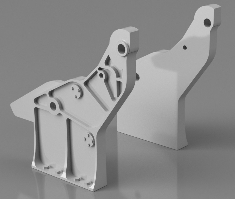

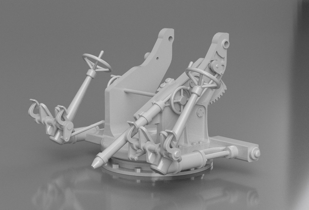

That's it, this cannon is finished.
Just have to make a test print at 1/72,  then at 1/48 for me. It will join my collection at 1/48.
I still have a 5 inches to make for my T2 tanker, a gun also quite complicated... I'll have to simplify it.
13.2 mm quad mount / Hotchkiss machine guns:
Transparent background.
On the salt lake!   :big_grin:
Pascal
