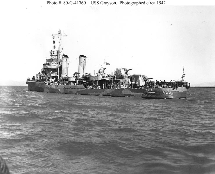

The problem with many of the Ms 12R(mod) camo units is finding views of both sides of the ship (and for that matter bow and stern views). I don't know of any "good" portside views of USS GWIN (DD-433), the only images I have is this aerial view taken at PHNY in July 1942 and an aerial view taken at sea in July 1942 of three of the sisters operating together (which are which isn't clear from this distant shot), after they were updated with the nine 20-mm mod. The camo patterns for any of them shouldn't have changed, in any major way.
The only things I would suggest is to "wing" it. Normally, I suggest doing a mirror image on the opposite side when there are NO images available to guide a person. Maybe playing with the posted image of the two at anchor above can pull out more of the pattern. I call this "style" of Ms 12R(mod) patterns that were common on destroyers painted at BosNY after the "jigsaw pattern" period applied in December 1941, "long wave". That IS NOT an official name for this pattern, but the pattern has the long dark pattern, normally sweeping up towards the deck. The photo of the three sisters, show that the patterns are not exactly the same, but basically follow the same "style". I figured that each yard had an artist hired as a yard worker whose only skill was marking out these patterns and this was the one he liked. :big_grin: Another "trick" is to look at other destroyers painted at the same location, at about the same timeframe.
An example; here are two images (second image has her radars censored) of USS GRAYSON (DD-435) after her nine 20-mm mod at MINY and an image of USS KEARNY (DD-432) ay BosNY after her repairs and upgrading. You can see that the patterns aren't exactingly the same, but that they are of the same "style" and pretty close to being the same.
I don't have image 80-G-374882, but if it is of USS GWIN (DD-433) and the place and date are right, she had painted out of Ms 12R(mod) several months (February 1943) before then to Ms 21.

Those two bottom pics of the Greyson and Kearny are wonderful very clear and very close to what the Gwin wore...

And the Greyson DD-435 port stern quarter.....
That adds to the info needed to recreate it as much as possible.....
Thank you very much, I think both the Kearney's and Greyson's scheme is very close to the Gwin's scheme, not exact but very very close.... Except for the stern wrap....

That's another wonderful pic Rick....
Like I said, the whole thread is a lot to digest, I probably read your previous, but it got buried in the rest of the info assimilated... I should probably read it again....
So it's possible that the Gwin and Meredith never received the GCS radar before they were lost.. not really important though if they had later, I'm building Gwin to April '42 so she didn't have it.... Two other things about that pic, it clearly shows the starboard side camo pattern even on the superstructure, and at the stern it shows that the stern was a horizontal wraparound like the Kearney's, (5-O at the deck line, 5-S or N in the middle and 5-O at the waterline rather than the upper/lower split on the Grayson's stern) That finalizes the approach to simulating her port quarter paint scheme......
The Gwin's and Kearney's paint schemes were almost identical....
But it does raise one more question.... the hardest one of all.... 5-S or 5-N? I know the scheme was originally laid down in 5-S, but was it 5-S when they sailed with TF-18? I know the Hornet was as was the Cruisers Nashville and Vincennes and the oiler Cimarron, were the Destroyers still in 5-S?
I know two of them were repainted just before they left Norfolk.....
So yes I'm using the Livermore which is already in my stash, (looks to be a beautiful kit) the Infini parts are on the way, the Kracken parts are on order and paid for (but I haven't received any acknowledgement of it yet) and I still have to get the GMM photoetch set on the way....
So I've moved this one to "on the ways" status in my schedule.... only thing left is to decide the blue color, 5-S or 5-N, I have plenty of 5-S from True North Paints but would need to order some 5-N if that is what she was in.... I could just go with the 5-S in hand so at least they all look the same but I would rather them be accurate...
And Rick, I cannot tell you how much your help has meant to figuring this out.... I would still be working on the gun configuration without your help....
Thank you..
EG

The darkest color on the Ms 12R(mod) patterns on ALL the early and repeat BENSON-GLEAVES class units would have been 5-N. The Atlantic fleet replaced the 5-S with 5-N before they started applying the "splotchy" pattern Ms 12R(mod) .... http://www.researcheratlarge.com/Ships/ ... CL-41.html .... in early November 1941. The first "Ms 12R(mod) splotchy camo" painted destroyers began appearing in late November into December 1941, with the "jigsaw" pattern at BosNY. This pattern was NOT acceptable (to Adm King?) and was replaced by "most yards" (but not all), USN and private builders, with patterns with larger "splotches". Some of the early BENSON-GLEAVES class units in DesRon 7 carried the jigsaw pattern into as late as May 1942. There appears to have been a different style of Ms 12R(mod) applied by many yards, although the BosNY style does seem to be the most common prior to the switch to Ms 22.

Ok Rick, I can buy that.....
Some ships from Norfolk were painted in Ms. 2 Sea Blue as Adm. King was issuing his directive to substitute Navy Blue as supplies and availability allowed..... at the same time the BOS was issuing orders for painting that specified Sea Blue..... Which included Ms 12 Mod.... A month or two afterwards the BOS issued a clarification letter of it's orders that Adm King preferred Ms. 12 in Navy Blue and Admiral Kimmel preferred Ms. 11 in Sea Blue.....
There was a LOT of confusion going on back then, Atlantic Fleet was on a wartime footing and Pacific Fleet was not, Orders were communicated on the eastern seaboard within days and on the west coast in weeks, (sometimes months) After the attack on Pearl, and Adm. Stark was moved out to be Roosevelt's naval aide and Admiral King took over as Cominch, (he held both Cominch and Cinclant posts during the war) and he sent Nimitz out west to be Cincpac, things improved quite a bit.... He kinda cut through all the red tape.....
This is why within a week of BOS's orders on paint Admiral King had his preferences into BOS within two days and with Kimmel it was almost two months and then it still took another three weeks for BOS to issue it's revised orders...
I've always understood that the Hornet, Vincennes and Nashville were in Ms. 12m Sea Blue, Norfolk type pattern, (I call it tiger stripe pattern) and one thing that was an issue is they didn't repaint large capital ships that often as it took a while where a destroyer could be repainted in a day. (my nickname for the BosNY pattern is smoke on the water) and I know two of the destroyers were repainted just before they left in march.... (1 or 2 days in fact)
Well given the issues and the orders in hand, I'll shift over to Navy Blue rather than Sea Blue for TF-18, although I'm still not quite convinced/sure..... I haven't studied the paint schemes of the atlantic fleet as much as I have the pacific I suppose....
Now I have two bottles of Late 42 5-N Navy Blue coming from True North..... I would rather have them look the same cause that is how they appear in photos.... Now I still have to find the GMM PE for this kit, I wish Loren Perry had an online shopping cart....
Anyway thanks for all the help, it might be a while yet but when I get everything together and started I will post a log showing progress...
EG

By March 1942, all destroyers in the NORTH Atlantic were using 5-N and not 5-S. It was an easy matter to convert a "pre-mixed" batch of 5-S into 5-N by adding tint. How then someone will come up with an exception .... As for USS VINCENNES and NASHVILLE, it would be dependent on WHEN they were first painted in Ms 12R(mod) and if their CO liked it or rather saw no need to bother repainting. From the images of VINCENNES and NASHVILLE I have scanned, they look to be painted using 5-N while in the Pacific. 5-S tased out of use pretty fast.
The South Atlantic (and maybe Canal Zone) destroyers were a different matter. USS WINSLOW was "reportedly" painted in solid 5-S in December 1941 and after seeing Mountbatten Pink, painted into that!!!!
In the images of USS VINCENNES below, note that the darkest hull side color is a close match to the deck color.

Well they were under orders after Pearl to paint in 5-N with no ambiguity after 12/16/41 that was one of the first orders issued..... (I'm sure Adm. King was a huge influence there) They no longer had time to ponder the issue...
Given the pics your offering up I probably figured wrong on the color and yes it was easy to convert Sea to Navy just add 5 more pints of tinting paste to mixed 5-S.....
I know there was an issue of ships coming from the Atlantic fleet to the Pacific Fleet and being in Sea Blue, especially if they were new construction.... but that was quickly resolved....
Thank you my friend for the answers, now I know....
5-N Navy blue it is..... It would have to be for the Hornet as well she was built in Prewar Standard Grey and was put into Ms. 12m on her second to last availability just prior to shipping out to the pacific. That means she had to be Navy Blue base color as well...
Thanks again....
