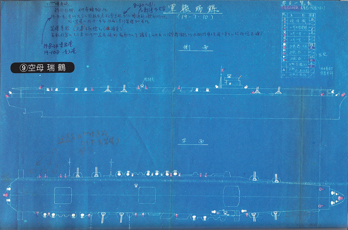

I have a book of the AA schematics of all major remaining IJN vessels in the summer of 1944 drawn by then Lt. Constructor Shizuo Fukui. Zuikaku's 25mm emplacements, including singles, are part of the volume. My home scanner isn't working at the moment, so I will try to scan it elsewhere.

Ok, this schematic shows all of Zuikaku's 25mm AA positions as of mid-July, 1944 at Kure. The mounts in red are the newest additions. This does not account for additional single 25mm AA mounts that may have been added between then and early October.

Thanks a lot for the scan, Dan. There are even more triple installations than Morskie described in the technical data, I count 20. It would mean I have to make 4 bases out of scratch and I don't know if I have the extra barrels at hand. Right now I have 15 almost ready, now I arrived to the step where the splinter shields have to be added. We know at least the bow installations had them from that video still that was posted earlier, so I'm going to add these to all.
Posts: 9112
Re: IJN Zuikaku 1/350
Post by Dan K »
Keep in mind that 16 of the triple 25mm triple are of the regular configuration, while the four on the aft, starboard quarter are in enclosed shields.

That's right, I forgot about those. But Fujimi only provides 2 enclosed triple 25mm guns, did you count the DP guns in those 4?
Though these turrets seem easier to scratch than the Infini gun mounts...

You are correct about there being only two shielded 25mm AA mounts. My mistake.
