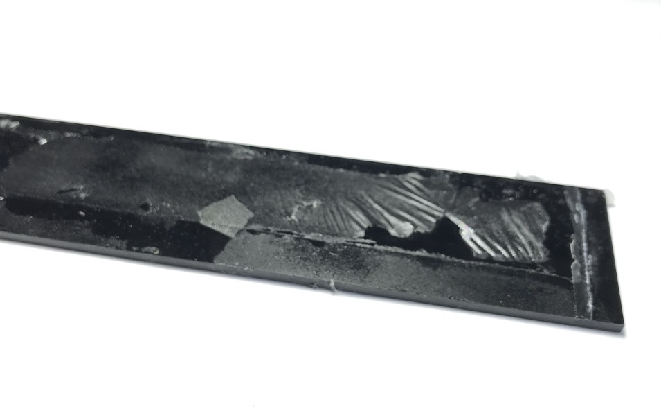

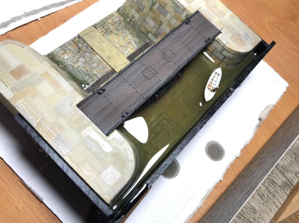

The demoulding went almost well. I had a problem with the release agent, which must have reacted with the resin when I poured it. I shouldn't have used anything, the mould plates were so smooth that it wouldn't have stuck. Experience is the sum of our mistakes.
I was still confident because I had more than 0.5 mm to sand down to a smooth and transparent surface.
I was confident to recover the damage because I had seen this video a while ago, the guy was going a long way with his resin cut and re-polished.
https://youtu.be/2VwbqkB_7Aw
I started with 240, 800 and 1000 paper, I don't have a 3000 at the moment, so I used a Belgom Alu polishing paste, then a polish. It's coming out quite well.
I still have to apply the wavelets.

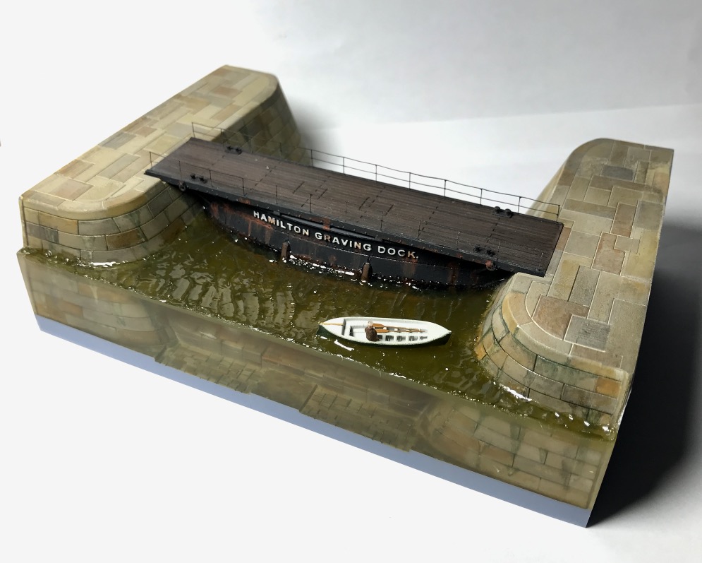

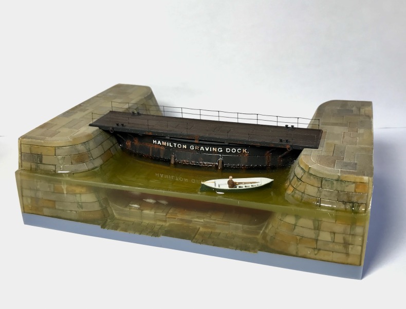

That's it for this corner, a few touch-ups with clear matte varnish to do.
Pascal
