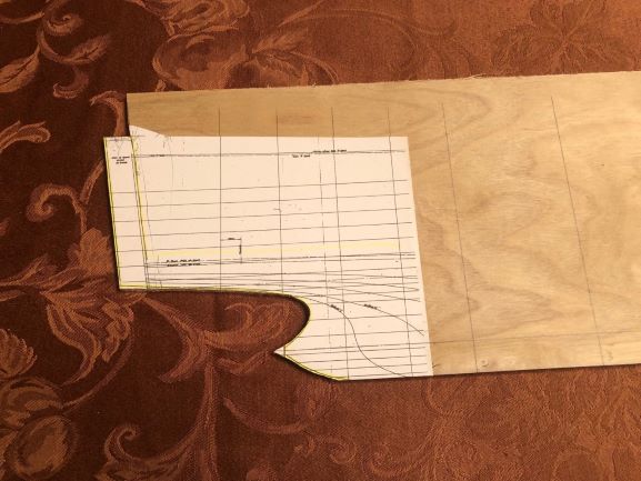

For the keel I used the profile on the Sheer Plan portion of the Lines Plan (after first comparing it with my GA plan to make sure that both absolutely agree.) I also reduced the dimensions of the keel shape to account for the thickness of planking and coating. The keel will be ¾ inch deep, except for an aft portion which is slightly smaller to provide clearance for the stuffing tube.
The majority of the keel is a straight run and could be drawn directly onto the ¼ inch plywood. I also marked the frame stations on the plywood before cutting. The bow and stern portions of the modified keel plan were copied onto heavy paper and glued at the proper place on the plywood, resulting in a single-piece keel.
File comment: Plywood marked for keel and initial cuts made

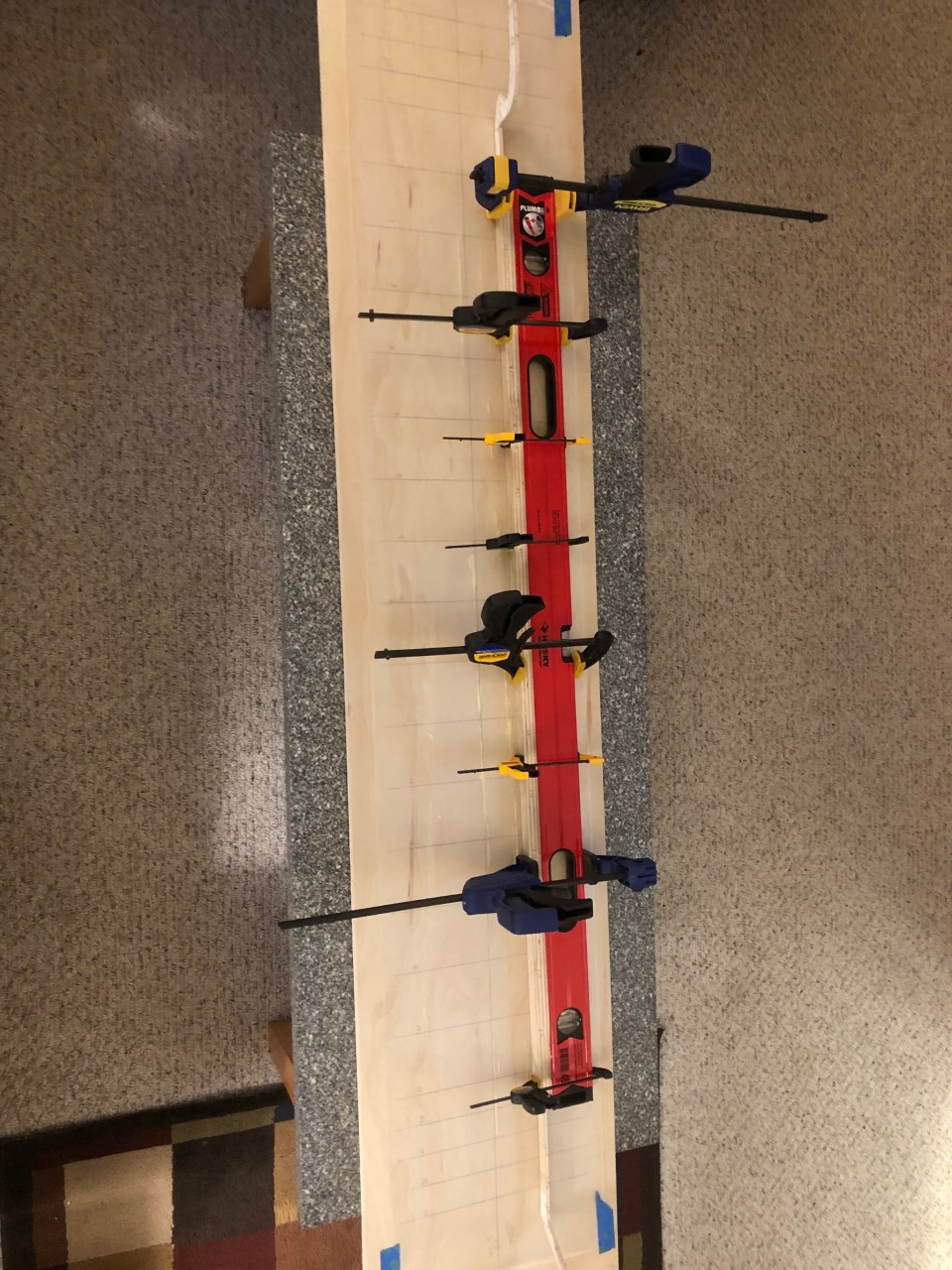

I then mounted the keel to the building board. As described earlier, the board had been marked with a keel line and the frame stations. As hoped, this turned out to be very helpful in keeping everything straight and true. First I put down wax paper so I would not accidently glue the whole ship to the building board. I cut scrap plywood "keel blocks" and test fit them and the keel on the building board.
File comment: Keel block test
I then clamped the wide part of the keel to a long level to ensure straightness and then used 1-2-3 blocks lined up on the centerline to keep the narrow parts of the keel (extreme bow and stern) as straight as I could make them. I then screwed the keel blocks along the keel to hold it in place, removed the level, and then screwed another set on the side where the level had been. Everything seems straight and held securely.
I test fit all the frames with the keel attached to the building board and just like that, it was time to start gluing frames on to the keel. I started with the mid-body as those frames are the simplest shapes, and the broad, flat bottom of the frames will help keep everything level relative to the building board. I will work my way to the bow and stern, gluing the flat-bottomed frames first before getting to the finer shapes. I had thought of and test-tried various methods to hold the frames square to the keel and securely in place as the glue dried and settled on using four 1-2-3 blocks. It was the simplest method I tried and by far the best-and wood glue does not adhere to the blocks, either.

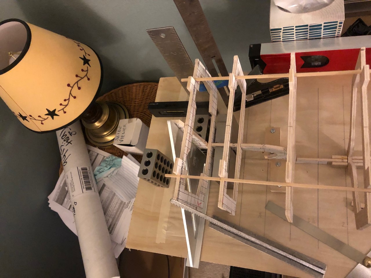

I added 2-3 frames per day, allowing plenty of time for the wood glue to set, starting forward from frame 12 and then working aft, leaving the trickier frames at the extreme bow and stern for later.
I used a quick square (or two) in addition to the 1-2-3 blocks on occasion to make sure that the frames were perpendicular to the board. This became more important as the bottom of the frames got skinnier/rounder towards the bow and stern and I could not rely on the flat bottom shape to keep those frames lined up properly. I also used a plumb bob while setting the first few frames to ensure that the centerline of the top of the frames matched the centerline of the keel. After a few frames were glued I could check this more quickly by laying a straightedge along the upper centerline marks on the frames.
File comment: Mid-body frames in progress
After fifteen frames I had run through the “easy” ones, with only one that dried mis-aligned and had to be cut out and glued again.

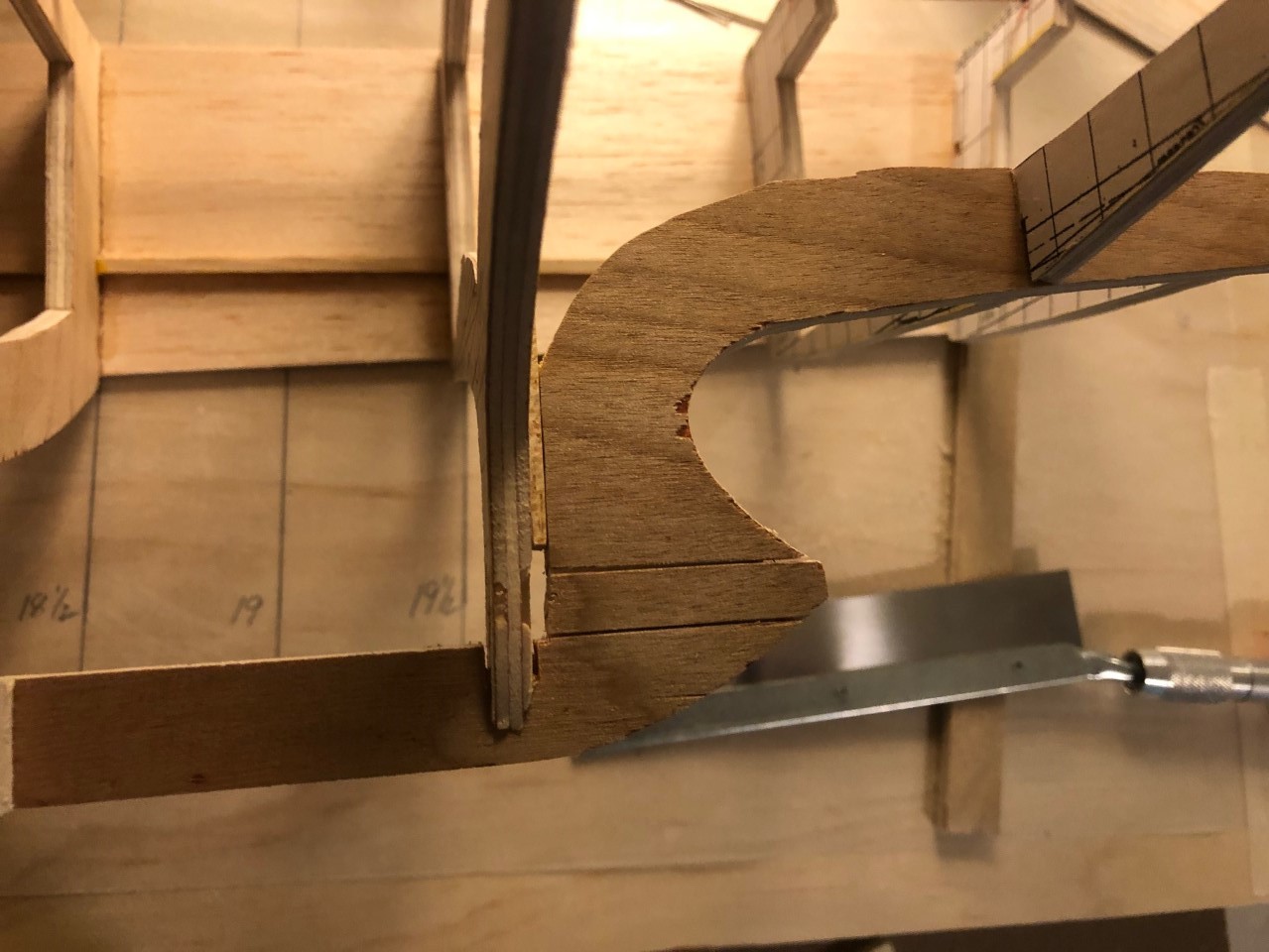

As I test-fit the forward frames it became more and more apparent that getting the right shape at the bow with just the keel and frames alone would be difficult, because the shape is rather complex as the bow transitions from a fairly fine entry at the load waterline to a broad and rounded shape at the A-Deck (fo’c’sle) level. (If you look at the very first photo I posted in this topic you can see what I mean.) I decided to add some horizontal (waterline) pieces to help get a true shape. To get the needed shapes I copied the extreme bow portion the waterline section of the hull lines. As with the frames, I mirrored this and combined the two images to get a full-width shape. These were then glued onto 1/4 inch plywood.
File comment: Breasthooks
I marked and cut these pieces as I had done with the frames. Once happy with the shape I marked and cut a notch on the forward end of each of the waterline shapes (technically more or less a breast hook) so that they fit onto the keel piece. Because these pieces will be fairly closely spaced, I needed to fair the edges so that the planking runs more smoothly. I marked the bottom of these pieces with the shape of the next one below, and used this line as guidance when sanding them fair.
I cut most of these breasthooks so that they extend aft to frame 19 and I can glue the after end to that frame. To do this easily I glued brackets at the appropriate places on the forward side of frame 19 before installing it. While test-fitting these pieces I truly appreciated having the various body plan lines on the paper glued to the frame as well as the breasthooks. Besides allowing me to cut the correct shapes in the first place, the various lines now provide multiple reference points that will make accurately fitting the pieces together much easier. The photo showing the installation of the first breasthook shows really well how the various body plan lines come together.

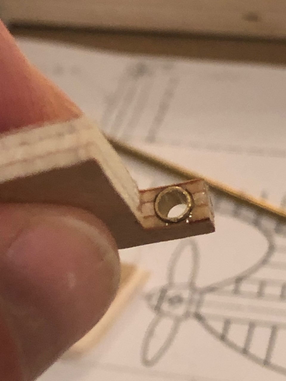

For the rudder I then made a number of different cut-outs where sections of brass tube to hold the rudder shaft would go, as well as another for a cut-down wheel collar. I had decided that using a wheel collar epoxied into the rudder would be a good way to attach the rudder to the shaft in a way that the rudder was still removable. I used a Dremel tool to cut down the wheel collar and then glued the various pieces of tube and the wheel collar to the rudder with medium CA glue, followed by quick epoxy, using a piece of rudder shaft to make sure that everything was in line.
File comment: Rudder with tubes and wheel collar glued in place.
The skeg was much easier, although for strength and alignment purposes I wanted to retain the wood structure as much as possible. To do this I drilled a small pilot hole, and then used a mini rat tail file to slowly make the hole big enough to take the shaft tube. It took a while (and some serious patience) but worked in the end.
File comment: Skeg with tube in place.
As you can see from the photos, the rudder and skeg fit together well, and also seem to operate well.
File comment: Rudder and skeg.
The set screw holding the rudder to the shaft is not really visible unless the rudder is turned fairly far to the side.
