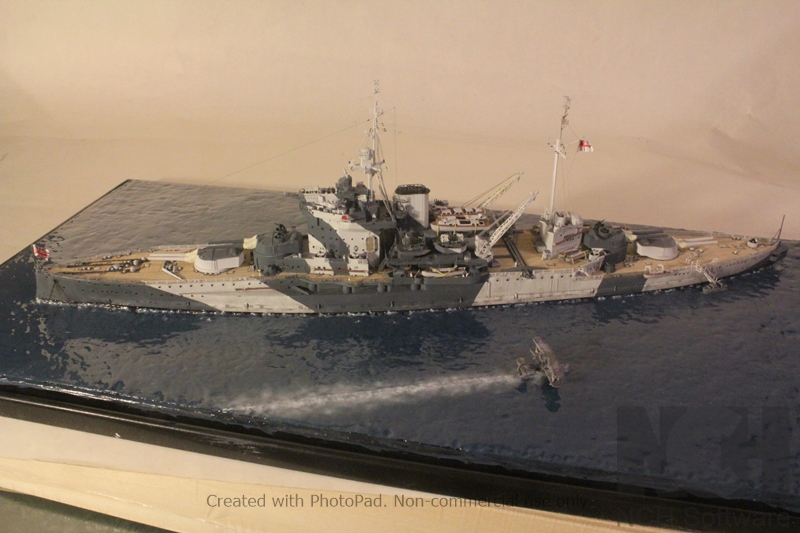

This is a 1/700 Warspite. As described above, I masked the main turret tops for neatness, but hand painted the hull and superstructure camo. Then a thin black oil wash until the right density was achieved. When that dried for a few days I drybrushed: pure white on the light areas, and light gray on the darker areas. At that point it looked pretty pristine. I then did light chipping on selected raised areas with a black/brown acrylic color, then vertical rust and moisture streaks with reddish/brown, and black oil paints, respectively. Practice...practice...practice. There are other much better examples than mine in the gallery...take a look!

Nice one! It’s a dedication thing hey!
