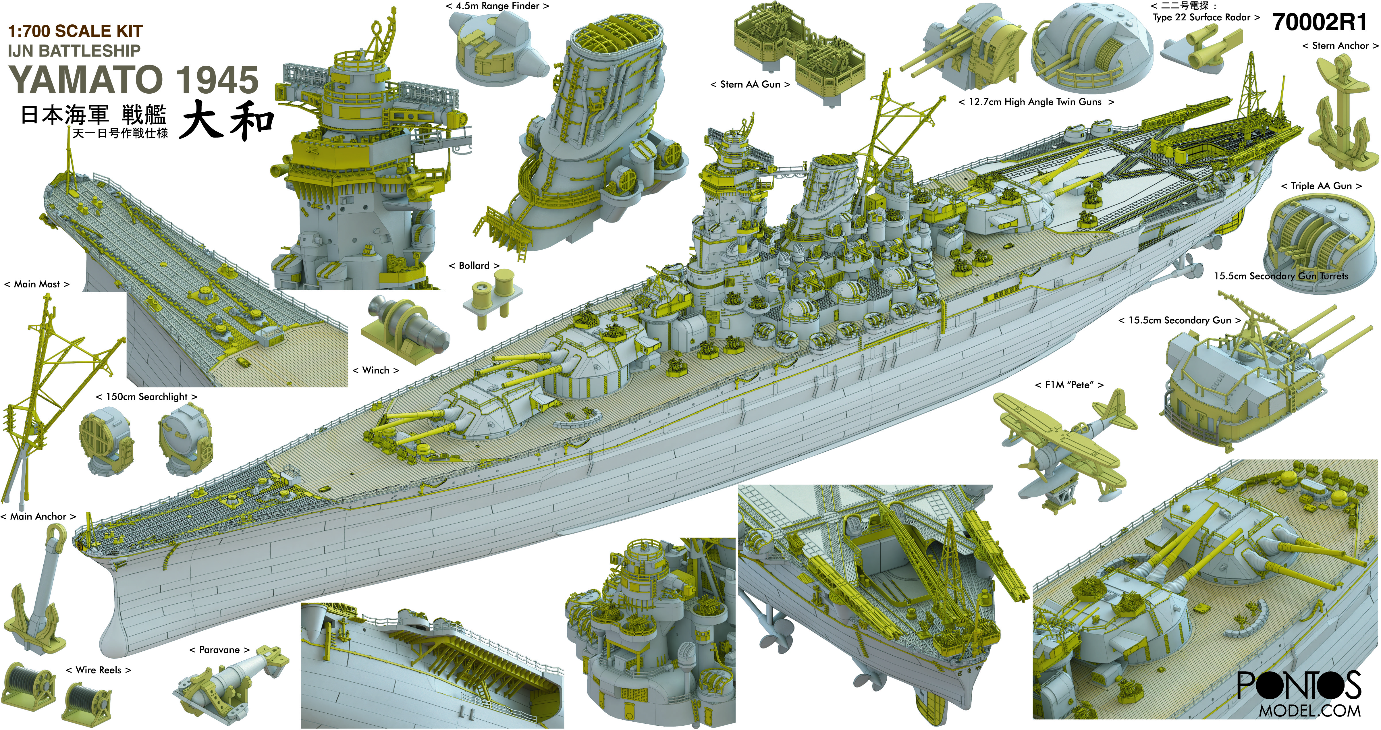

Seems very interesting. I used to have the Pit-Road, Fujimi and Yamato 1/700 kits (plus several aftermarket sets) and comparing the details, I have the impression that this is gorgeous and a step ahead. But this is just a rendering. Has anyone an idea what will like the real kit? And why the official Pontos site doeas not mention this?
I don't think Pontos usually puts things on their site until it has been released. Mr. Kim from them has posted a short thread announcing/confirming it on this forum though: viewtopic.php?f=16&t=334169

baseballbrat wrote:Question: This kit just launched here in the US and wondering, Pontos is calling this Yamato 1945, but it looks like an early version with the twin gun placement on the aft behind the crane. Also single gun placements forward. Is Pontos just stupid and not informed about Yamato's history? It's a great kit, but if their are too many errors, what's the point. It's a $150 kit in 1:700.
I'm not sure every exact final detail of Yamato's final anti-aircraft weapon configuration is definitively known? Both due to destruction of the records by the Japanese before their surrender, and the heavy damage to the wreck from her final battle and her subsequent magazine explosion.
Maybe there are lovely high resolution photos in Japanese sources somewhere that clearly show the detailed placement of every sandbag position and the shape and position of every single splinter shield for each and every 25mm AA mount? But I certainly have never seen them. Photos taken by US aircraft both before and during the final battle seem to be the best sources of information?
Calling Pontos Models stupid is unduly harsh in my opinion. Regardless of kit manufacturer, I imagine there will be an element of educated guesswork for Yamato's final AA configuration. And indeed Musashi's final AA configuration from October 1944 for that matter. As to my knowledge definitive sources for every little detail in this regard simply did not survive the war and thus no longer exist.
I apologize for my error. Looking at my reference books which are many, I found my statement to be unfounded, thus my rant on the Pontos kit should never had been posted. I actually went out and bought one today because I don't think any 1:700 kit has this much detail included. I think I might be losing my mind. Probably from wearing a mask so much, my brain is being starved of oxygen. Haha!
