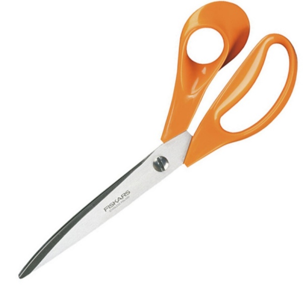

ref cutting brass... I use in my 1/1 job--every day Fiskar scissors
we buy them from Amazon ( where it said ... welcome back-you have purchased this item 107 times...(!!)
( we supply the scissors to all our staff-- new ones 3 x a year , our work amnd cloths are a challenege to any cutting edge
in my view the best and hardest blades .. also for cutting wires in brass, copper, Fuse , silver (!) and Nickel silver up to 1mm(
( for 1 mmand up..(!) I use the older ' spent ' 25 cm scioors right uin against the hige point. )
Point being...== > it is VERY quick and repeatable , the cut is nigh on perfect every time with no clean up

Those scissors look very nice indeed Jim! I'll have to look into those, as they also seem very interesting for cutting thin brass sheet.
