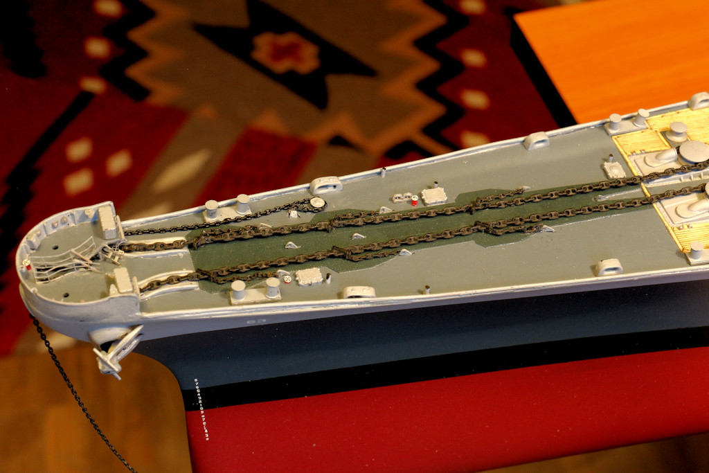

When I left off, If I recall, I had pretty much completed the main deck and was about ready to start on the superstructure, namely, the first deck of the superstructure. Here you see it exactly as it came out of the box, unpainted but with the flash removed. Doesn�t look all that impressive but hopefully it will look better when I'm done.
The first thing we do is to drill out the portholes with a hand drill. I decided that I wanted a couple of the hatches opened so I drilled out the opening using my Dremel. Then I added the ladder rungs. Luckily they give you a drilling template, as you see here. Drilling is done by hand with a 0.3mm drill.
The next step is to glue in the porthole rings and the �eyebrows� above the portholes. You can select the portholes as being either open or closed. There is enough brass photo-etch supplied with the Pontos detail kit for whatever pattern you choose (providing you don�t screw too many up!)
This photo shows the porthole rings glued in place. As you can see, some are open while others are closed. Also, note that I added are brass hand wheels on some of the hatches. Yeah, I had to buy these extra, too. Dang boat is costing a fortune!
All the side detail is removed with an X-acto knife and sandpaper. This includes fire hoses, life preservers, and vent pipes. I�m going to add my own detail since it�s much more realistic than molded on items.
Now we�re ready to paint. The sides get a coat of primer and a final coat of Haze Gray acrylic. When dry, this is masked and a coat of Deck Blue is sprayed on the tops of the 5� gun platforms I'm using Model Masters paint for this because I thought the Tamiya Haze Gray was too dark. And, after looking at several colors, I selected Model Masters Intermediate Blue for the vertical surfaces.
Next comes the waterways, or �scuppers�. These are strips of Pontos brass photo-etch (PE) that have been primed and sprayed Intermediate Blue.
The plastic part has an embossed deck pattern but the Pontos detail kit includes an actual wooden deck. It�s extremely thin and very fragile, which for my clumsy fingers is not a good combination.
The wood deck is adhesive backed, but many model ship builders here have complained that it does not stick down properly over time. To prevent this, we instead glue the decking down using artists matt gel medium. An 8 ounce bottle like this costs around $14.
We kill the adhesive on the back of the decking with Krylon clear spray and then slather on the matt gel, making sure every bit of the surface on both parts is covered.
I don't know what the image limit is on a single post, so I'll stop here and continue on Part 2.

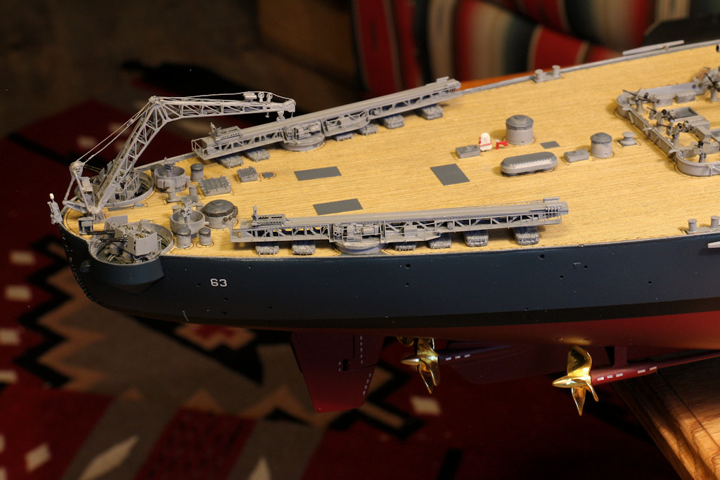

Here�s a closer look at the next deck � and part of deck 3 as well. You can see I have the portholes drilled out and the porthole rings glued in place, as well as the handles on the hatches. There�s a long way yet to go on this sub-assembly. One thing I have to do is to make a few Stokes Litters from scratch to mount on the side of this deck, and I have absolutely no idea how I�m going to do that. But that�s what makes this fun and exciting, right?? We call that �Improvising�!
I don�t know if you noticed or not, but several placed throughout these pictures, you�ve seen ladders going up the sides of the deck. These are made using individual rungs, a pair of very sharp pointed tweezers, and a magnifying glass (and a glass of wine, depending on how many of the little buggers I have to glue in!).
There are brass PE patterns for every place there is a ladder of this type, and a whole sheet of tiny rungs � which is a good thing, because you lose almost at many as you get glued in! Oh, and you use Elmer�s glue diluted 50/50 with water to glue them in. And, you glue them in by using the tip of a sewing needle. CA glue (super glue) would be a disaster with these. You tape the pattern in place, then VERY CAREFULLY drill 0.3mm (0.0118 inches) holes where the pattern indicates. And incidentally, you buy the drill bits 10 to a pack from Amazon. I�m on my 4th pack. You look cross-eyed at them and they break!
OK, Friends, that's it for now. I do have more done than what's shown here, but it'll be a bit before I can post more. I have to set up my tripod, take the photos, then clean them up a bit before I can let you see them. In the meantime, take care, wash your hands, and make damn sure you don't get this crazy virus!
