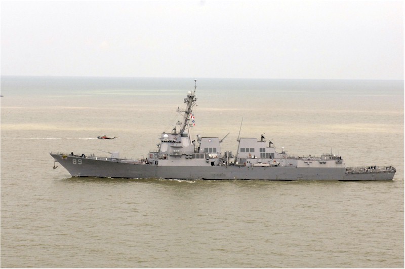

Bob, in looking at your comparison again, I must say that I disagree. The photo of the actual ship is clearly take from a point forward of the midships point (you can see the surface of the front of the aft funnel), whereas the photo of the model is taken from behind the midships point (you can see a bit of the rear surface of the fore funnel and quite a bit of the back of the bridge). If you mentally adjust these perspectives, I think that the line for the hangar doors will line up.

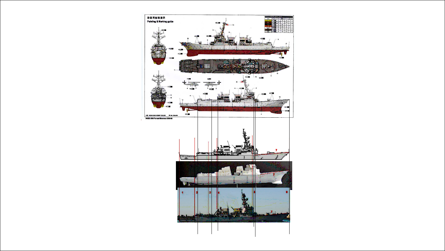

I think this shot of the kit's hull has a more perpendicular angle than the one in the comparison:
http://www.modelwarships.com/reviews/sh ... ull-02.jpg
I would also suggest using the kit's painting guide as the point of comparison, assuming it is rendered from the CAD that made the model:
http://www.modelwarships.com/reviews/sh ... /color.jpg
Attached below is a comparison using the paint guide - sorry for the craptastic quality, but I can't figure out how to save an Autodesk file as a .jpg or .png decently. As you can see, Line 7 is much more acceptable with the paint guide as the comparison. Other proportions are off, but can be explained within reasonable bounds by parallax in the photo of the actual ship.

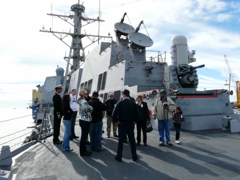

I have some food for thought. What the Phalanx CIWS chair looks like, sloped
or stepped,
depends on which ship you are looking at.
I saw there was another question as to how far from the structure Phalanx was positioned.
As you can see, it's actually really far away from the aft structure.
It seems that most of the ships, however, have the slopped backs instead of the stair-stepped ones. If you are interested in fabricating one, it can be done with square and rectangular stock styrene!

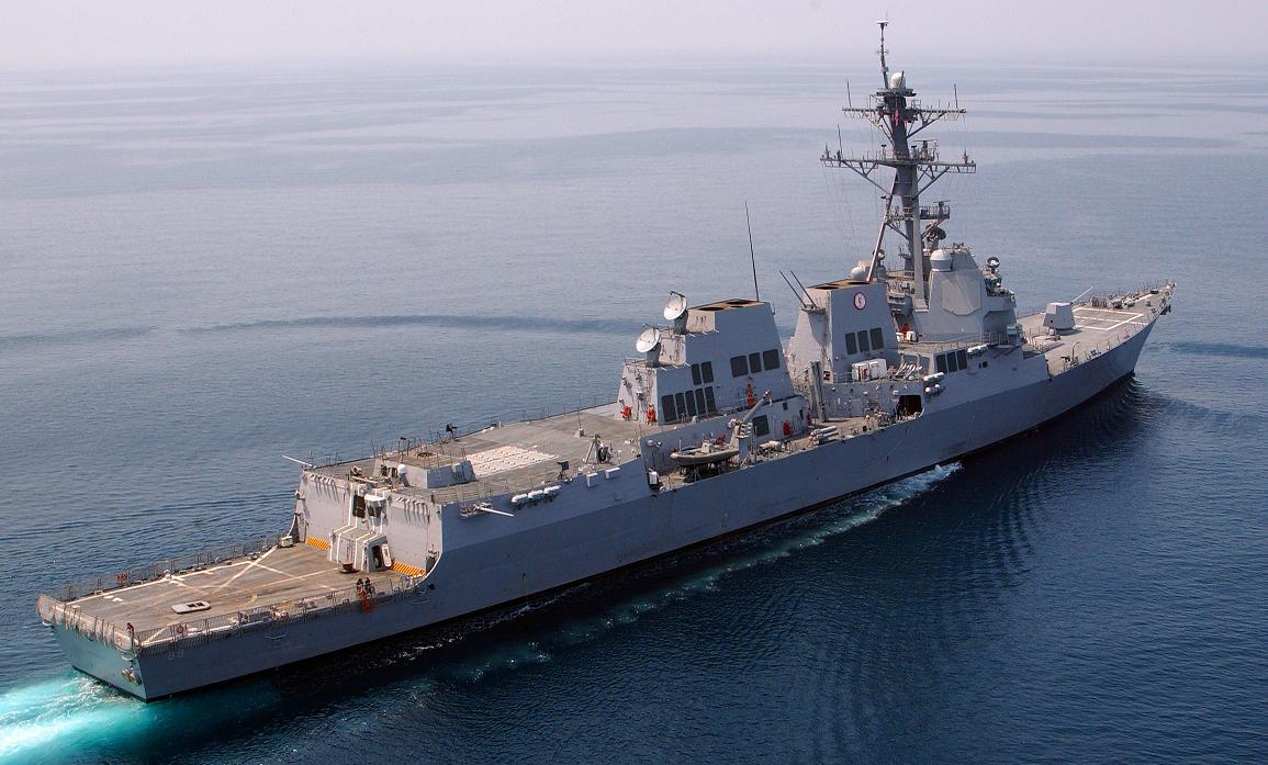

For as retarded as this whole class of ship looks, this is really one of the most beautiful shots of the class I have seen.
She is undergunned, under protected, over priced, and has little to no room topside for additional equipment...but she's kind of neat looking.
