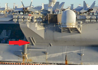

Work continues..........Finally. :thumbs_up_1: I am still working on replacing all the vents. At least I have all the vents cut out now which was a pain the @$$! I have a photo that I included that shows some type of pipes in the aft port side of the ship. Maybe someone else may be able to shed some light on what these are, and what they are for. Anyway, I attempted to replicate them on mine. I also added more of the hull stiffeners in this area as well and reshaped the aft port sponson as it should be. The sponson isn't glued into place yet as I still have quite a bit of work to do to it. I probably won't actually add it till way later.
Here is the photo of the pipes I had mentioned.  I'm not exactly sure what they are for.

Hello Doug,
this build is extremely interesting, and a true 'how to' guide concerning how to go about superdetailing a ship (of any type) or in fact any model.
Just one thing - not trying to be an annoying know it all or anything; merely wondering, when looking at all the detailing you have done whether you have missed something, or chose to forget it (considering all the work you have done rightfully so).
When looking at the picture where you point out the pipes underneath the aft port side of the ship, that sponson (or whatever it is called) that has the pipes attached to it, in the image, the aft side (non-elevator side) does NOT seem a straight line - unlike the kit part - from the edge of protrusion (where the rafts are attached) to the hul. It seems to be a stretched out 'Z'. The very outer part seems parallel to the inside (the side of the elevator) - the 'break' in the 'Z' occurring where the rounding/curvature of the outside of the sponson (for lack of better word) takes place. Is this optical illusion of the original picture (due to light), or is it really there? Because it seems the side/panel parallel to the elevator side is much lighter (better lighted) than the panel at an angle, and the only way I can explain it is because there is a kink there that is not there in the model.
Or is this kink the result of this picture being of a different era than the one you are depicting?
All that said, keep up the extremely good work, and I do definitely look forward to your next installment. And again, no offense intended with my comment.
Harm
Harm
Thanks for the comments DutchBird! No offense taken at all sir. I believe what you are looking at in the photo is an optical illusion. The way the light falls and shadows being cast in the photo give the appearance of different angles that are actually straight except at the very bottom where the angle deck attaches to the hull. I have included the original photo that I used for this area and a couple others to show some other angles and close-ups of the same area. I can totally understand how the photo I used can trick the eye so to speak.
Here is the original photo. You can see the shadows that are being cast.
cropped port.png (192.98 KiB) Viewed 1765 times
The red arrow is pointing to a "downspout" that runs vertical along the face of the angled deck and to the bottom. What is significant about this pipe is that in the photo above, this pipe is what is giving the impression of a "break" in the angle when really there isn't one. The angle is continuous until it reaches the curvature up to the deck (I had to sand the kit part a little more to get this curvature as the kit piece is more of a 90 degree angle than the curve it should be). I think because of the curve and the angle of the photo, it makes it look like it goes different directions.

This photo was taken in 1999 just prior to this radar platform being relocated to where you see in the above photos. If you look just left of the platform, you can see the "downspout" that remained.
With all this being said, even with all the work I am doing on this model, I doubt my end result will be anything close to accurate. There are definitely flaws with the kit and my skills as well. :lol_1: I'm pretty sure that anyone else who has tried to replicate an accurate Enterprise with this kit was left feeling kind of disappointed. However, I will be trying my best to portray a good representation of her. Thanks again for your comments and checking out my build. I welcome all comments. Keeps me from messing things up! haha
