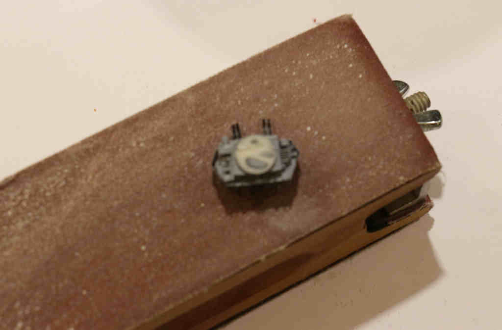

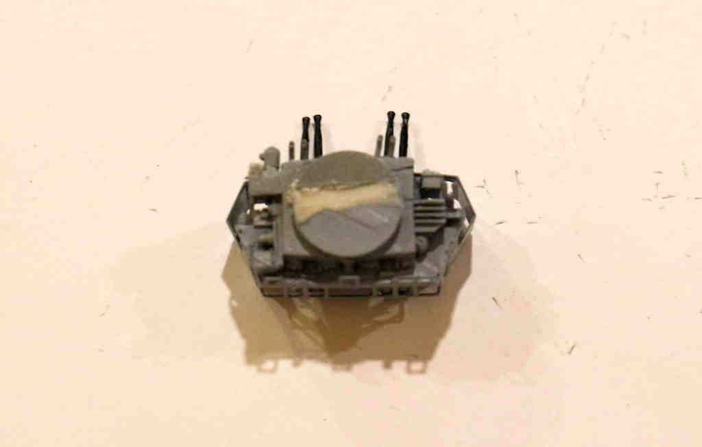

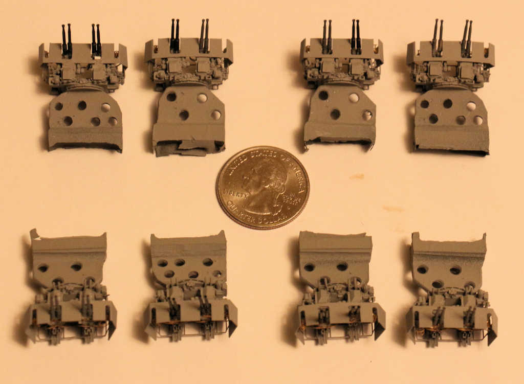

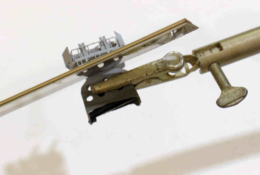

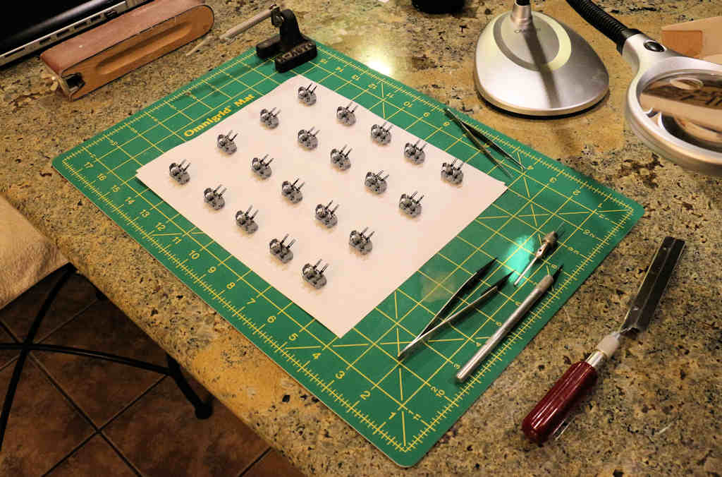

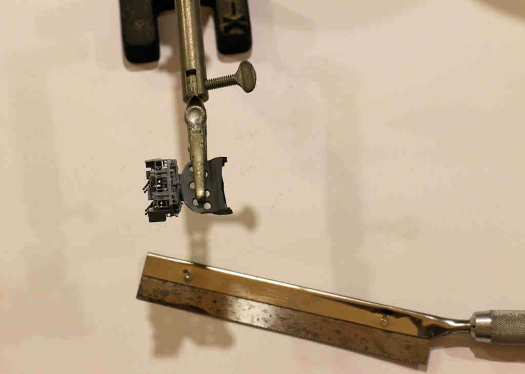

Hi Folks, It's been some time since I've posted on this thread, but I don't want you to get the idea I've given up or abandon this project. The 'Monster Mo" is still very much alive. However, I will add that for some reason I don't seem to have a lot of time to dedicate to it. It's strange, but when I retired I assumed I'd have tons of free time to play. Now I wonder how I ever had time to go to work. But that isn't what this post is about.
I am taking Jason's advice and working at least a couple hours a week on it. Yes, it's not much and yes, it's slow going, but it's progressing and I definitely am not getting anywhere near "burned out". Besides actual work, however, I'm doing a lot of thinking, planning, and revising what I want to do. I recently decided that I wanted to put drop grab irons on my ship, which resulted in a few evenings research and investigation before I found exactly what I wanted - with the help of the great folks on this site, I might add. And, I've been reading Stillwell's book. A fascinating history of the Missouri, in case you haven't read it yet.
Would you believe I'm still working on the 40mm Veterans quad Bofors! Yeah, I've been building guns for close to 5 months now. Tom Johnson is going to have his whole fleet of ships done before I finish this beast. It's hard to imagine, though, that something that can fit on a quarter and have room to spare can have so many blasted little parts (36 to be exact). Some of them you can't even see when the whole gun mount is done. A few of you have said that one of these big boats is nothing but a collection of smaller kits, and I'm starting to see what you mean. Anyway, I have 10 of the quads together and aside from the final painting and minor tweeking and straightening of gun barrels, sight shields, and foot pedals, they're done. I've been trying to do at least 2 o 3 a week. I think they look halfway decent.
I started out following Jason's tutorial on how to put these together but when I got to the gun sights and the curved sight shield I ran into problems. I had trouble getting them down into where they belonged and after ruining one set, I decided to try a different approach. The next gun set, I added the gun sights and shield to the gun barrels before I glued the guns to the mount. Worked like a charm - for me at least. Now I have the sights on all the rest of the guns and it's not problem at all to see where the sight shields attach. The only thing is, you have to be very careful gluing the guns to the mounts.
So there you have it. I have to spray the little buggers and then brush on a coat of gunmetal on the barrels and recoil springs. And oh yeah, as a final item, glue the ammunition clips to the guns - after I carefully paint the shell tips green.
Take care peoples, and keep on posting your pictures and progress. You wouldn't believe how much I learn from you.

Your bofors look great! Good to see some progress.
About retirement... sounds like you're doing it wrong.
Seriously though, there's nothing wrong with going slow and steady and no need to apologize. These 1/200 battleships are maddeningly huge and complicated projects that take A LOT of time and I think this group is of patient disposition generally (if you don't count understating the release dates of promised aftermarket sets

I think you are doing a great job with the bofors. As you mentioned, lots of tiny pieces that would literally drive me mad. You are also correct in that a ship is made up of a bunch of smaller models. Each sub assembly is a model in itself and you can claim accomplishment when the sub assembly is complete. Keep up the good work.

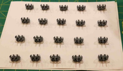

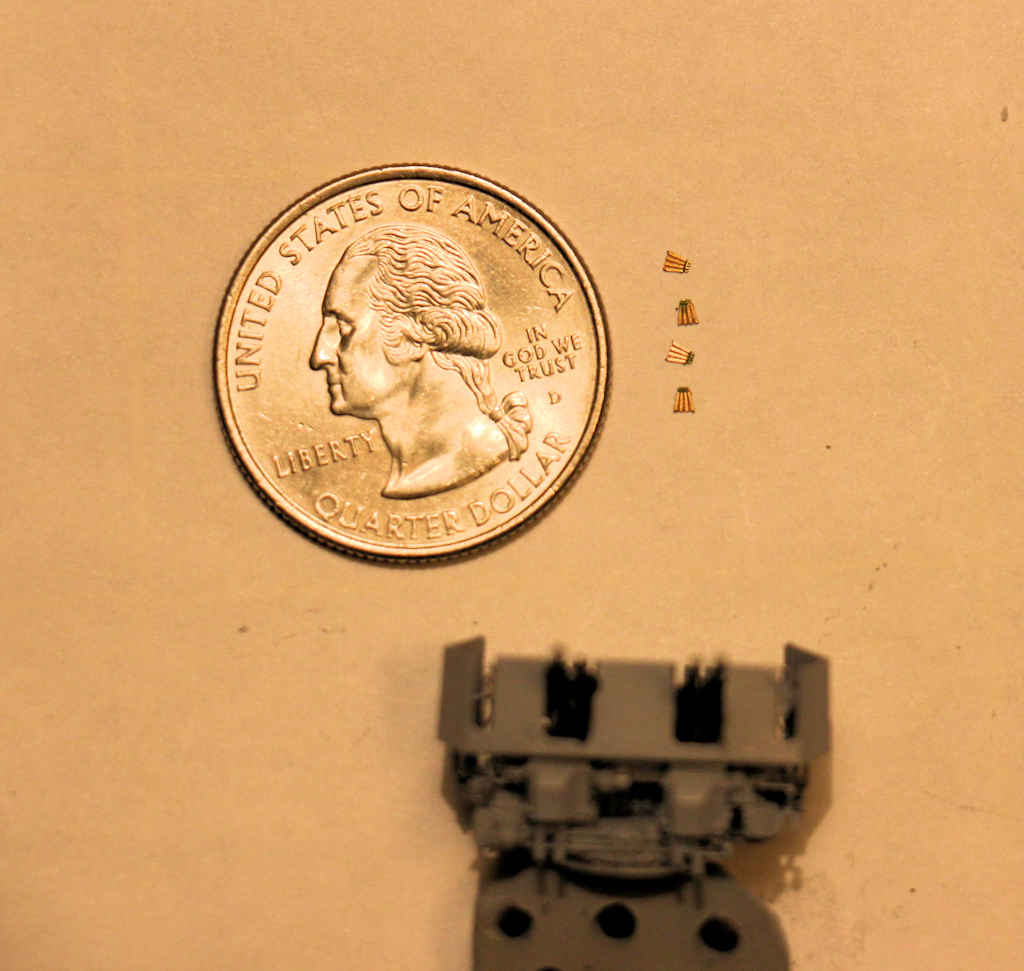

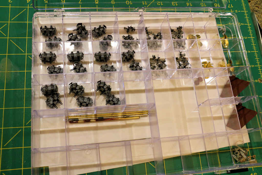

Hi Friends,
I bet you thought I fell off the face of the Earth - or, in Jason's case, that I got discouraged and gave up.
Nope!
I'm still plugging away, except for the past three weeks I've had a cold that turned into bronchitis. Let me tell ya, guys and gals, it's not a good idea to be fooling around with itsy-bitsy pieces of brass when you have a coughing spell. The two do NOT go together!!
Yeah, there's 20 quad Bofors on my Monster Mo and each one of the mounts has 4 of these tiny cartridge clips. But, those are the very last items to be glued in place.
That's right!!! My guns are done!! All 50 of the 20mm Oerlikons and all 20 of the Quad Bofors And you want to know something? The box cover of this kit says there are 1573 pieces to it. That's not including any 3rd party detail kits. Now these 20mm and 40mm guns have a total of 1290 pieces to them all by themselves. Kinda blows ones mind, eh what?
As I was ruining my eyes assembling these little bastards, I seriously wondered at the level of detail. Why on earth would they have the cranks to the Bofors as a separate piece when there is no way in hell you can see them on the finished gun? But, I put them on like a good little modeler. At least I know they're there.
Now, for a little advice. Since these Veterans quad Bofors have so much detail to them, and there are so many pieces, once they are all together, there's literally no place to grab on to break them off the work base. So, I sent a PM to Jason and asked him how he got his off. His reply: Use a razor saw to cut part way through, then gently rock the gun back and forth until it separates. Then carefully sand the bottom to remove any burr or unevenness. I did it and it works like a charm. So don't give me credit for this one - Thank Mr Channell.
Now that the AA guns are done, I can start on the fun stuff! Look for more frequent posts from your friendly neighborhood idiot (Blind idiot, that is!)

Stinerman, great work on your Bofors. The number of those buggers, along with the 20 mm's, it truly daunting, even I imagine in 1/200. The repetition can be mind numbing. I do have a question for you. How did you settle on gunmetal for the barrels of the Bofors? If seen photos of Bofors mounts on battleships with the barrels in gunmetal and also painted in the camo color of the ship in that area. What persuaded you to go gunmetal?
BTW, I admire your skill, perseverance, patience, and pure out and out determination in getting that monster built. I have no doubt that when you are done you will have a museum piece sitting on your display shelf.

Good morning Bob,
How are things down in Kentucky this morning. I gotta tell ya that spring in Michigan is beautiful! It got up to 77 degrees here yesterday and with the sun shining, it sure does make foe a great case of spring fever! Problem is, I'm still coughing like a fiend and my Better Half won't let me outside to play in the dirt.
Now, about your question. Actually, I painted 5 of them gunmetal and after they dried, I didn't like it. It's hard to describe, but they looked blotchy and not very realistic. So, I painted another 5 flat black and decided that they looked a lot better. Result: I ended up painting them flat black and they look OK as far as I'm concerned. Hey, when you stick them on a ship that's 4-1/2 feet long who in the hell is ever going to know the difference?
My next step is the bow gun tub. The kit piece is quite spartan. According to TFD's plans, it needs a phone box, a fire suppression valve, spare gun tubes, cooling tubes, and 2 3" support columns plus the Pontos items in the detail kit. Should keep me busy for a while. Then once I get this done, I get the wonderful job of running the .02" brass wire around the top of the lip I added. Gonna take some steady hands for that job!
