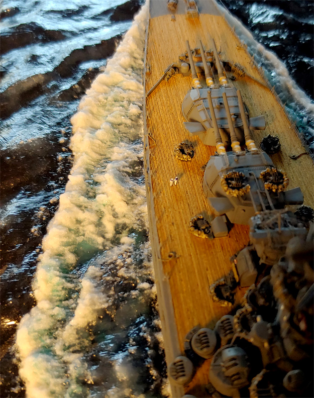

Some foam-lined detail and a final coat of gel (cloudy in some areas as it will dry clear) before a layer of high gloss medium.

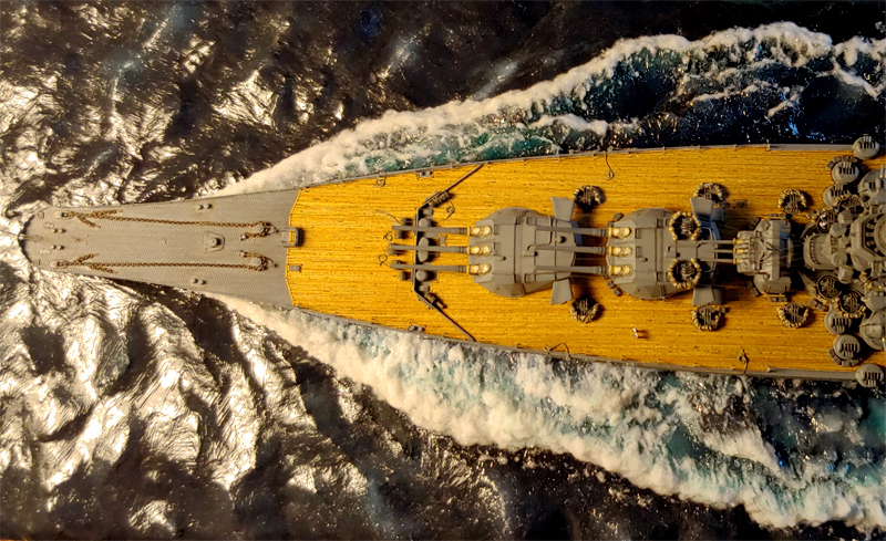

I circled back on the water and did substantial amount of trimming. I haphazardly created a technique due to trial and error, that is, applying a number of layers of paint (shades of blues), snow sprinkles, extra heavy gel medium and repeat (I stayed away from cotton, results were not satisfying) - it started to give an illusion of depth. Finally, topped it with water gel transparent - one more pass to create the peaks in the wakes. This process took several weeks, due to the slowness of gel curing. This is my first 1/700 kit / diorama - I'm learning.
Posts: 8512
Re: 1/700 YAMATO
I like the seascape. The ave action looks really good, to me.

... overhead shots.

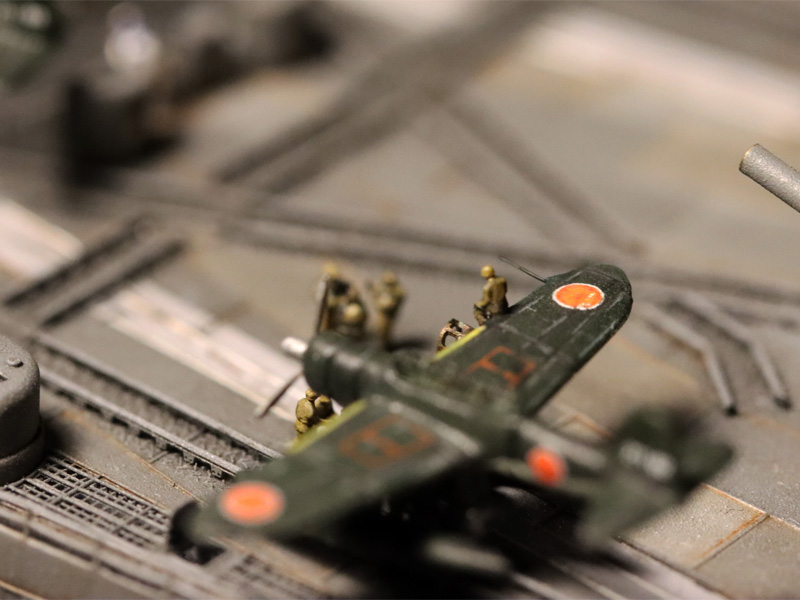

Trying the new lens - shared a couple of closeups.
marijn van gils
Posts: 2686
Re: 1/700 YAMATO
Post by marijn van gils »
Excellent 1/700 scale figure painting work! :thumbs_up_1: :thumbs_up_1: :thumbs_up_1:

When I saw the pictures of the float planes, and I had to double check that this was a 1:700 ship! I'm very impressed. I also really like your water effects. Extremely well done.

short question, do you have a guide or something about how you make that seabed? which materials etc?
Under construction: KMS Bismarck 1/350
En-TACT
Posts: 116
Joined: Mon Apr 23, 2012 2:15 pm
Re: 1/700 YAMATO
Post by En-TACT »
IJNfan wrote:short question, do you have a guide or something about how you make that seabed? which materials etc?
Sorry, I don't. Backtrack on this thread, you can follow what steps I took with the materials and how I went about it.
List of materials:
- Styrofoam & Papertowel
- Liquitex Gesso
- Amsterdam Gel Medium (extra heavy)
- Americana Premium Acrylic Paint, Phthalo Green-Blue
- Americana Premium Acrylic Paint, Phthalo Turquoise
- Americana Premium Acrylic Paint, Phthalo Black
- Americana Premium Acrylic Paint, Phthalo White
- AK Water Gel Transparent
- AK Snow Sprinkles
- Liquitex High Gloss Varnish
This was my first attempt at a seabed, much was researched and done by several trials.
