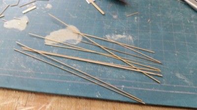

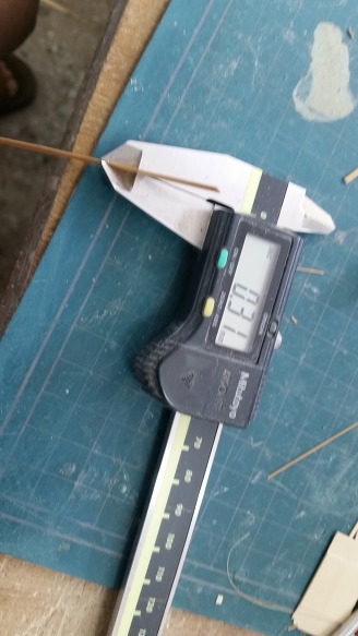

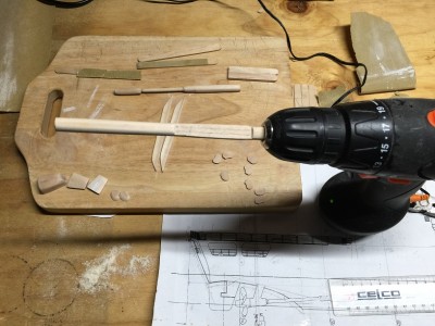

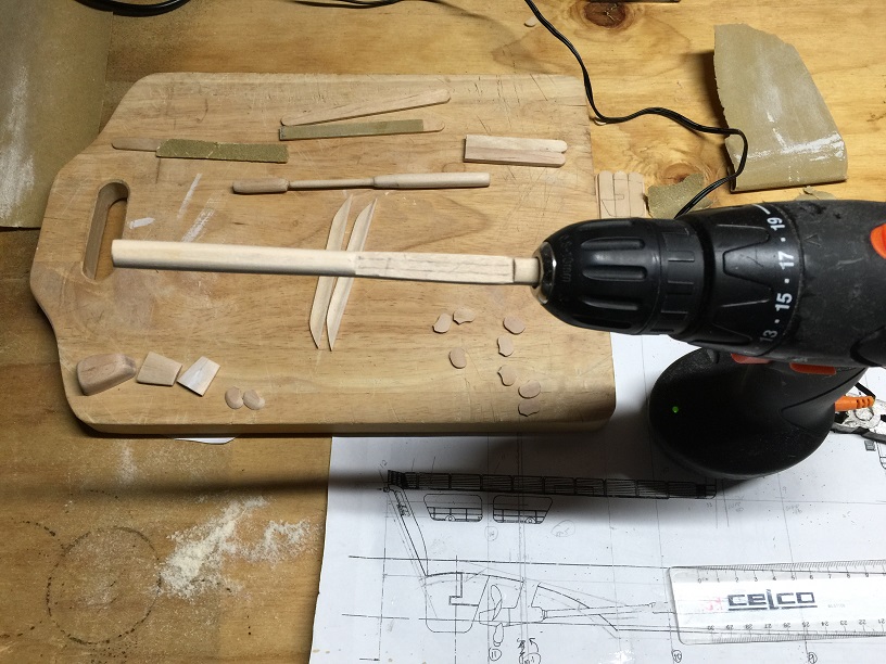

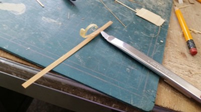

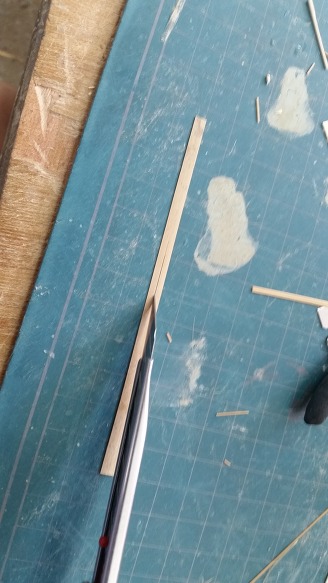

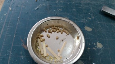

Hi, Phil.Froggy84 wrote:Hi Song,
Phenomenal work!
I am new to the forum but I have seen several of your incredible builds posted and admire your talent and attention to detail. You are the Jedi Master of wooden model ship building!
I am also trying to build a ship made of wood using craft sticks, but I can't achieve the same results as you, I'm still a novice.
May I ask what glue you use? I've been using PVA.
Are all of the wood pieces you use ginkgo?
Also, how do you make the sticks for the mast and fence or safety railings so thin? How thick are the sticks for the fencing? I would appreciate your advice thanks.
Welcome this forum and my model making story!
I've been experenced in 15 years of wood warship model.
Yes I used almost of all wood pieces except railing and rigging.
I used a drill to making sticks (small diameters of ) also mast materials.
I roughly cutt the wood or Bamboo and then bite the drill chuck.
and rotate the drill and hold the sand paper on the rotating wood stick untill wanted diameter of it.
i used Bamboo for making railings. The outer part of Bamboo Is used in steelwire of railing and inner part of it used pole of railing. the inner part is relatively soft then outers.
The Bamboo is very easy to split in length.
You can understand to see the pictures below.
Song.

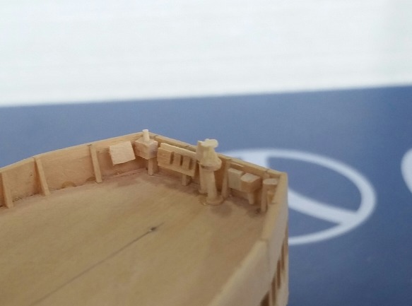

Re: 1/200 NEW JERSEY

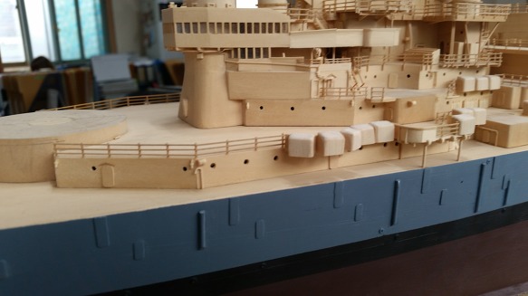

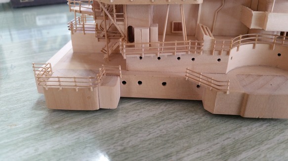

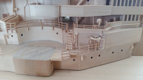

Thank you, Aur!
I 've made the railings of after parts of deck.
Song.
Song.
Hi Song,
Thank you for the advice and the welcome, I appreciate it.
I'm building with popsicle sticks so I will see if I can try what you've suggested with them.
Also, I use PVA wood glue. Do you use a different type of glue?
Hi, Phil!Froggy84 wrote:Hi Song,
Yes, I use PVA glue too. It's cheap and good and water soluable.
Song.

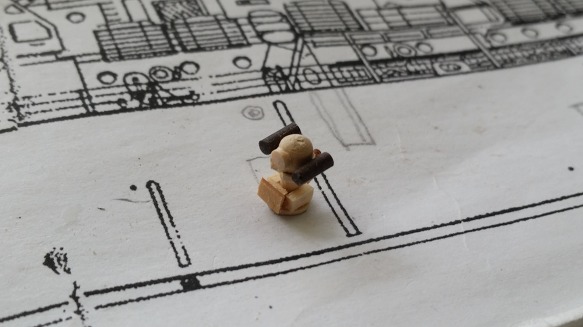

- Song Jung Gun
- Posts: 1627
- Joined: Sat Apr 26, 2008 5:21 pm
- Location: chun an city chung nam Korea

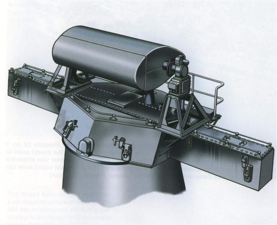

Hi all!
It's main gun director, Mark 38.
Song.
Song.
Hi Song,
Your detail work is incredible as always!
Thank you again for your advice with the bamboo and making the right diameter by using a drill.
I tried your idea with my popsicle sticks when making the propeller shaft and it worked very well.
I am very happy with the result, thank you again. I haven't tried it with making railings and posts yet but will try that too.

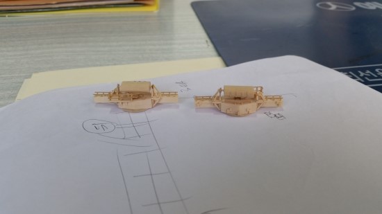

- Song Jung Gun
- Posts: 1627

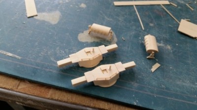

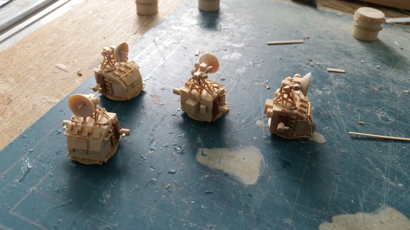

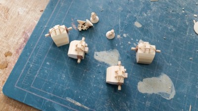

Hi all!
I've made Mk-37 5"/38 DP gun directors.
Song.
Song.

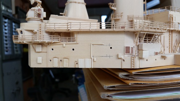

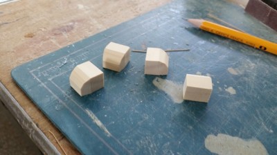

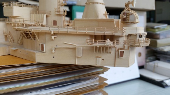

Hi all!
It's very hot summer in this year!

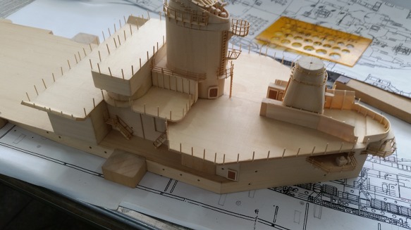

I continnued model making here and there.
The wall of aft structure ,drain pipes, exhausts, and boom, upper part of bridge.
Song.
Song.

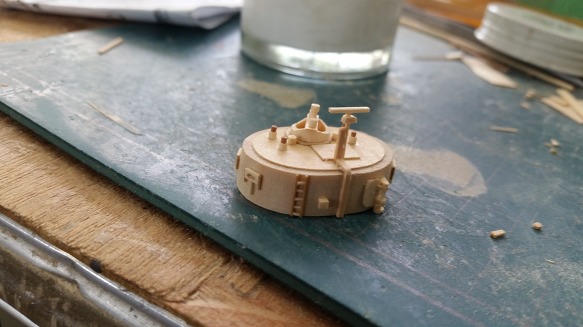

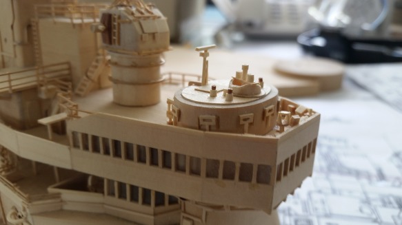

Hi all!
It's upper part of conning tower and magnetic compass.
Song.
Song.

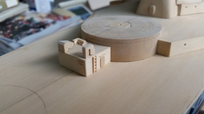

- Song Jung Gun
- Posts: 1627

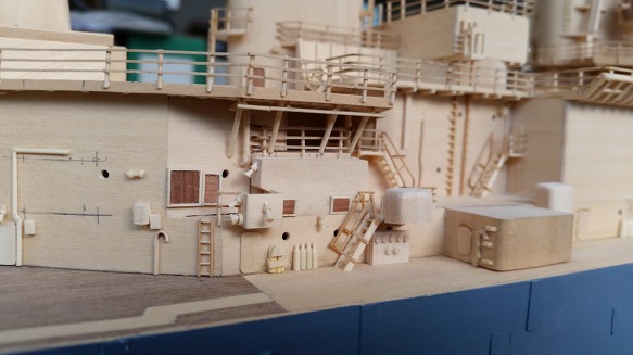

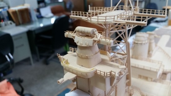

Hi, All!
It's div. office of 2nd main gun turret. And loud speakers, bracket lights...etc.
Song.
Song.

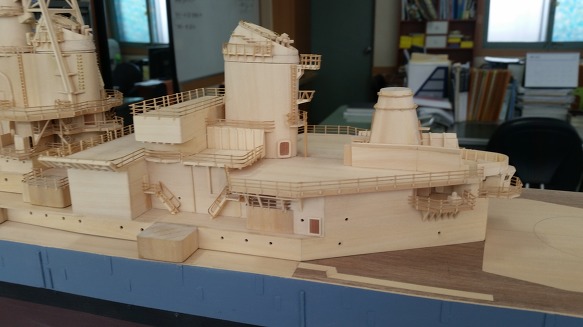

- Song Jung Gun
- Posts: 1627

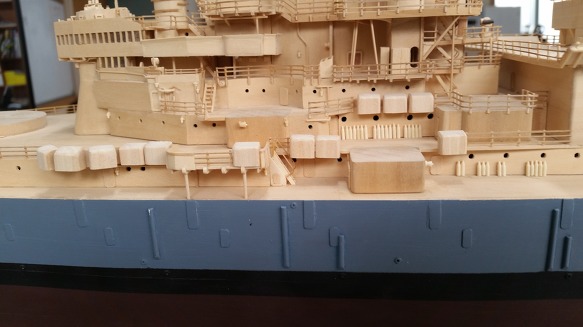

Hi all!
It's some advanced photos. I want to some pictures of port view of USS New jersey just 2nd photo.
Thank you,
Song.
Thank you,
Song.

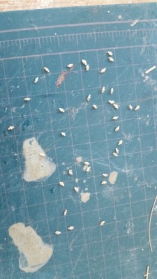

- Song Jung Gun
- Posts: 1627

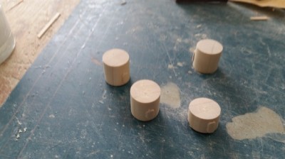

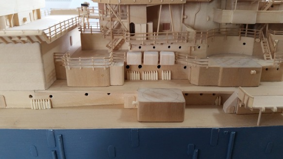

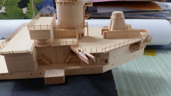

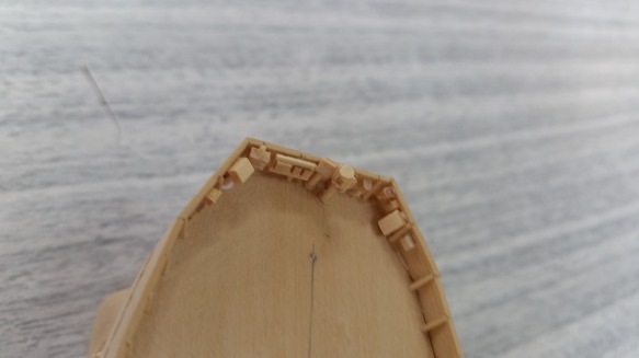

Hi, all!
It's life rafts and railing of 2nd floor.
Song.
Song.
