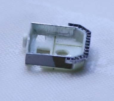

The next tier to construct was the air defence platform � a relatively simple structure, the highlight of which was the wind deflector flanking its front. After having replaced the splinter shields with aluminium sheet I glued nineteen pre-cut spacers to the front. It can be seen that these spacers were initially not identical in shape � some careful sanding made them look more regular. I then added a strip of lead foil to the spacers thus completing this section.

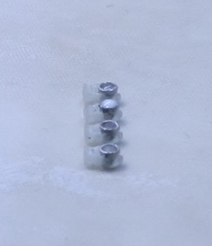

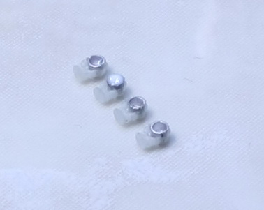

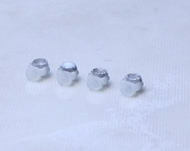

Before dealing with the top of the bridge I decided to construct small parts that will be attached to this section of the ship. 44� searchlights have been prepared using an excellent 3D printed set from MicroMaster.
I drilled out the lenses, painted the inside silver, then filled the hole with Micro Kristal Klear. Alas, I was unable to take decent pictures of them � they look way better in flesh!
