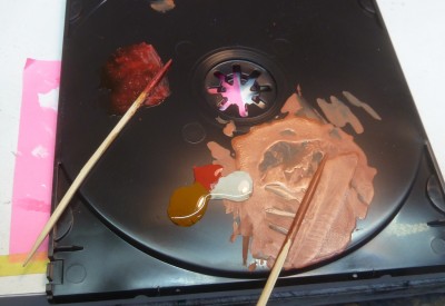

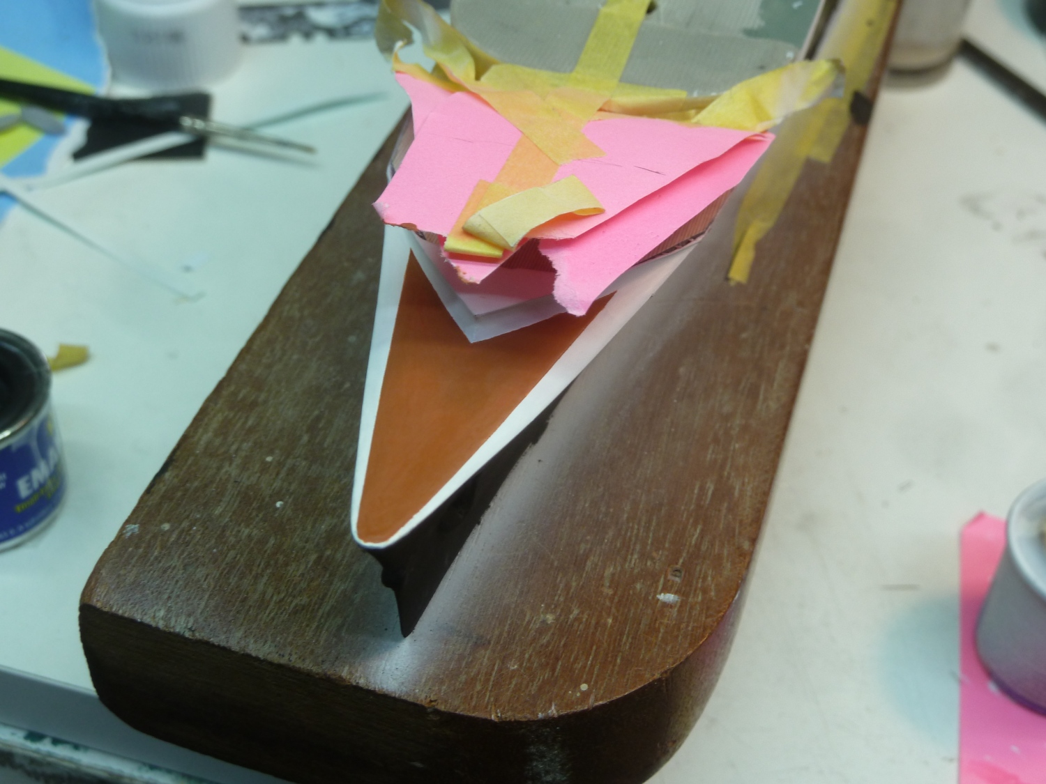

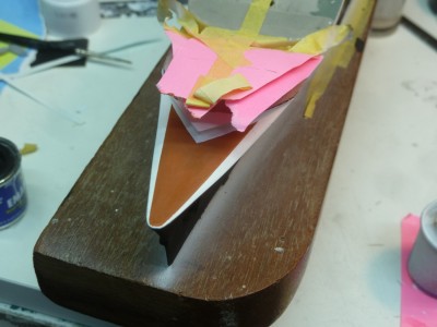

the real ship had the fwd central portion of the fore-deck painted in a ( looks to me) a kind of red ochre colour
based on this image
and these two (both colourised I think )
I set about mixing something akin...
I shall touch up the bow with a brush and clean up the edges with a blade
I am happy enough with the shade--bit not the intensity
So as to remove the ' colour bite ' ...I will wash it down with some pale filter coats

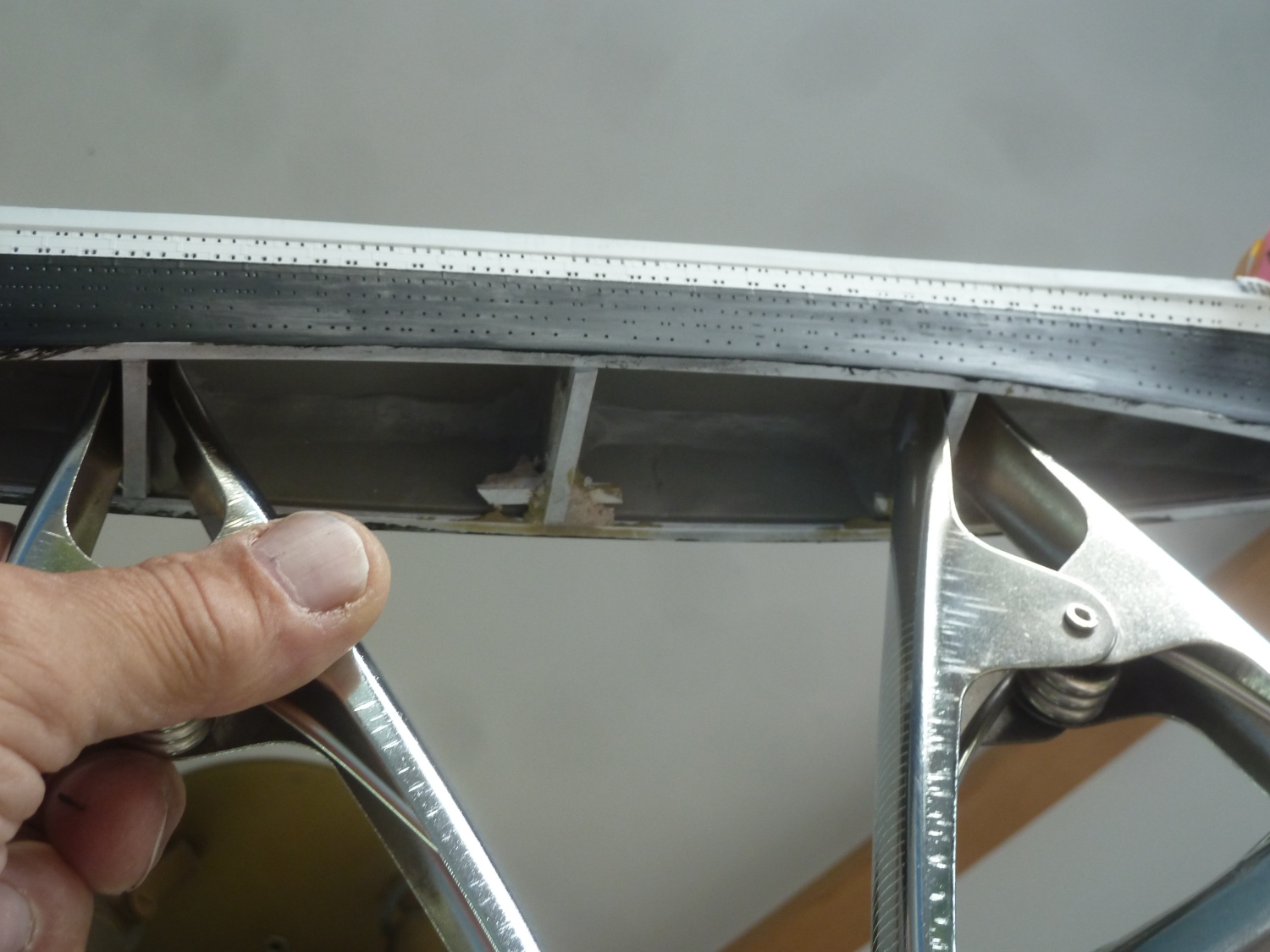

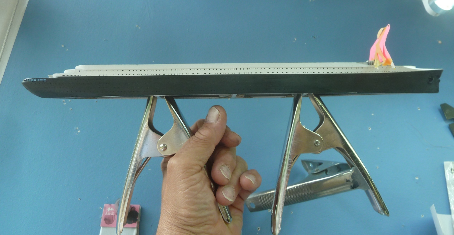

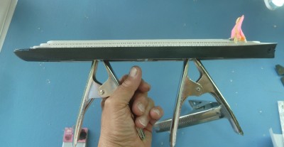

Having given the hull another coat of anthracite--and soon needing to do the boot topping
I removed the hull from the building board and transferred it to my favourite clamps,
which attach conveniently to the transverse bulkheads.
The clamp attached sideways allows me to put the whole ship assembly down without it falling over
The elegant hull shape is--at last-- starting to show.

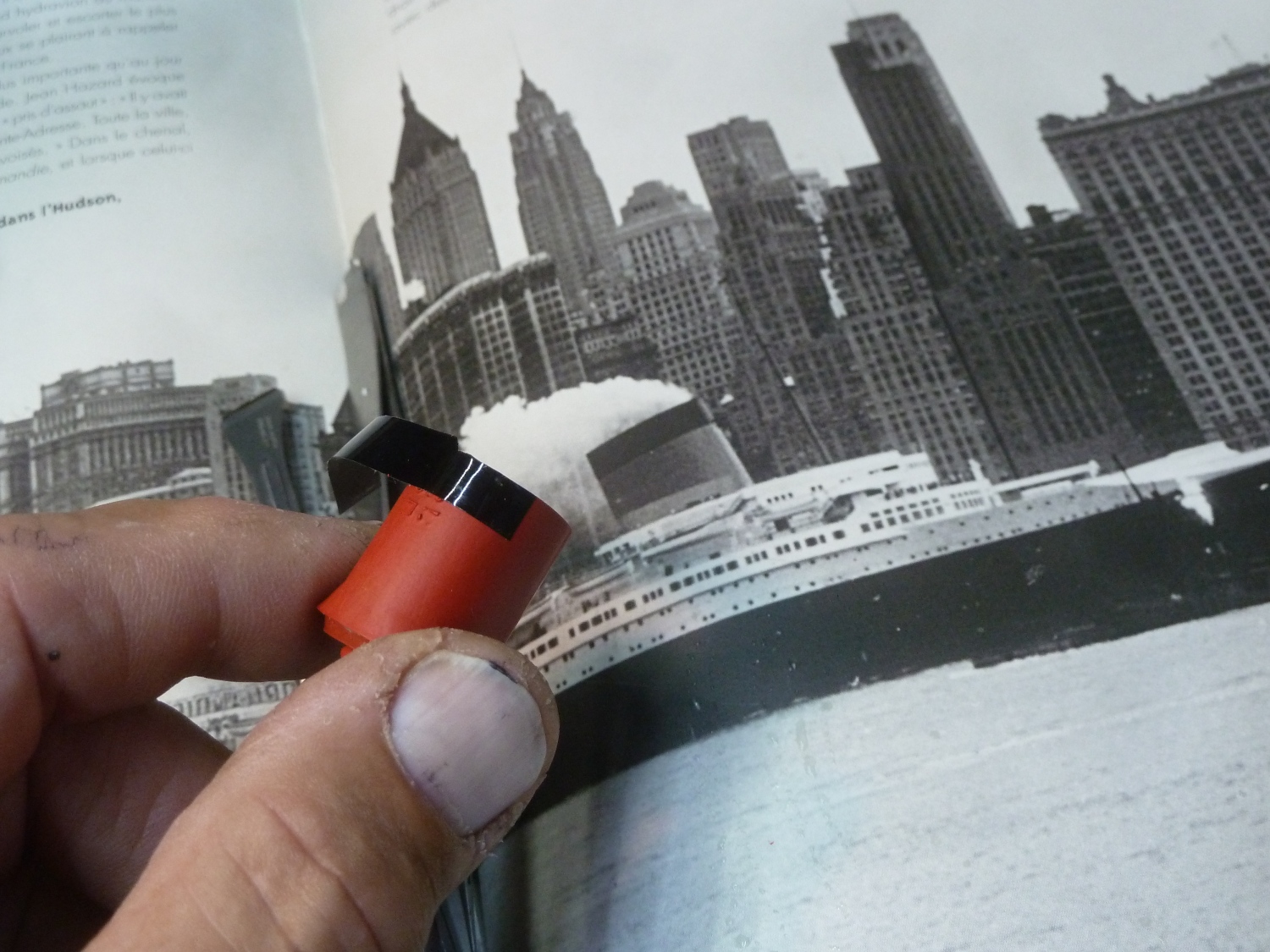

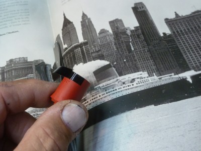

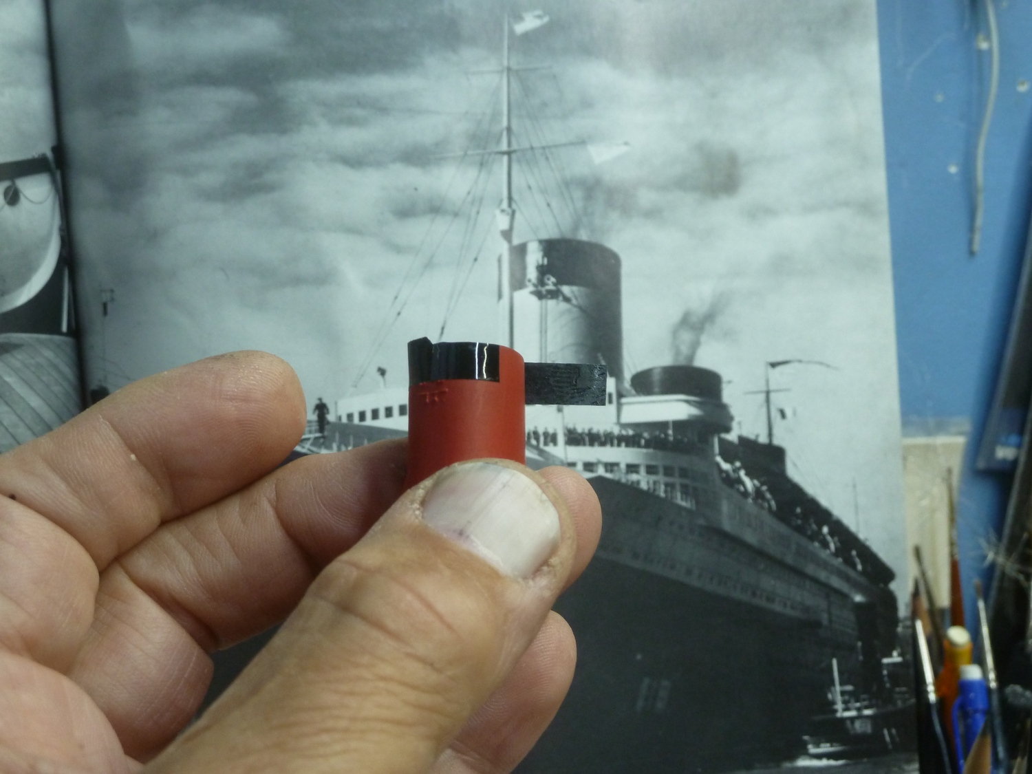

whilst waiting for paint to cure,

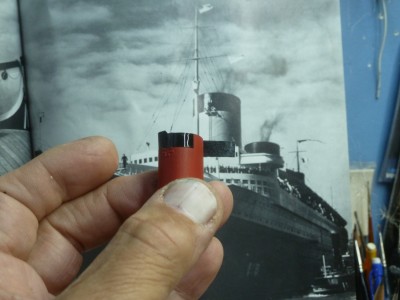

I have been experimenting with the depth of the black bands on the funnels.
Obviously I scaled a photo and measued off it -- but it did not look 'right' to my eyes
so out came self adhesive tapes
the process is still ongoing-- results soon

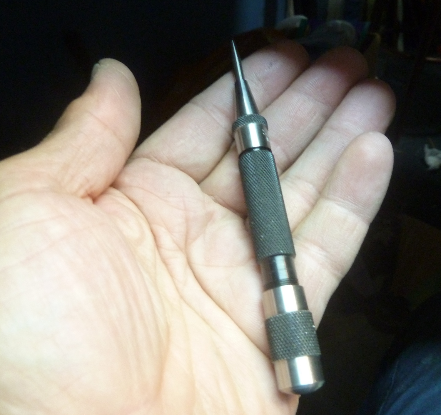

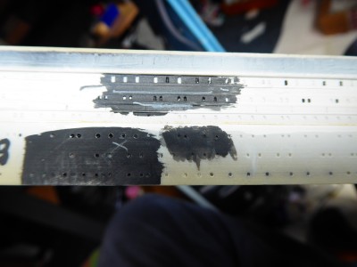

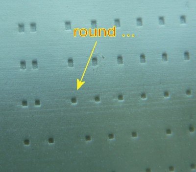

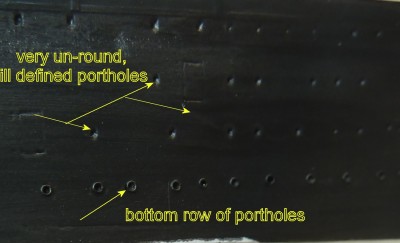

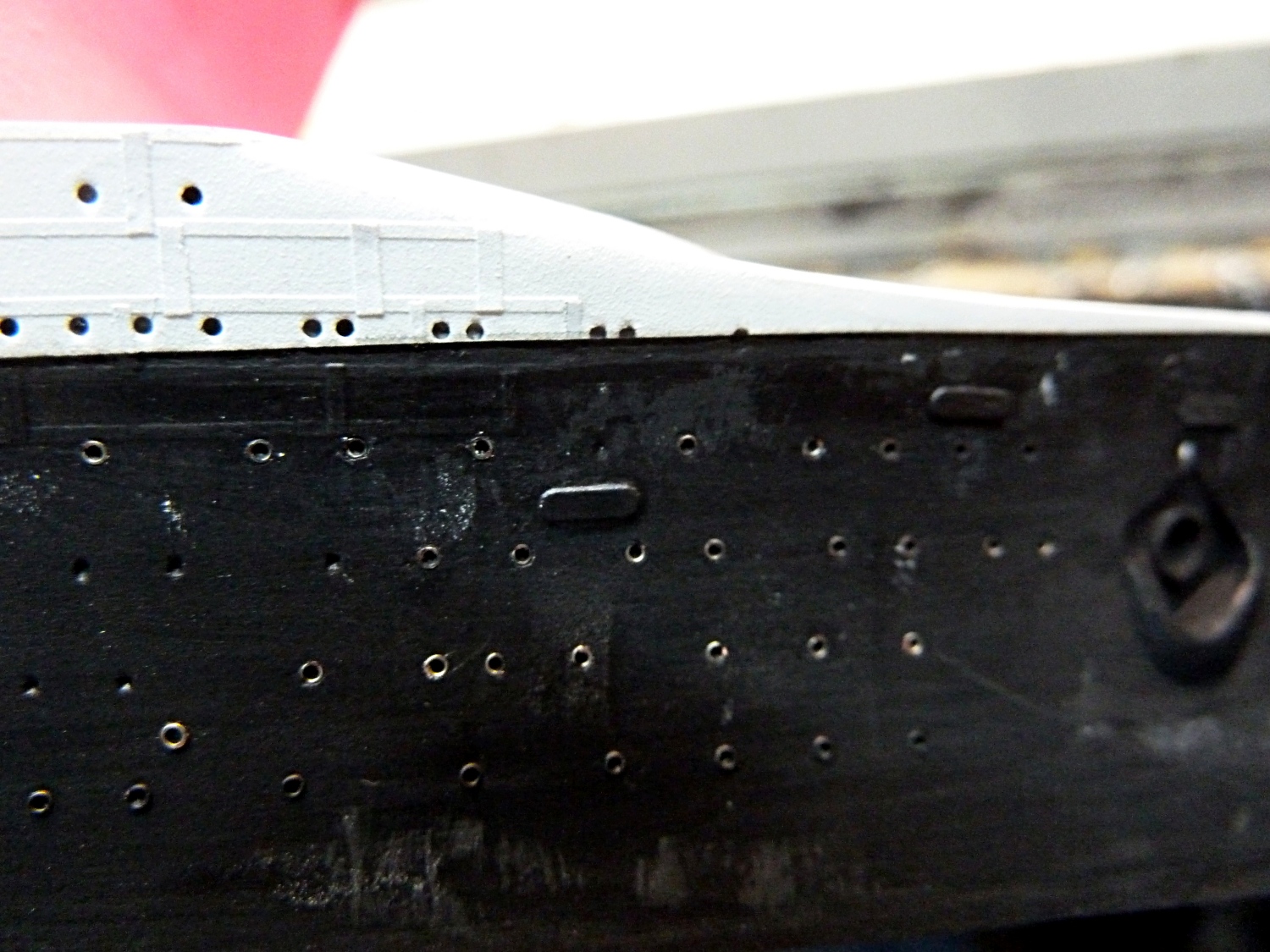

I have been trying out various ideas to 'circumvent ( pun is intended!) ( on the spare practice hull ! _)
the wretched square-cast-should-be-round(!) portholes.... ( a lot of ... arghhh! )
such as ,...

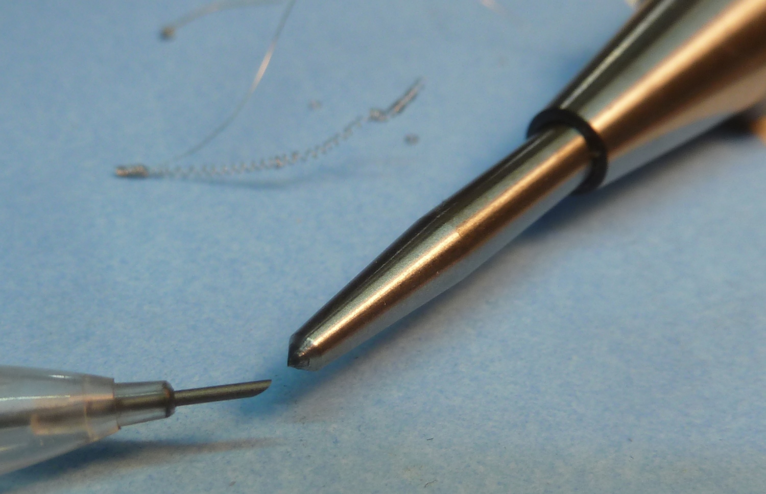

1) spinning a 3B pencil in the aperture --this works REALLY well when the aperture is round...
2) drilling with a larger drill bit ( portholes end up too large ==> looks toy-like ..)

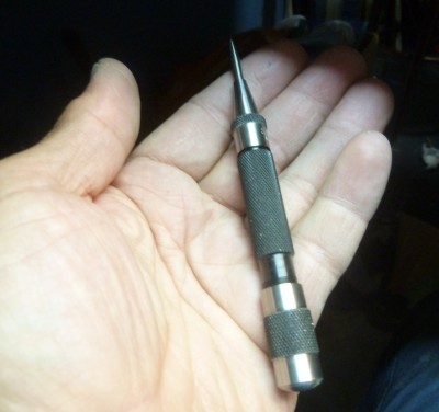

3) using a soft spring-loaded centre punch ( this did reform the resin very nicely and was totally repeatable
but the resulting dish was too large
==> Good for 1/350 though-- and for for future reference .
4) PE portholes--OK but on Normandie the portholes were flush
my findings are further down below
Truthfully-- Giving up was considered, but was a non-option--too much money and effort invested already
and I am not the the giving up-sort !

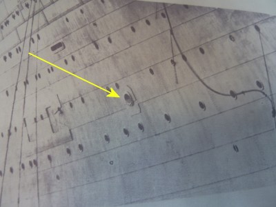

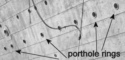

Previously I had established the lower row of portholes had surrounding protrusive rings

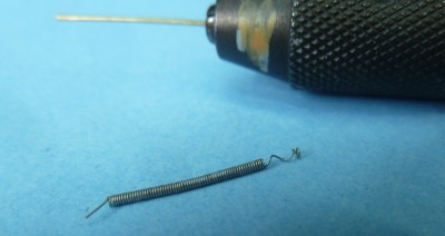

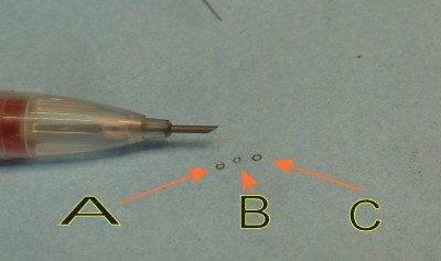

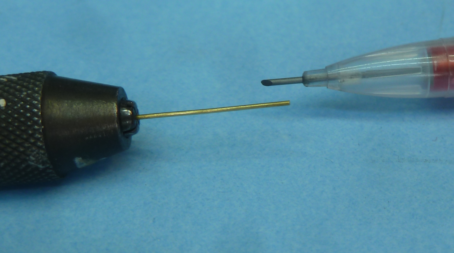

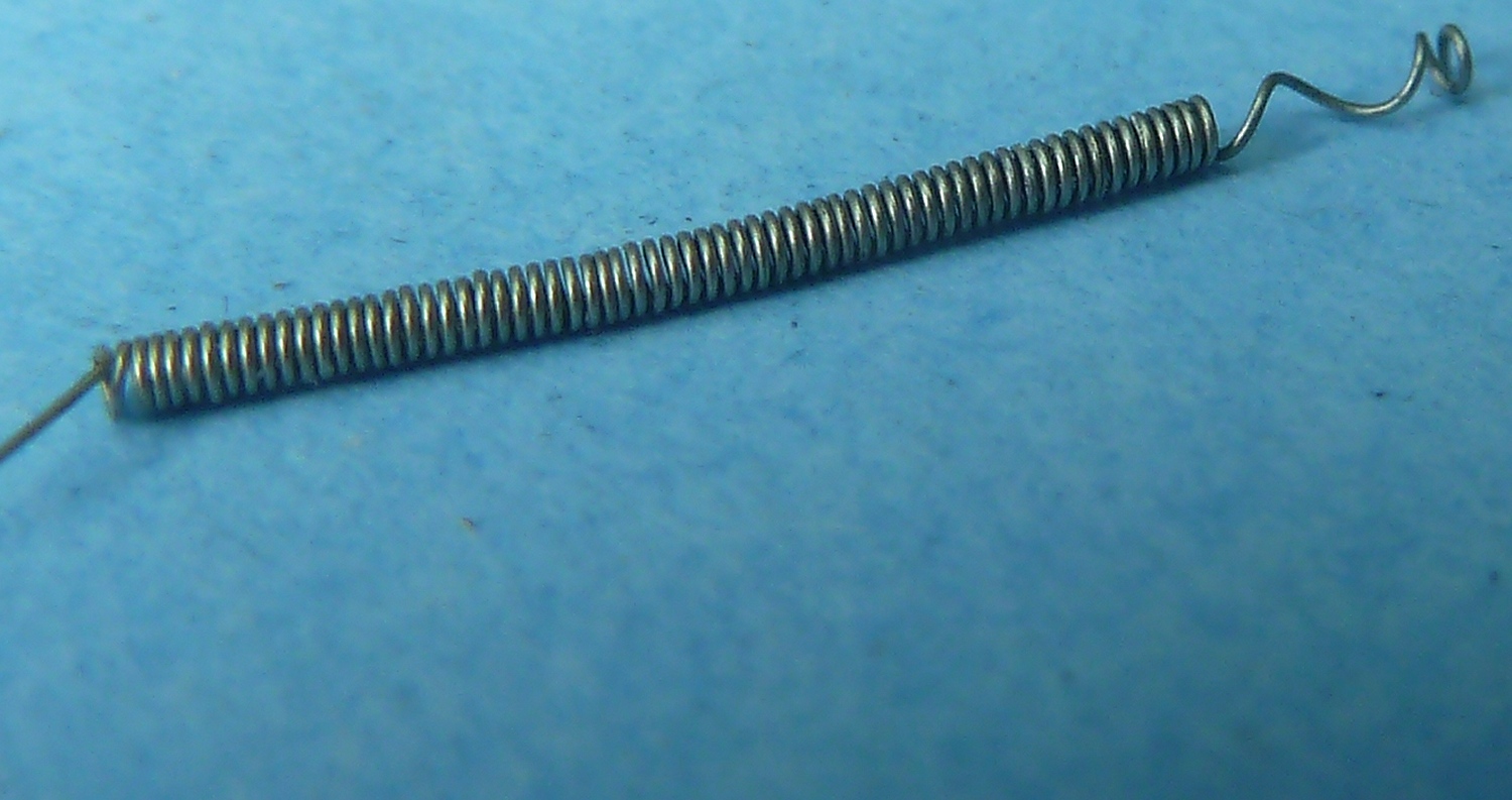

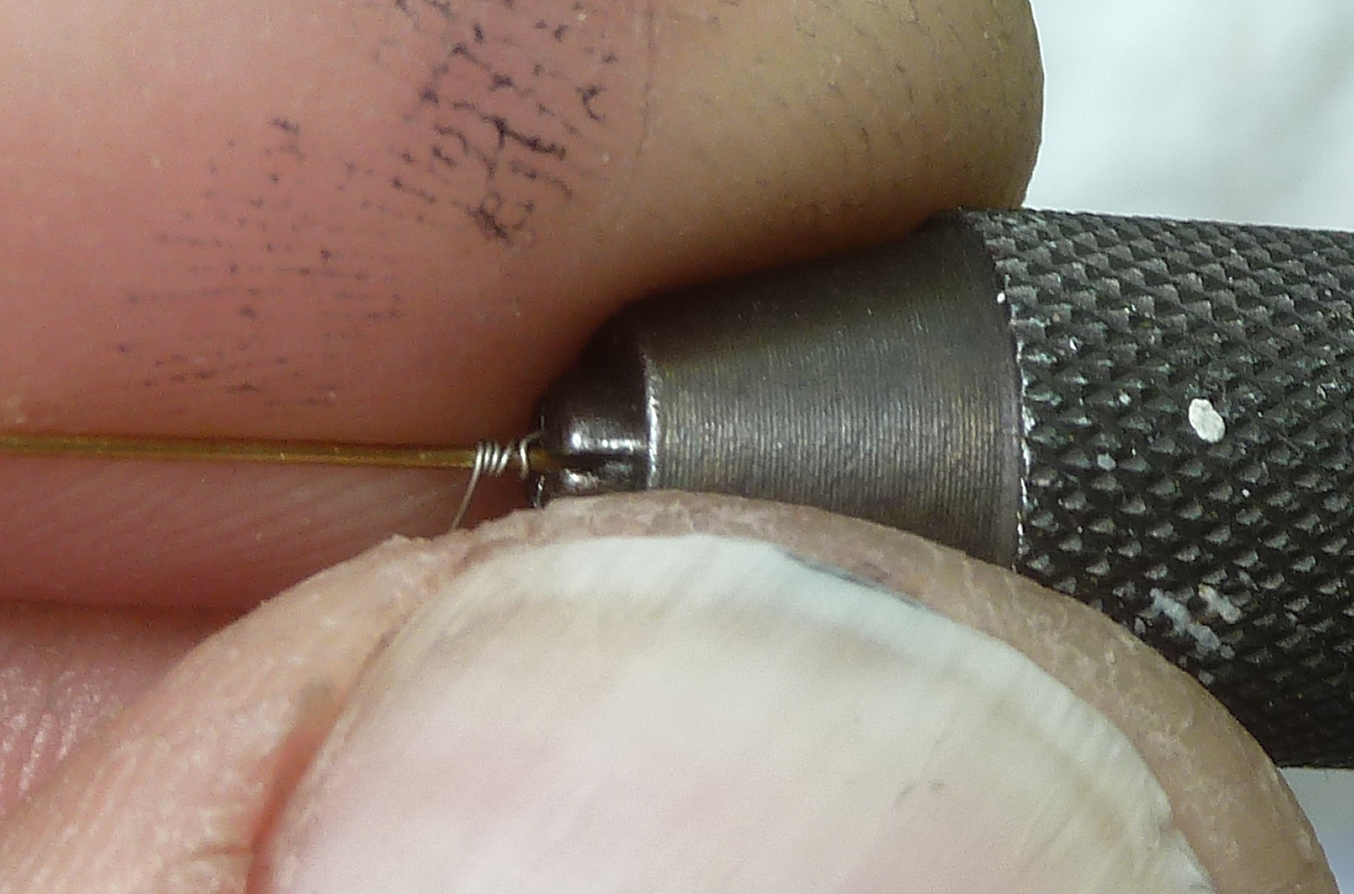

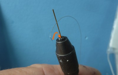

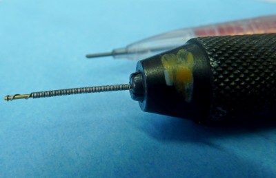

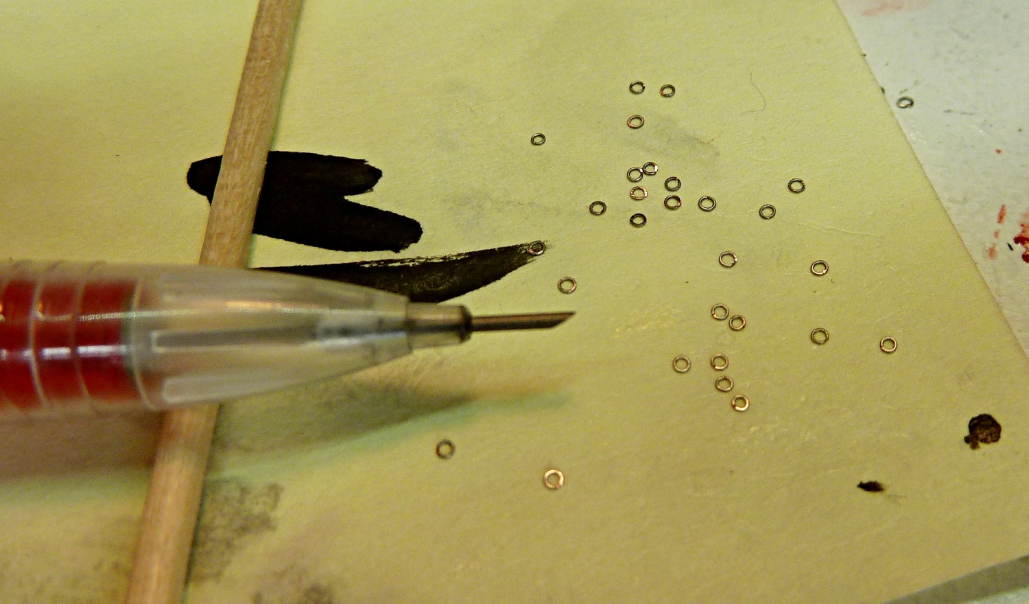

but first I had to make them ............using fine copper tinned wire
I have been asked many time show to do this-- so here is how goes with pictures!
1) select correct size rod/ tube that matches the INSIDE aperture of the porthole and insert into fine jaw pin-chuck
2) cut a short length 4 inches ( 100 mm) or so, insert a kink on the end --this will locate the wire in the pinchuck
3) pull wire gently and apply 1 x turn
4) rest the brass shaft on a finger to apply light pressure to wire and let finger act as an ' inclining' guide and turn the pinchuck slowly but firmly
5) when the end of the wire is reached stop turning and leave a small tail
6) slide off and admire your coil spring!
7) cut single turns off in the same place using a sharp blade on a hard surface
8) The resulting rings are flattened ( sandwich between metal blade on bladeand appl;y light pressure, tweaked to join in a ciurcular
==|> it is laborious, dull with a 50% plus waste rate (!! )
and so the protruding rings were applied to the row adjacent to the waterline-- these are of course over-scale-
- but when paint is applied they ' shrink in effect' an the effect is pleasing
( I did try thinner wire --but these rings proved very hard to keep round, to flatten or join -
-both stainless steel ( B)
and ( C ) copper wire were not a seffective as the tinned copper ( A)
and when painted --all but ' disappeared )

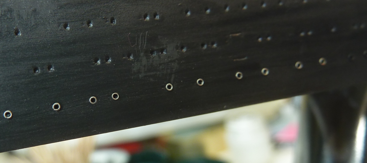

I made and added an overboard discharge(?) pipe vent
so this brings us full circle ( haha) back to the remaining portholes...
Using the afore mentioned spring loaded centre punch
the point of which created a shallow divot to make a repeatable and safe centre -
-as opposed to a catchy square edged hole..(!)
--into which I popped a 66Y drill bit
and then inserted my rings -- bedded on matt black paint-- so that they would sit flush
( using a sightly radiused end of tweezers handle ) so as to roll the eyes into the hole to sit dead flush
( the join in the circle sits at the top and will be disguised by the eyebrow above ( where applicable )
==> that's another brain-ache for later next week
the only drawback is that there are many hundreds of them to do...
(maybe I will see you in 2022) :cool_2:
when painted they left a nice sharp round hole
and look a long way superior to the original flawed offering...
brutally enlarged image alas... :whistle:
