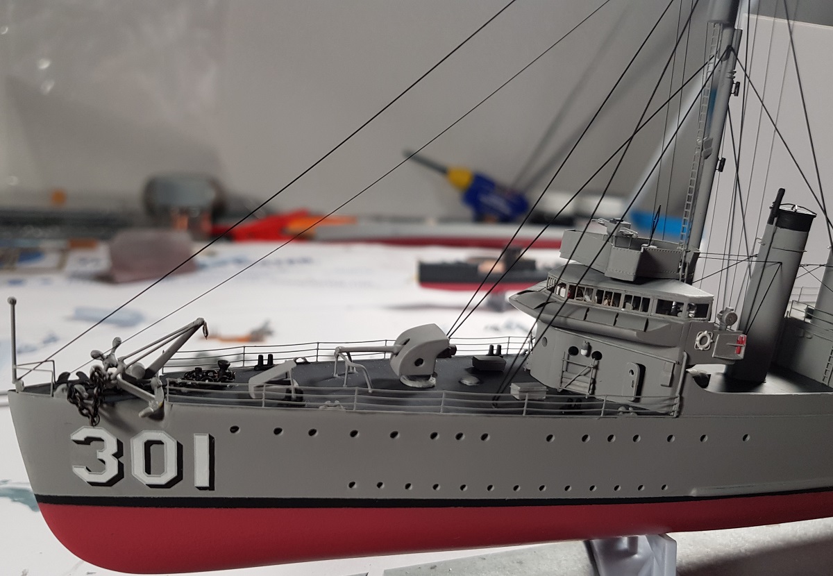

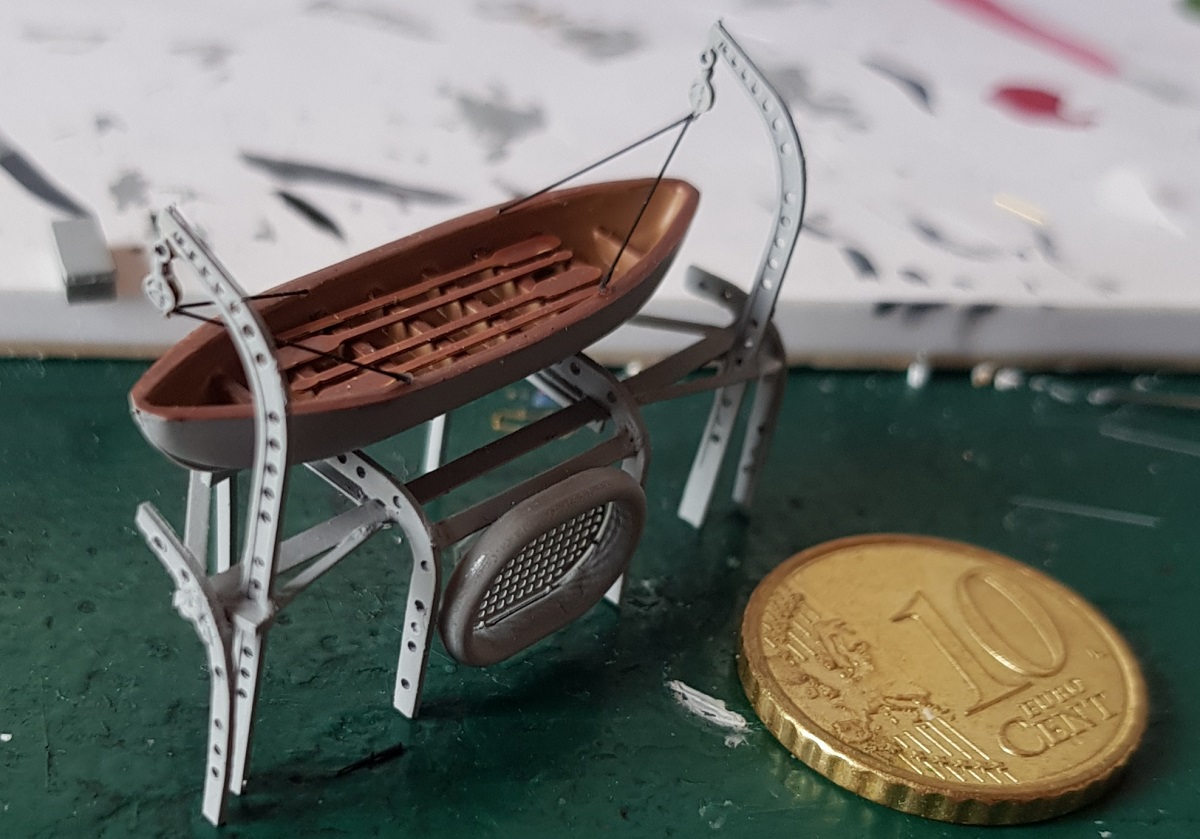

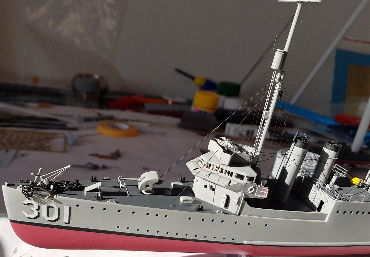

a little update...worked on my front gun...added some stuff on bow part....fixed stabilizer cables for main mast...added some more on davids....tiny stuff...but taking much time to do right

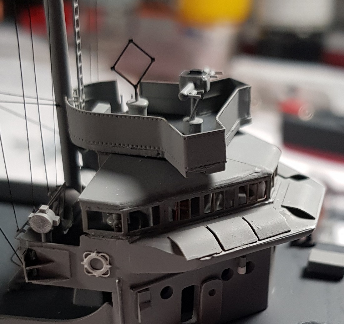

forgot...fly bridge also done...scratch build the range finder...to own idea as no picture of it found....with some logic and way more delicate than the one in kit

Most excellent work-- much clean and crisp detail,
it gives the model that ' edginess ' so often missing

had done some stuff also on rear...thought I'd show
also added now railings on the bow and some more fixing/securing cables of main mast
bow is now almost done

Hi there Triumph and all,
Excellent update. Your rigging is awesome, and as I have built the same model, same scale, I know what garden you are getting into.
Nice going, and best regards from this side,

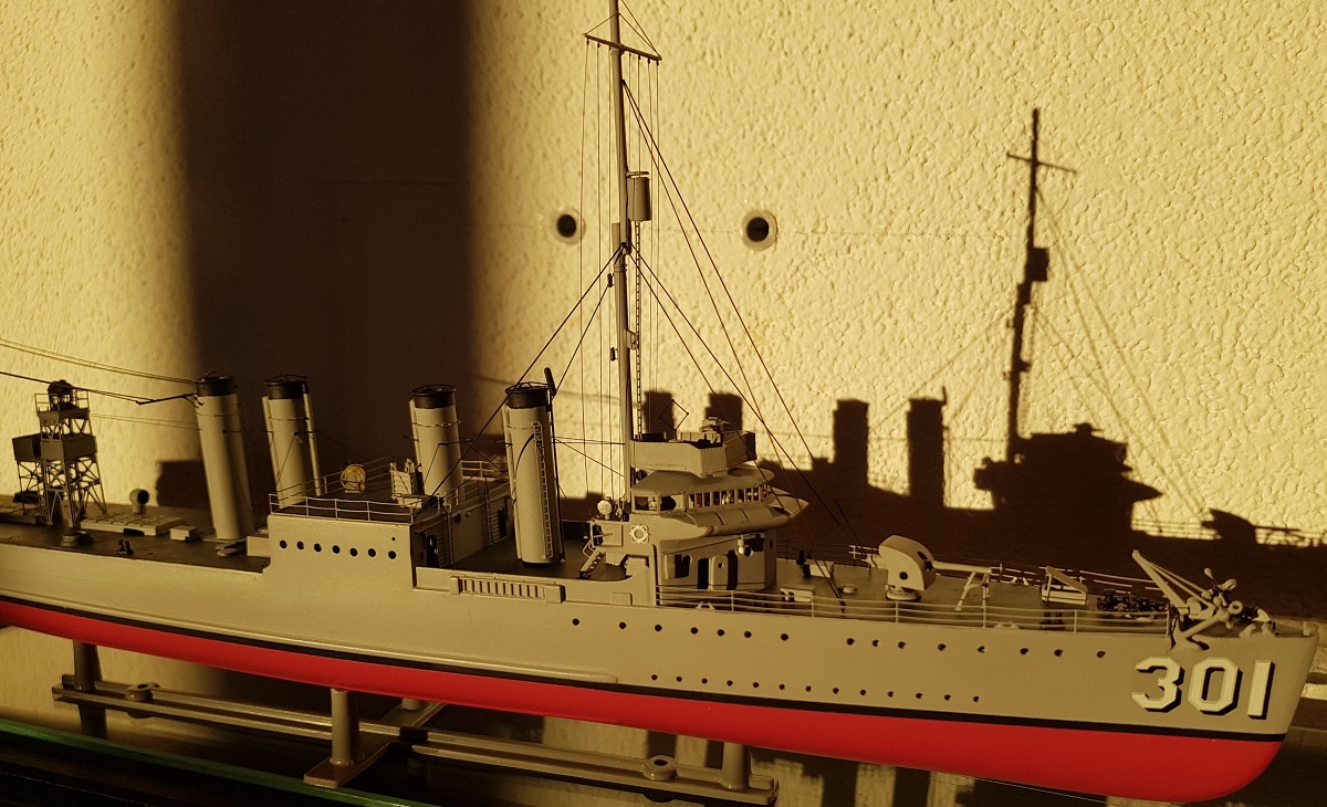

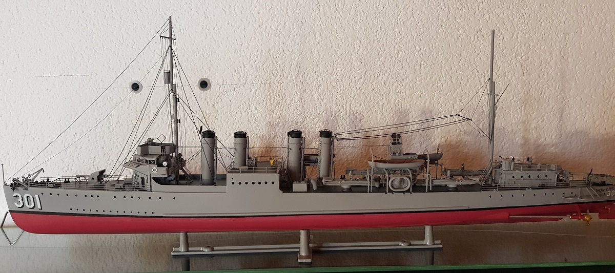

did some more finishing touches.... here a few detailed pics and a full...well..almost full side view
hope you enjoy them...she is closing end ...now need to think how I'm gonna fix her

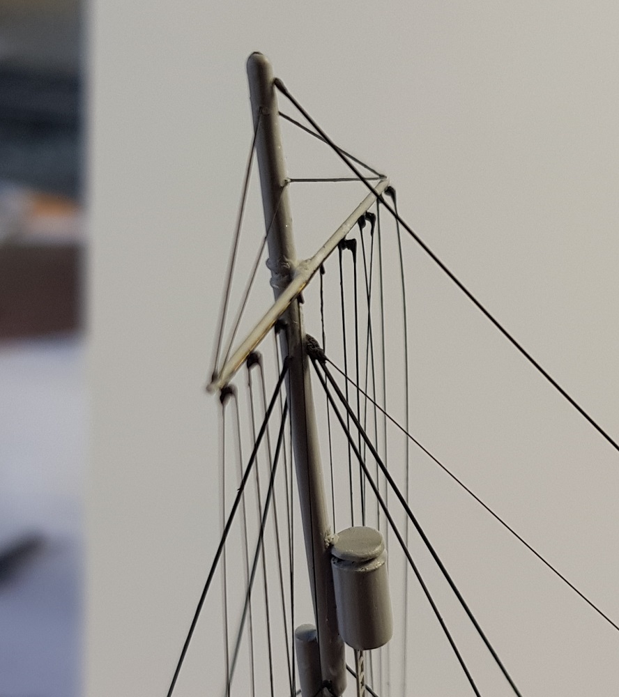

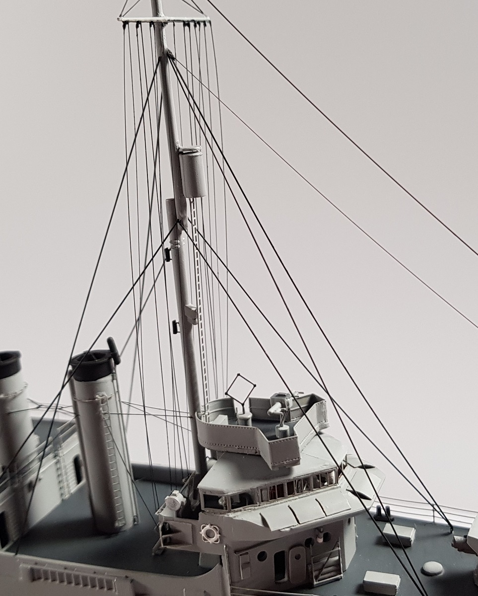

I got spanked from Willie.... he
.so...... I had to do the second lines for the flag ropes... now they can function

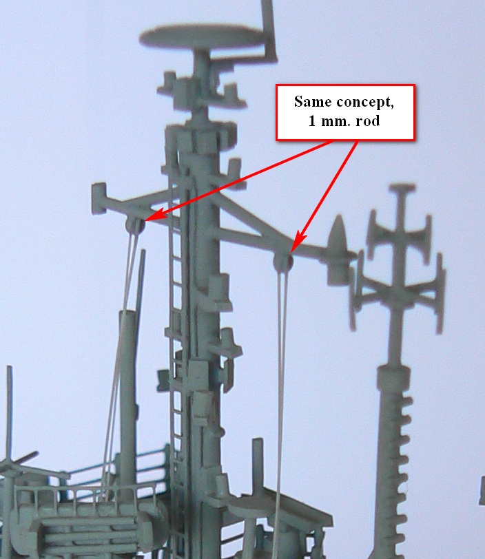

Hi there Triumph68 and all friends,
No spanking at all. Only a wish of being useful after the efforts I can see behind this model.

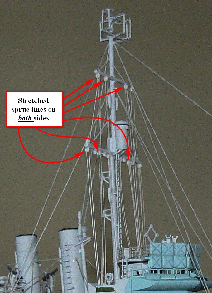

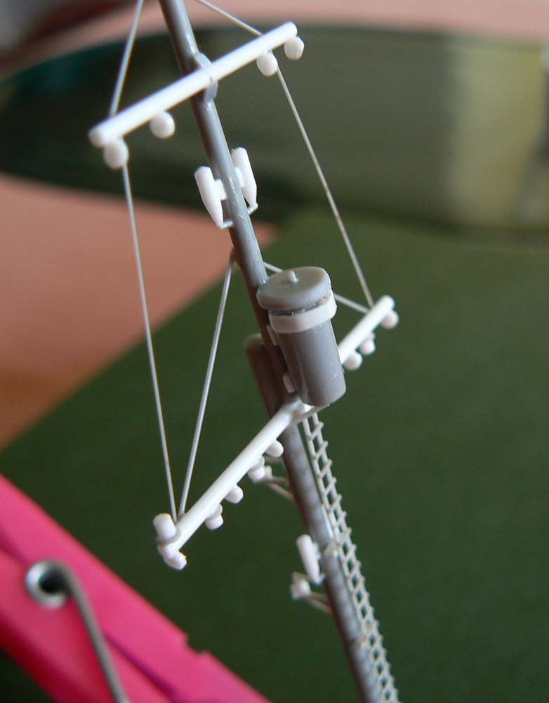

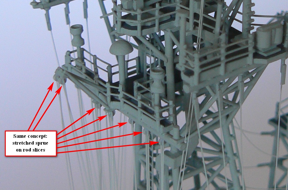

They won`t, as they are not placed in the same wheel, but to solve this problem is again the easiest thing ever: cut thin slices of rod (I used Evergreen, but any rod will be OK), and set them in place. This : Then add lines of stretched sprue, and glue them on both sides of the rod slices, only on the top, as the loose ends can be inserted in the bars of the flag boxes. And that�s all. Done. This is exactly Revell flushdecker 1/240 scale, your same model: Second method is to make sets of rod slices and stretched sprue lines, and set them in place when finished.
Even at this relatively big scale, this easy solution will go virtually unnoticed, and the results are very convincing. This is a OHP frigate at 1/300., and the effect is again very convincing: I hope this can be of some use, and very best regards from this side,

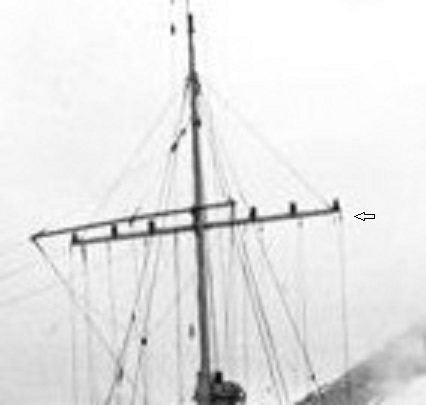

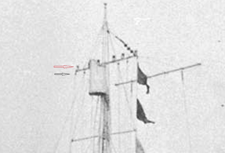

I'll make a closer pic on top part so you can see...mine are 2 on same wheel...only my wheels are way smaller than yours, the wheels used for this purpose on real ships are very small..to me yours are out of scale ..way too big.
on real ship pictures you hardly see them so small they are, as they don't need to carry heavy weight.
this picture is about max they go

this leads me to a since long for me open question...if the black arrow are the wheels for the flag lines...what are the 6 stuff op top indicated with red arrow...they are not above the flag top wheels
anybody knows?

here's my close up....did in the mean some more cleaning on it but you can see I also put a rod...actualy a stretched spru between the 2 lines

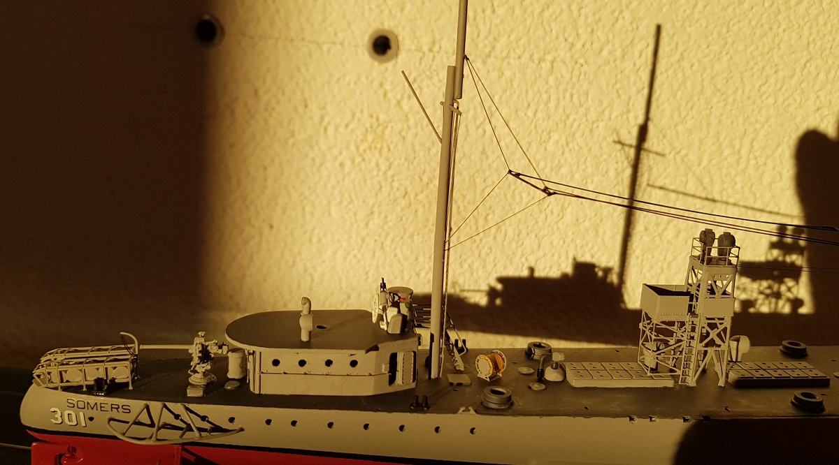

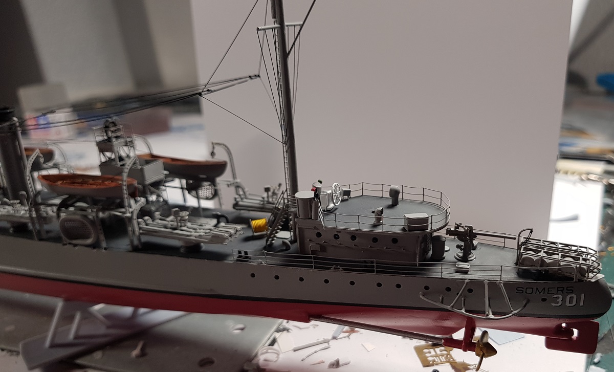

worked a little on rear as well.... mainly missing...2 middelcastle 4" guns....a few extra's and some more center riggings
lets say she is 99.3% done
btw...I used a bigger wheel on this rear flag pole ( on witch you find the stars and stripes) as she also sometimes had to do lifting service for rear castle

I hate to nitpick at this point in your build, but I'm pretty sure that USS SOMERS (DD-301) had a "Poole" 3-in/23cal gun and not a 3-in/50cal gun installed on the fantail as you have.
I have a lot of images of the Flush-Deckers and they all had the smaller Poole 3-in/23cal gun or similar guns (as completed). And that includes the two images of SOMERS I do have. None carried the 3-in/50cal guns until the 1940-41 ASW mod rearming with six 3-in/50cal guns replacing the four 4-in guns and two of the torpedo tubes banks.
... http://www.navweaps.com/Weapons/WNUS_3-23_mk13.php ...
