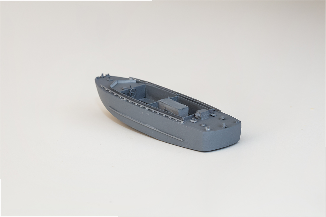

Other progress: The "P" boat, roughed out and primed the hull. This boat, also a 36 footer from the Swamps of Louisiana was lighter and stronger than the LCVP and could be lowered loaded. This was the "command" boat used by the boat officer to heard his cats.

Roughing out the P Boat. LCP (L) command boat. I think, but don't know for this use that the forward .30 cal's were eliminated. Command boat for the Assault force and probably also mail boat and Captain's Gig

P Boat in primer, skeg, prop and rudder not yet added.
Thanks to Hank for finding a good drawing for me!

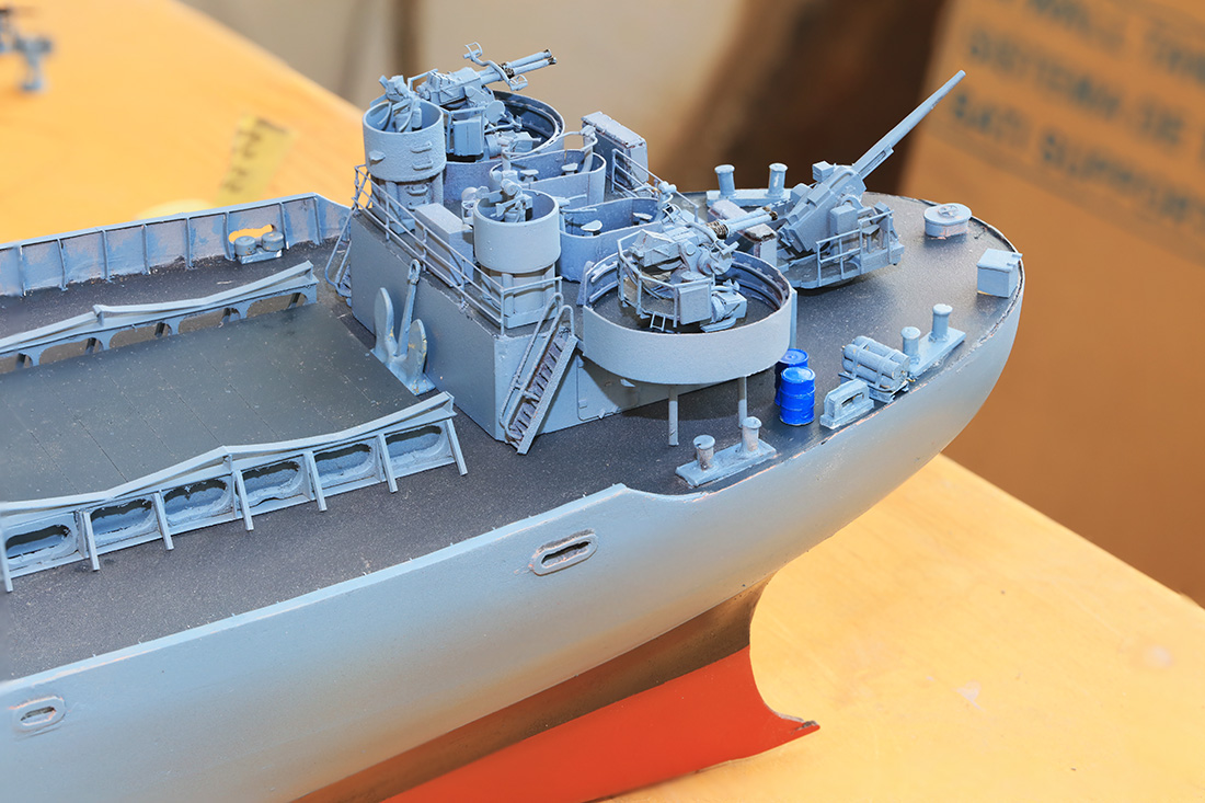

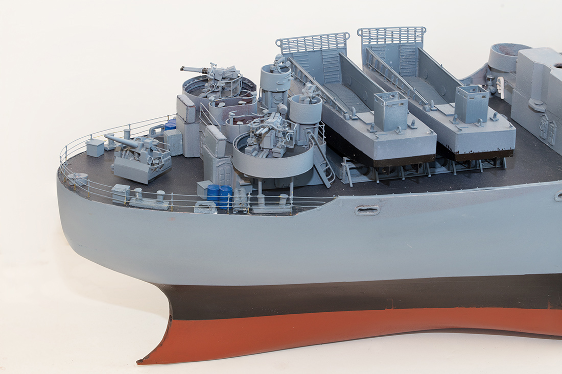

Current progress on the fantail. Nothing will be glued down till the lifelines are completed.

Hi,Tom!
It's wonderful especially arms at the stearn.
Regards; Song
Regards; Song

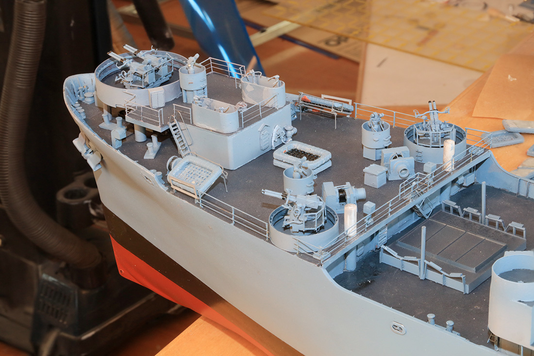

Current progress stern, pipe rail added.

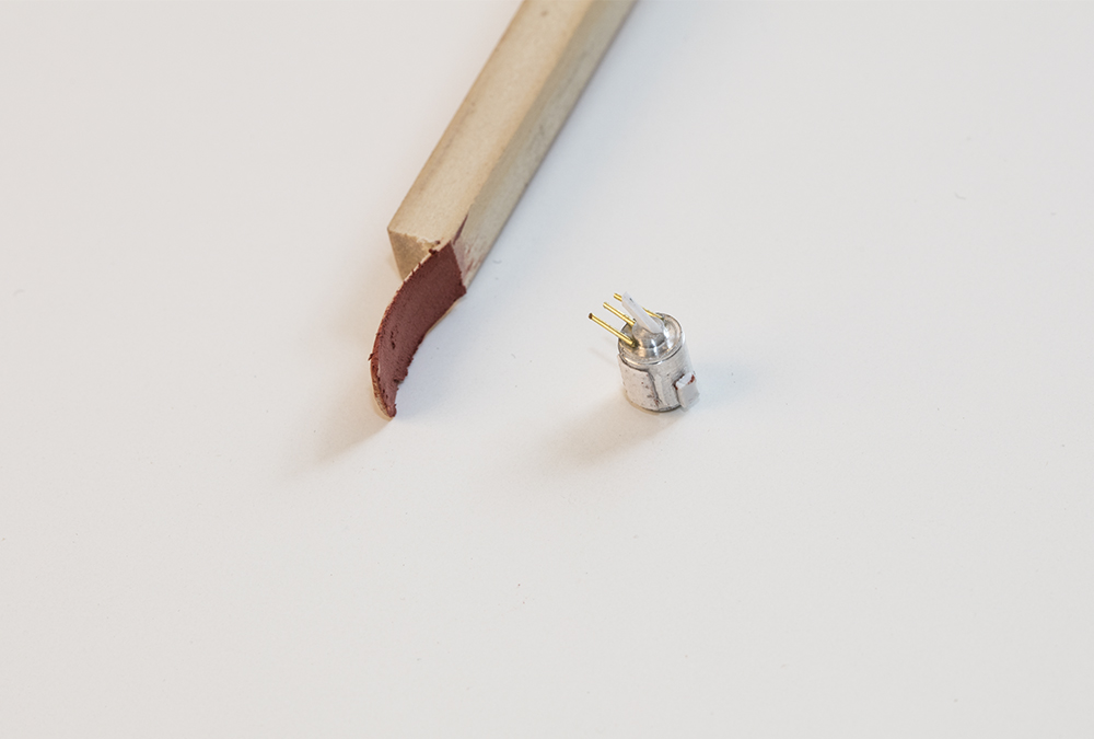

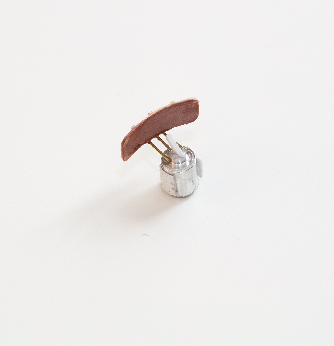

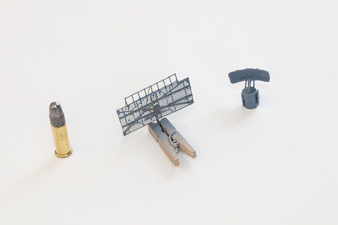

SG Radar for the foremast. Housing turned from aluminum, antenna is carved from basswood.
- Posts: 5068
Re: APA project
To make the antenna I sawed the front contour, hollowed, sawed the back contour and trimmed. It was easier to use some putty on the front to smooth because of the small concave surface.

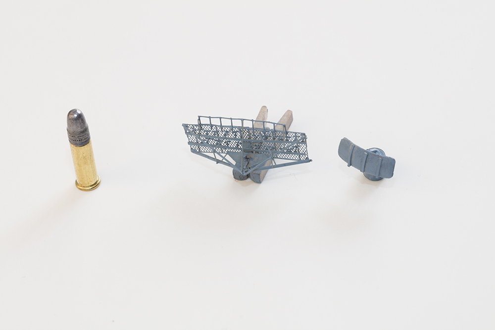

Re: APA project
SC-2 for the Main Mast and SG for the Fore Mast.
