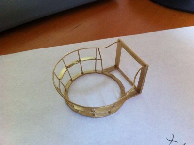

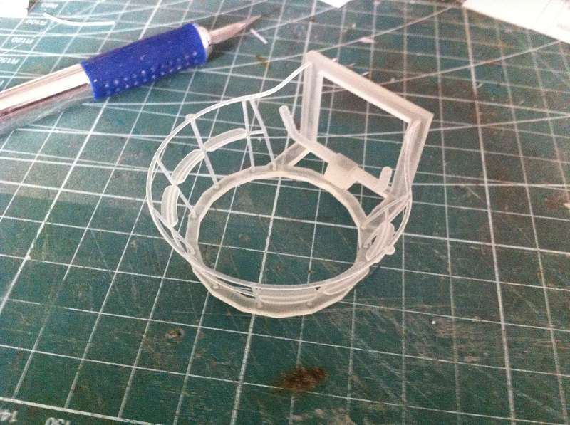

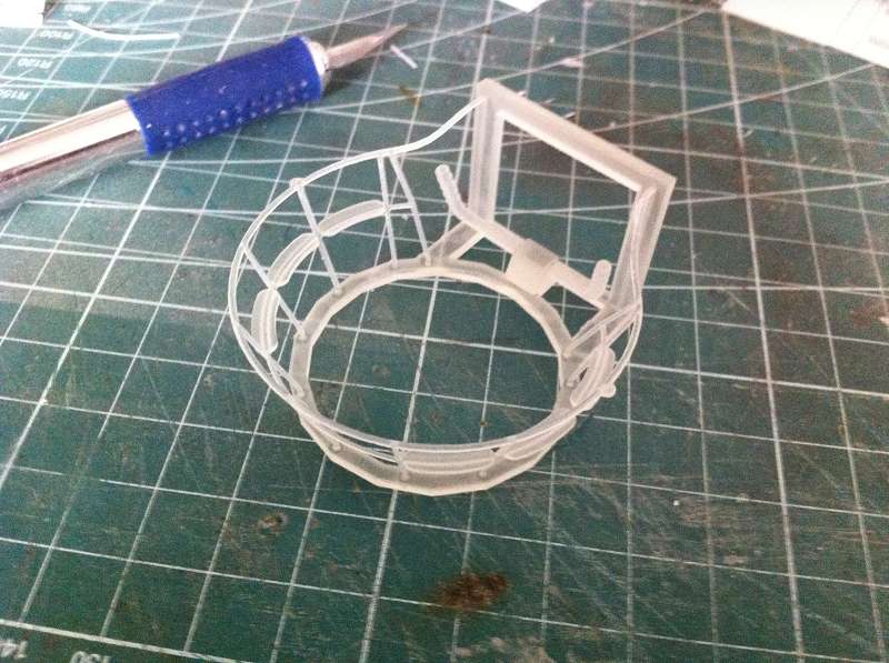

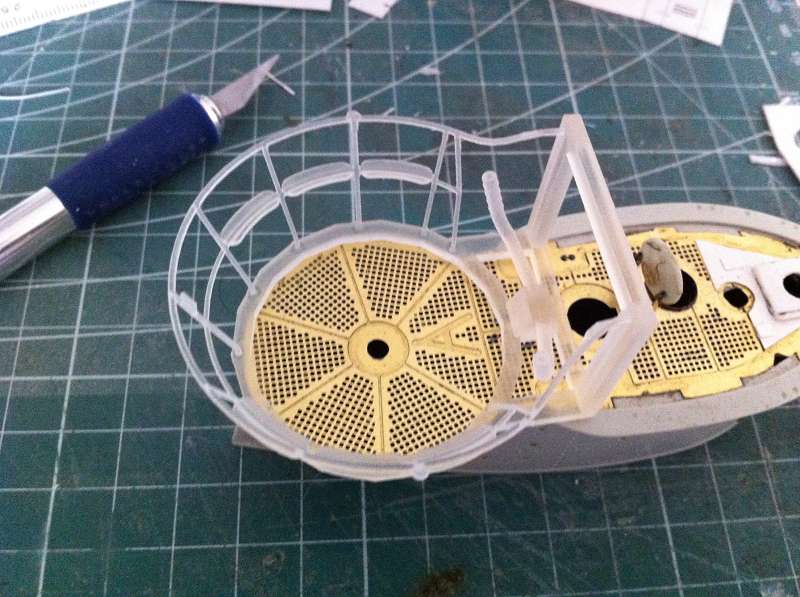

I dont know where i should post this. So i post this here. I am the biggest soldering noob out there. I have searched a long long time for a replachement of the Wintergarten for the Revell 05015 - 1/72 VIIC UBoot Kit. I was not lucky. I recently discovered the possibilities of 3D printing. Thats why i created a "Wintergarten" in a 3d program and sent it to print, and i was successfull.
It looks amazing very thin and fragile. For those of you who also want to replace the 2 piece thick one from Revell here is the link to order one for yourself. I also put the 2 Isolators for the turret back side on it.
http://www.shapeways.com/product/GSVNY5 ... d=56258206
here are some pictures of it:
I am still waiting for the brass Version of it.
P.S. I am not a Company. I only want to share my efforts to build a better Model.

Nice work! I'm working with a friend on some 3D printed parts for PT Boats. How are you finding the smoothness of the print? Are you seeing any strata anywhere? I'm interested to see it printed in brass as well. This is the future of modeling. Great idea!
PS. Please share the brass print with us as well. Would love to see that.
Dave

Thanksdavidwaples wrote:Nice work!
its very smooth. No strata visible but you can slightly feel them. I am confident that this will be no Problem with primer and paint. It's printed in FUD (Fine Ultra Detail) Material, but with the new FXD (Fine Extreme Detail) Material from shapeways it should be possible to increase the layer count, to get a more smoother surface. But also an increased Price.davidwaples wrote:How are you finding the smoothness of the print? Are you seeing any strata anywhere? I'm interested to see it printed in brass as well. This is the future of modeling. Great idea!
Dave
Yes i will post the brass Version to, but its still in production. The brass Version also lacks the very small parts like the Antenna cable holder and the holder for the Torbedo reload linkage. but these parts can be added easely later. And it don't have the Isolators, because it would be too expensive to add them.
Regards from Gemany
Thomas

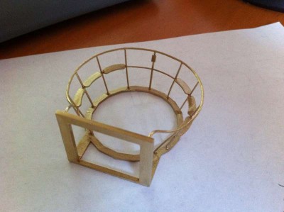

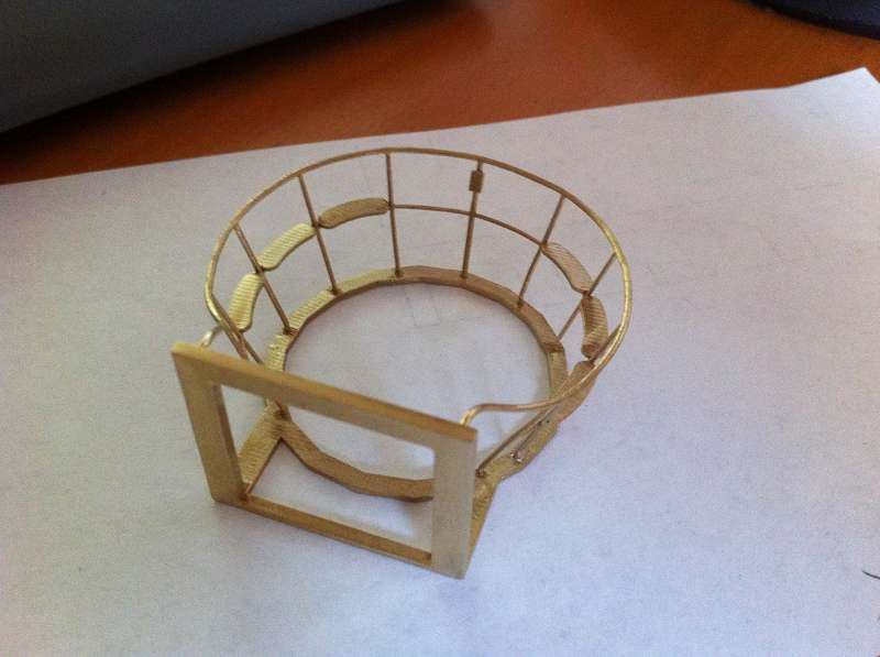

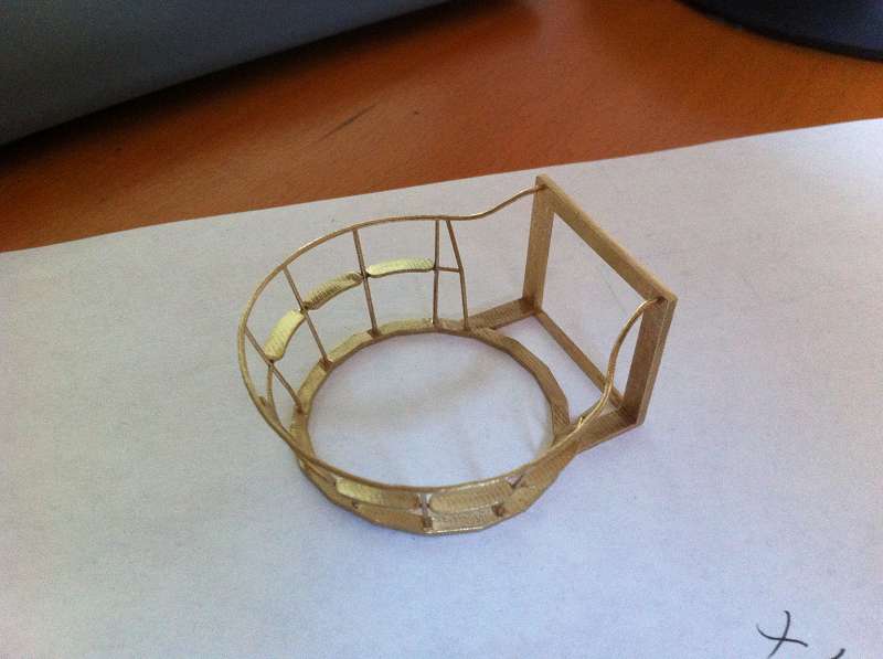

Hi Dave today i received the brass Print. I am satisfied with the result. It's a very good print. It's very stable and can be bended a little.davidwaples wrote:PS. Please share the brass print with us as well. Would love to see that.
Dave
here are the Pictures of it.
Greetings from Germany
Thomas
JCRAY
- Posts: 633
- Joined: Sun Feb 08, 2009 3:18 pm
- Location: Palm Beach, Fla
Re: Calling all DKM U-boat Type VII fans
Stunning! Thanks for showing us. New world of modeling!

That's amazing Thomas! Are you going to release the first rendering in the new higher resolution offering? I would like to order a set and would like to try that newer printing option.
Thanks for sharing your work
Dave

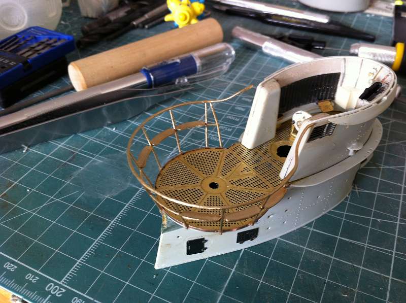

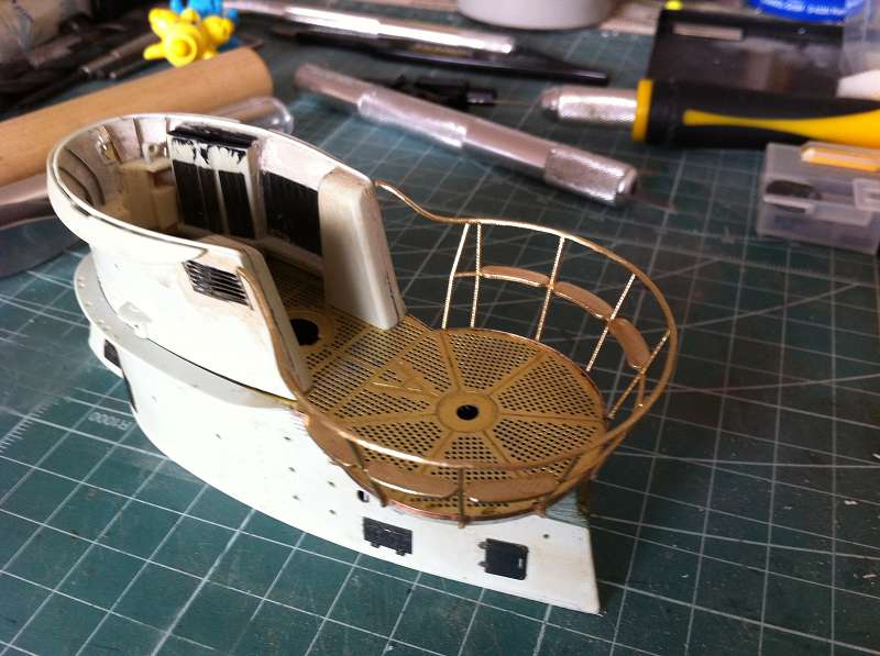

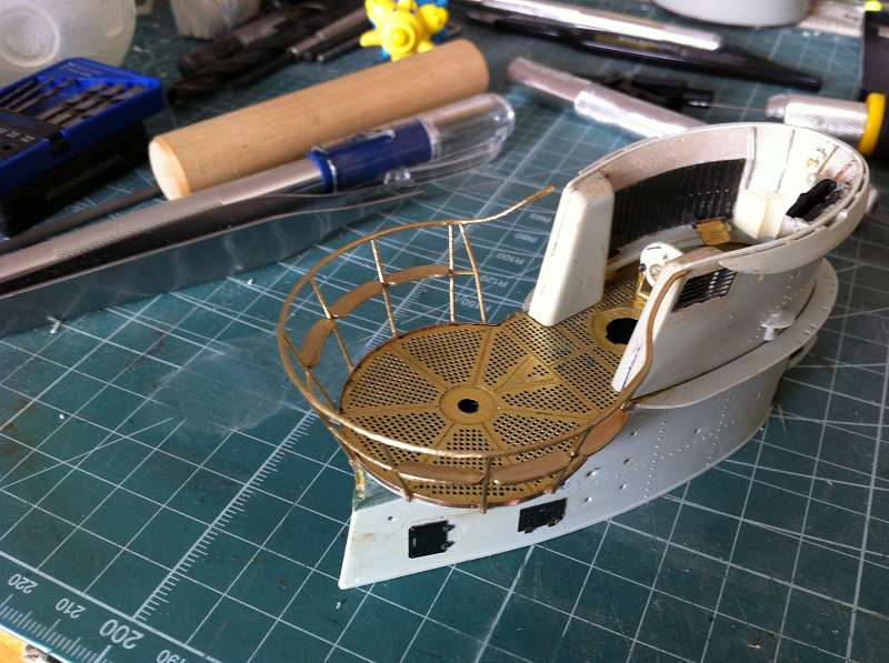

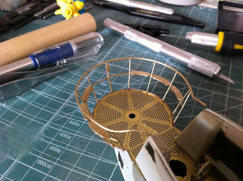

Today i have cutted the brass one from the Frame and glued him on the conning Tower. And here is the Result.
i like it. And it fits very well.
Regards from Germany
Thomas

Does the bottom ring on the printed one mount on the gun deck or do you cut the rails off of it?
kawubke
- Posts: 38
- Joined: Thu Dec 05, 2013 4:59 am
the Ring is only for Protection against breaking. The Wintergarten needs to be cutted off from it.krgf15 wrote:Does the bottom ring on the printed one mount on the gun deck or do you cut the rails off of it?
