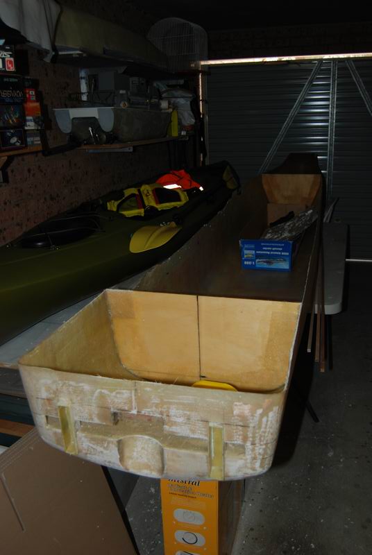

Latest update
All the foam is now gone but now have a new problem. While the foam was in place the hull was quite strong but when I pulled out all the foam the ship almost folded in half. The hull between the bulkheads which is 2.7meters long has very little support. I have to put 2 layers of fiberglass on the inside before I can do anymore on the ship. The stringers I bought for the ship are not strong enough to hold the hull in place. Once these 2 things are done I have to save money for 4 shafts and props for my model.
Latest photo:
Anyway I can start to work on other parts of the ship. Maybe even give the superstructure a go.

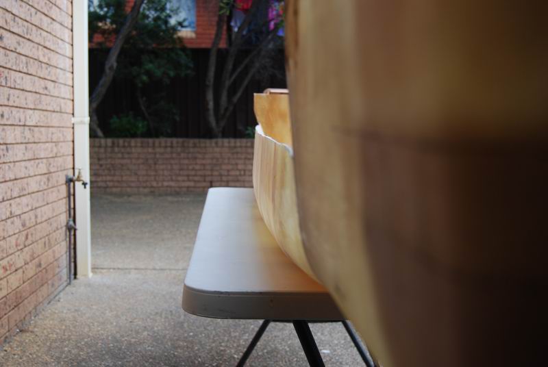

I think I may have an idea to keep the deck straight but I will only find out when I get closer to putting the deck on. If the hanger deck is straight then all should be well. Keeping my fingers crossed.
A few years back I was building a 1/350 Spurance model at a club and a person walked up to me, telling me what a crap model it was due to a warped deck. I told him to watch me glue my deck down in front of him. When it was done he couldn't believe how simple I made it look and yes it was DEAD straight! Mind you I stuffed up attaching my 1/350 deck to the Admiral Kuznetsov from Trumpeter, but managed to get it right in the end with a good twist.
Attaching a dead straight flight deck always going to make its own problems and in my case I also have a ski jump. So when I get there I will be very careful not to stuff it up since many people will be glad to point out a warped deck. I'm seriously thinking of having smaller decks locked together this way I hope to make it easier but that is a long way off. Many things can happen between now and then.

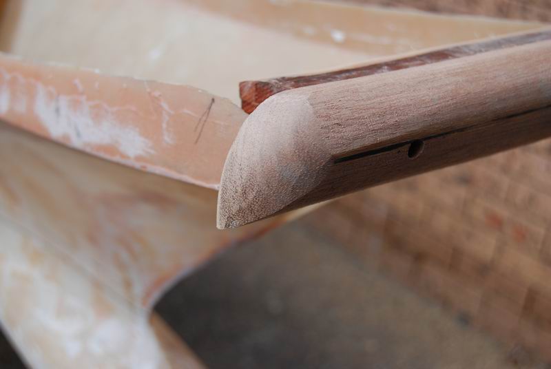

Hiya all, well its been a while since my last posts here and if you remember I had a problem with a thin mid hull. I have kinda fixed this problem but in the process the stern bulkhead has a warp in the deck line.
I have fixed this problem by putting a false deck in place. (No pictures yet)
I've also done some work on the bow

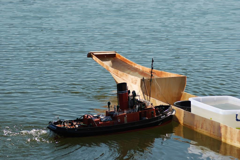

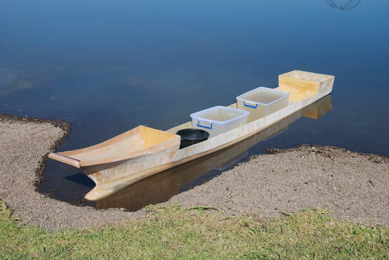

A few days ago I bit the bullet so to speak and try to find out how much weight my model will need. I guessed about 150kgs about last December. As it turned out I had a friend sit in the model. He weighs 62kgs
What I realized is that I going to need heaps of weight to get it to sit on the water line. 3 days later I went back and put water containers into my model.
These 2 buckets held 120kgs between the 2 of them plus 2 of the black bucket poured into the bow section. Making a total weight of water about 180kgs.
I pushed the model out a few times and each time she seamed to turn one direction. Not sure if this will happen once the rudders are connected but if the problem still is there when the ship is under RC then I will put a false rudder (Kiel) near the bow to correct the problem.
While pushing the model out on the 3rd time the line broke with my model stuck in the middle of the lake. Lucky Joe and his tug arrived to push me in.

You must remember I still have alot of building to do which intern will reduce the water needed. This was just a test in the water with NO batteries or motors. The weight of water should come down by maybe half (I hope), only time and building will tell. But it does look great on the water don't it. :cool_2:
