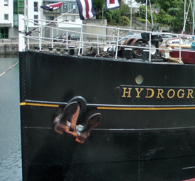

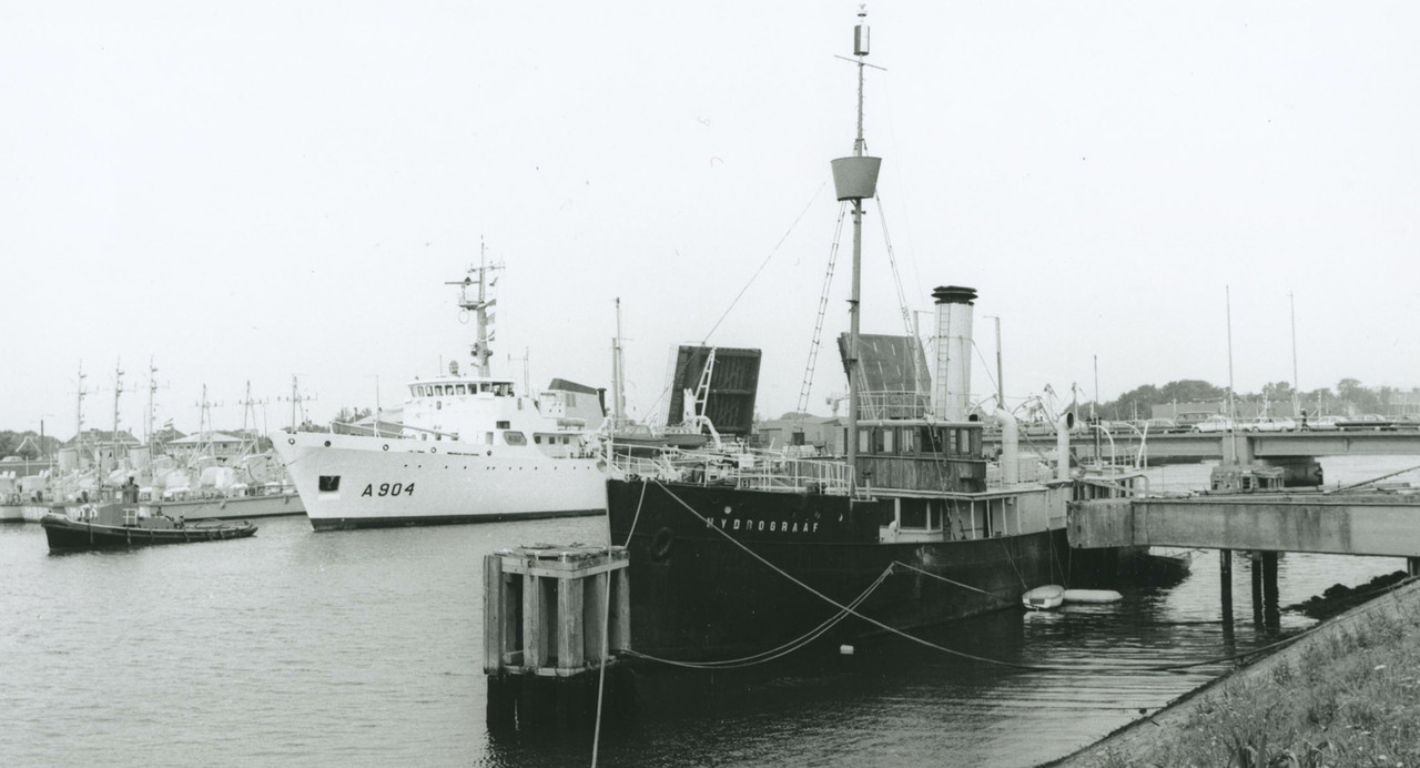

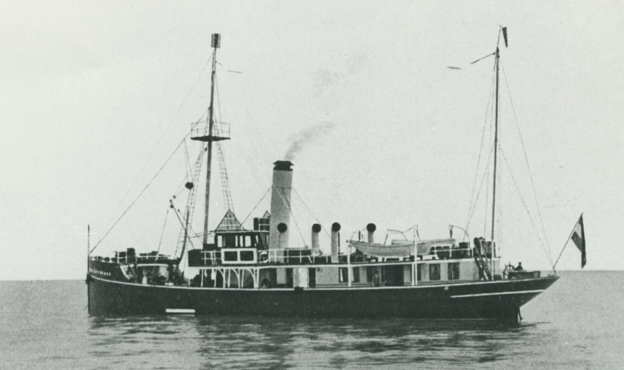

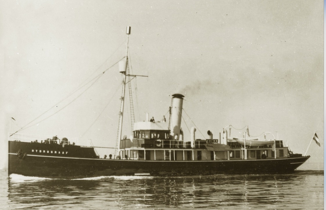

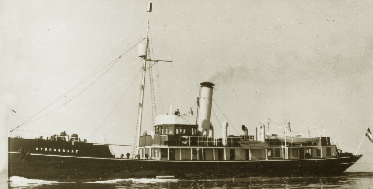

Some pictures from the beginning of the 20th century where the ship is more or less in its original configuration.
Thanks to my friend Roland for finding these photos in very good definition.

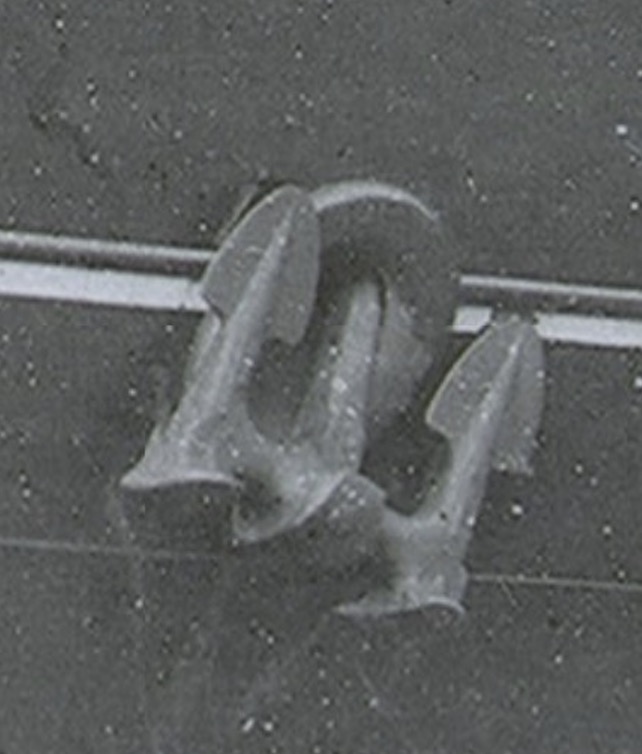

On this HD photo, I have the original shape of the anchor which has nothing to do with the current one.

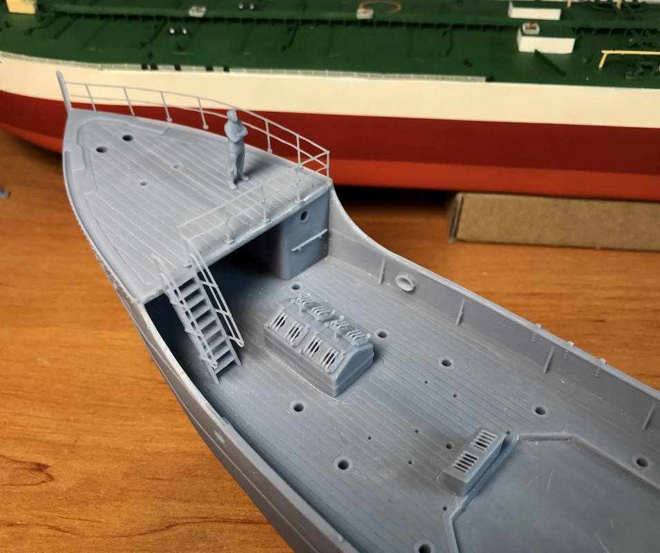

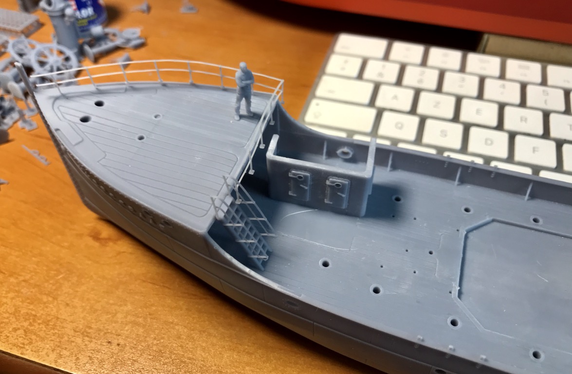

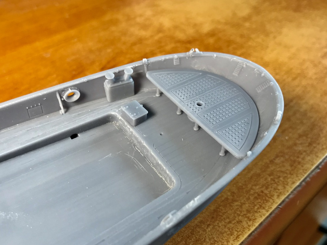

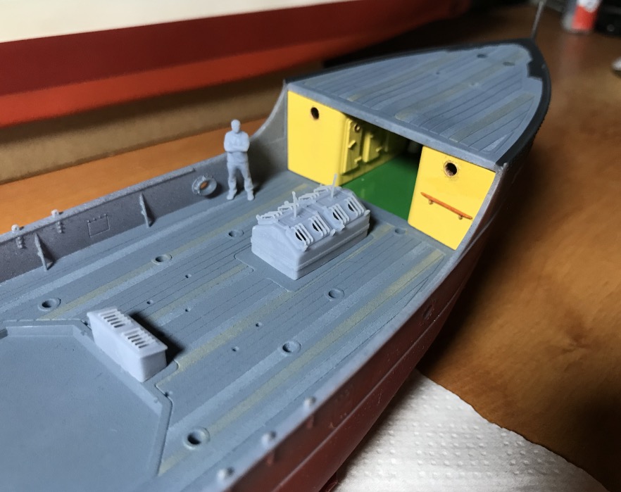

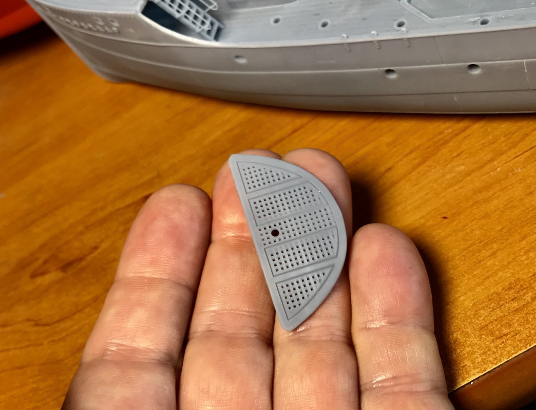

3D printing of the deck equipment.

Testing the deck elements on the ship.

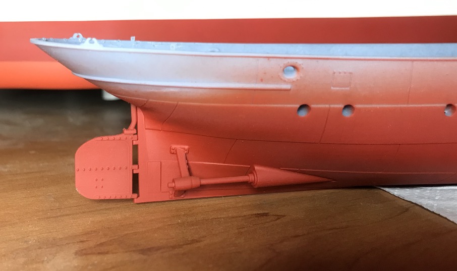

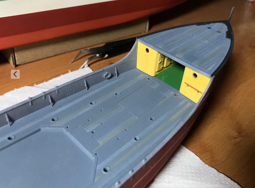

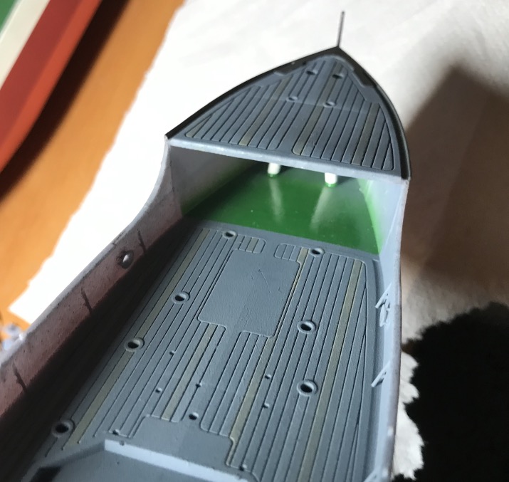

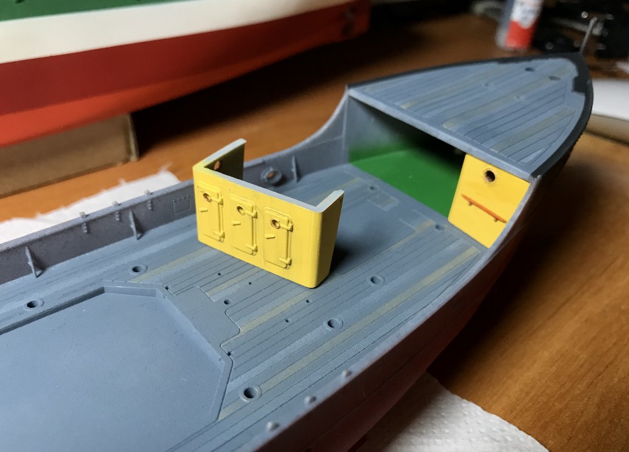

I have started a bit of painting. I made a yellow that roughly matches from an old can of Heller 9027 paint, which I lightened a bit with Revell 05 off-white.
Otherwise Revell SM 364 green. And three shades for the deck. Quite a lot of masking as everything is done in the air.
The matte antifouling Humbrol Matte 60 has been varnished with matte to stabilise it.
Nothing is glued. I'm painting the black hull tomorrow probably.

Always satisfying to see real world parts evolve into a scale ship!

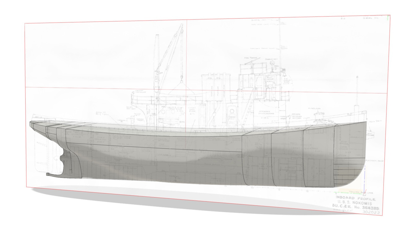

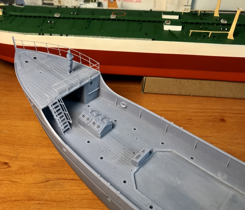

This software can be very temperamental, but after a year and a half of living together, almost every day, a calm climate has developed between us. We manage to get out of the hulls which is the most complicated thing.
Effectively Tom, at the end of a word we are happy to be back in the real world after many hours of virtual work.
I make a short pose on the Hydrograaf, I work on a tug boat the USS Nokomis for my friend Alain Nova73 who is going to make a part of one of his remarkable diorama. I'm only doing the hull. Not easy because I don't really have the plans of the hull, only partially.
So it will be far from perfect, but for waterline 1:350 it will be fine.
I'm a bit like a musician without a score.

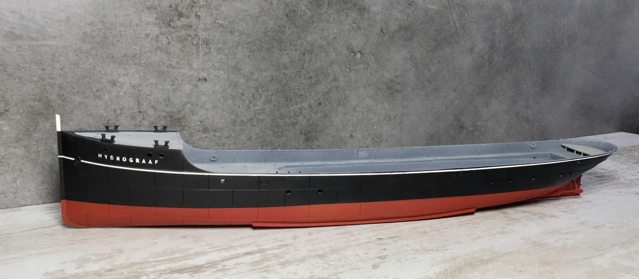

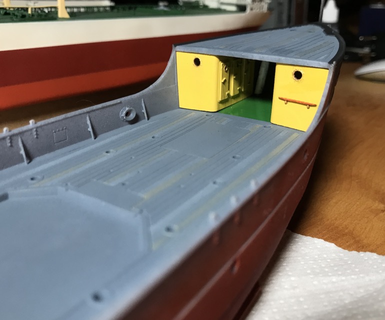

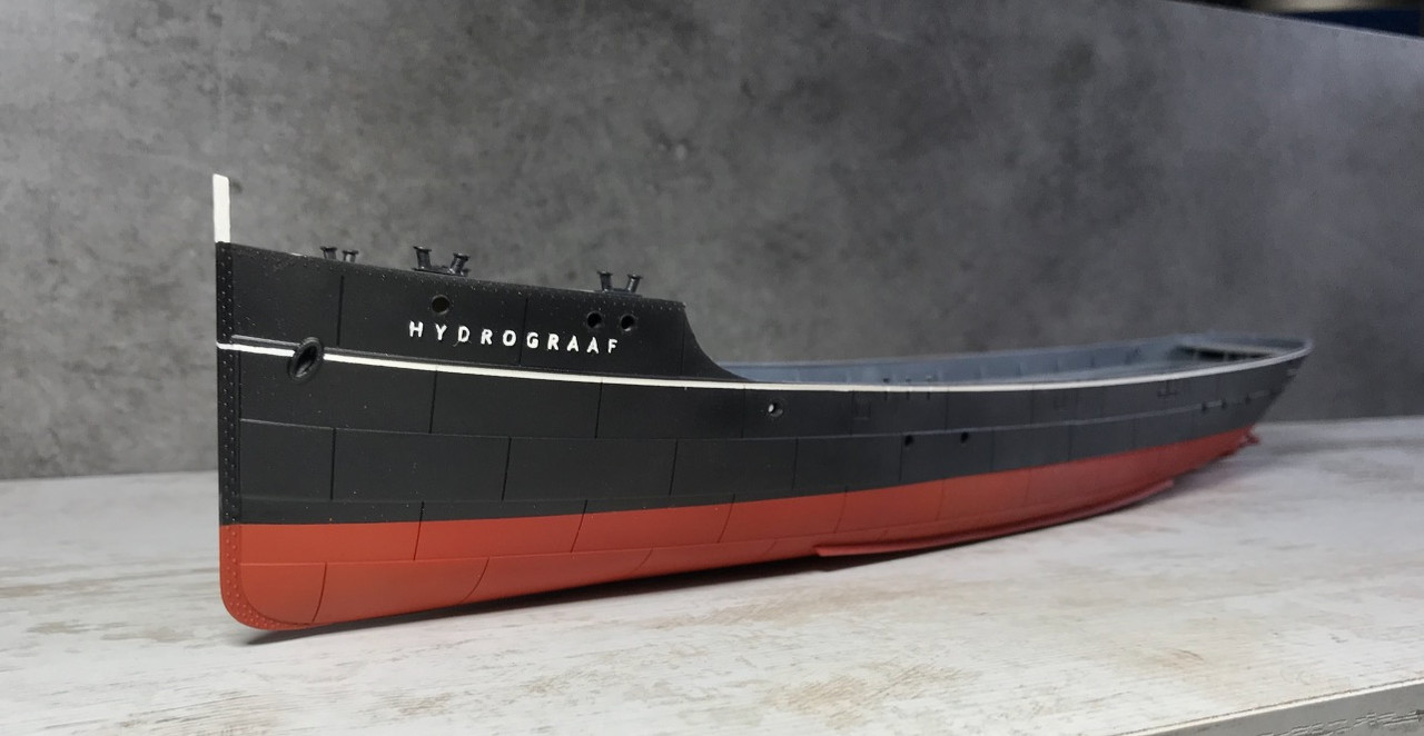

Some progress on the paintwork.
At the beginning of his career the border was painted white, as for the name sometimes white, sometimes yellow.

Good progress! Tom

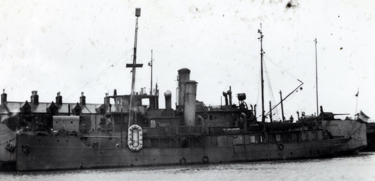

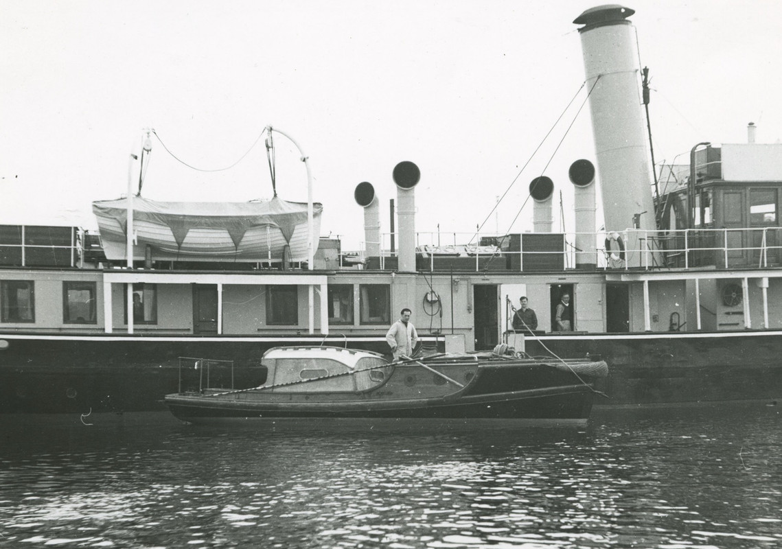

One picture of this ship alongside during WW2:

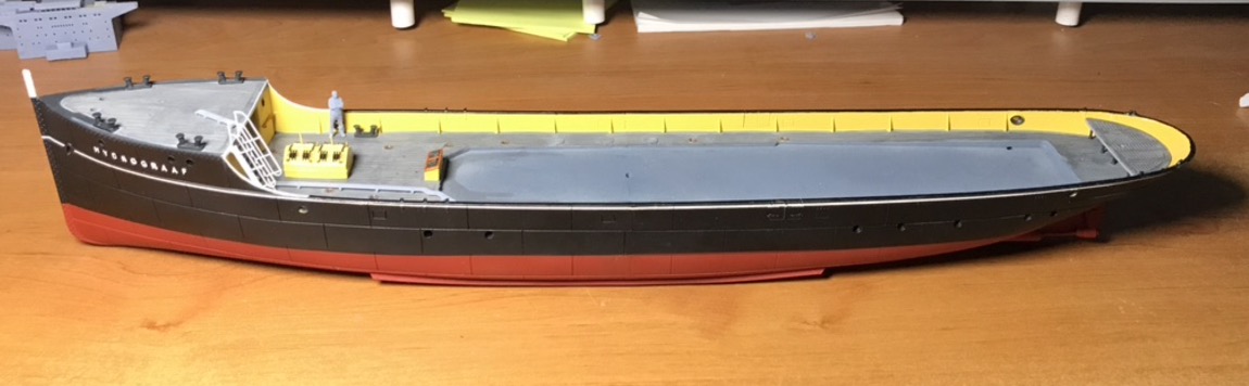

I painted the yellow, there was a lot of masking to do. The rail will be painted black with a brush.

Wow, that's really looking good, Pascal! I'm now really on my toes how your deck will look when you're done painting it.

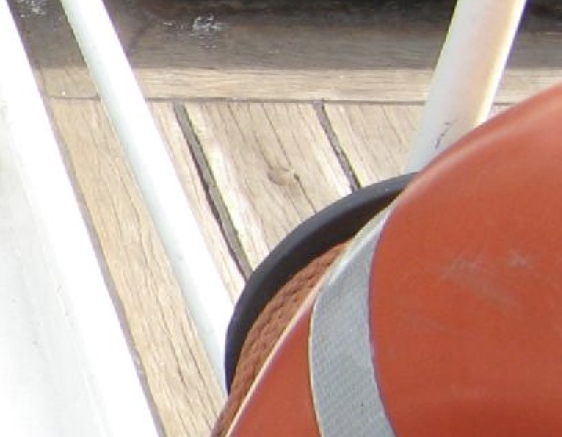

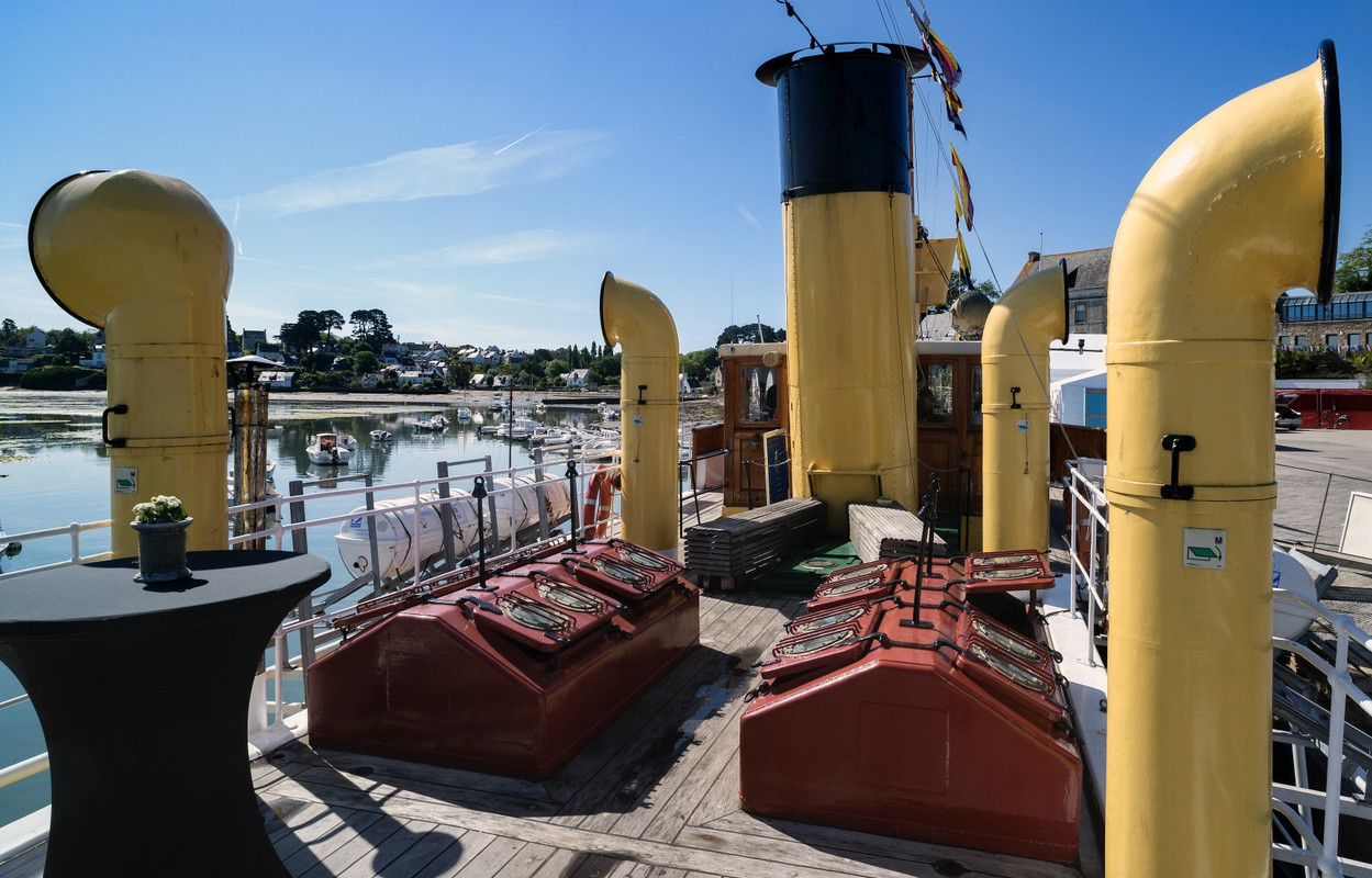

My frustration with wooden bridges is great, I'm trying to achieve what you can see in this photos, which is the color of wooden decks in general after a few months of service.
I am not happy with the wooden decks sold either, as this is not the true colors of teak aged by tons of sea water and rain.
Pascal

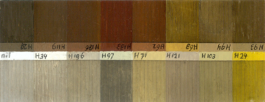

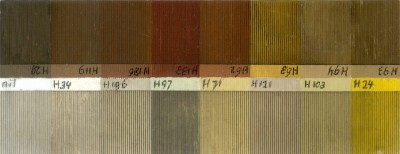

I also have my reservations with 'real wooden decks' on model ships. As I'm primarily a plastic model builder, I have spent some time in trying to find some ways of simulating a wooden deck on a plastic model. To me the trick is largely a base colour (Humbrol), and when thoroughly dry an applied wash of artist's oil paint, in my case Talens' Van Dyck very dark brown. The colour does more justice than black.
The base colour leaves room for variation, between wood sorts and degrees of weathering. I did a sample of several Humbrol colours, each with the dark brown 'caulking' applied. See below:
For your intention of the decks of 'Hydrograaf' my choice would be Humbrol 196, this really is light grey, but with the brown wash this gets just the slightly beige teint you're looking for. If you look for a little more colour (like in the last close-up), then H121 or H103 would be my next choice.
As you see, I even experimented with no base colour at all, and I have even used this to good effect on some WW1 German cruisers.
I hope these suggestions are of some value to you.

Thanks Marteen.
I'll put some of this aside in my archives for a future ship.
I'm going to buy the H196 and H121, which look very good to me. :thumbs_up_1:

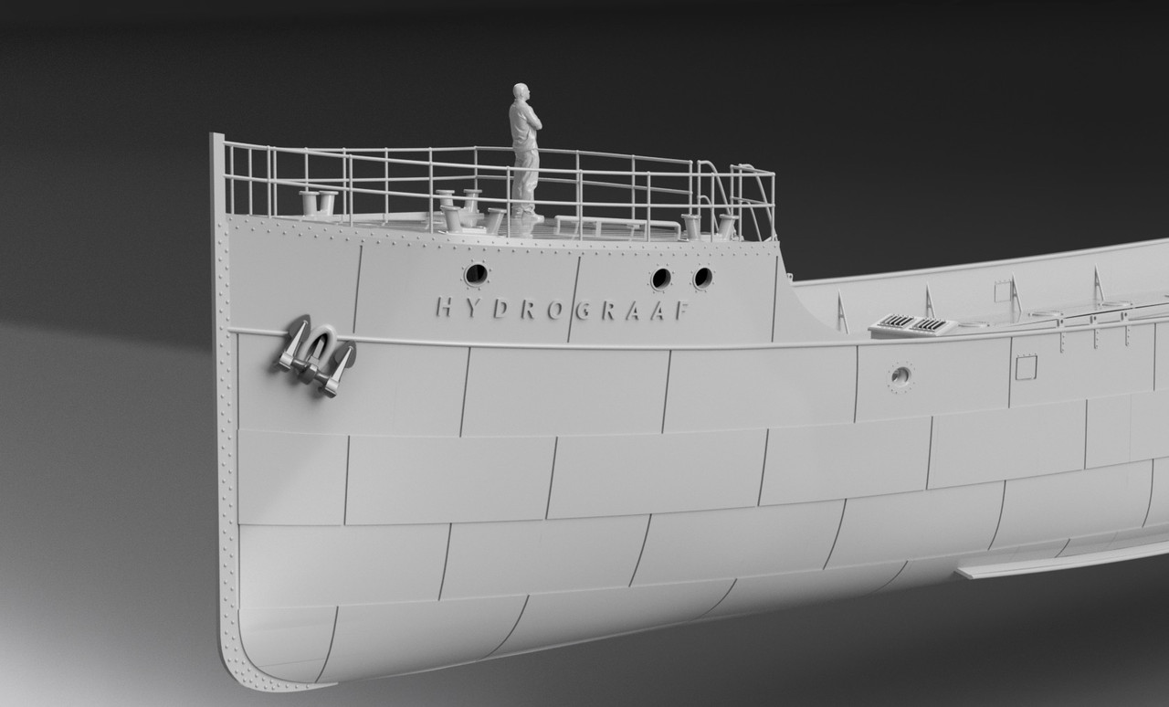

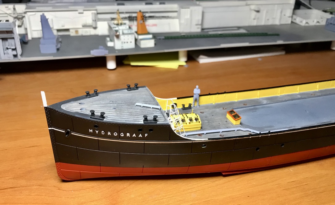

Quite a bit of paint work today and the original anchor design is quite different to the one now.

The decks in the photos are pretty clean. If not cleaned teak will turn a dirty dark brown. Looks like the decks on the Hydrograaf are being taken care of.
On the cruiser I was on the crew holystoned the deck with granite bricks, sand and some type of bleach - I'm not sure what they used for the bleaching agent. On the first minesweeper I was on the crew used oxalic acid and brooms to scrub the deck. Both ships were flagships and we wanted the ships to be "pretty."
In both cases the freshly scrubbed decks were a very light in color. Not white, but a very light tan or wood color. Maybe even a bit brighter than the decks in your pictures.
