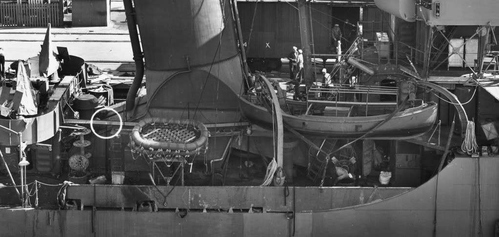

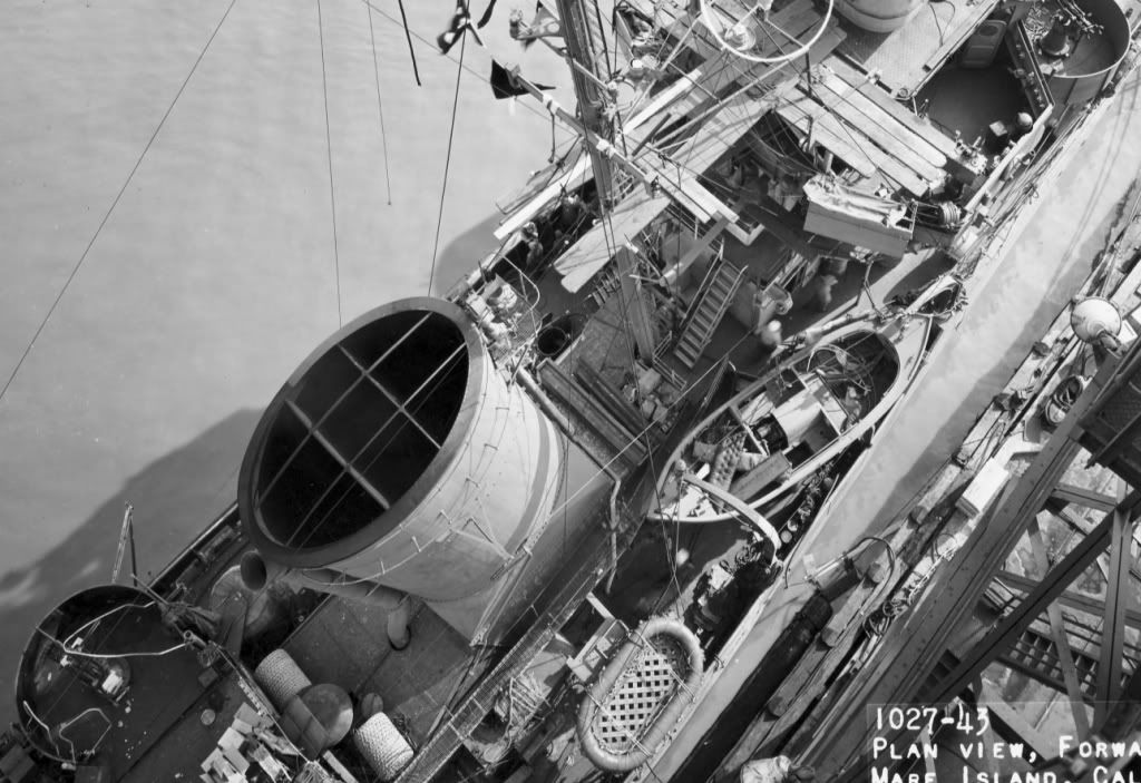

OK... I have assembled some photos of what I THINK is the issue with the stack on the Benham (and a few other destroyers in the 1,500 ton class(es)).
Here is an image of the USS Sterett, a Benham class destroyer stack showing the cross-section:
The Midship kit contains parts B33 & B34 that make this cross-section. And they go with part B35 for the base.
BUT....

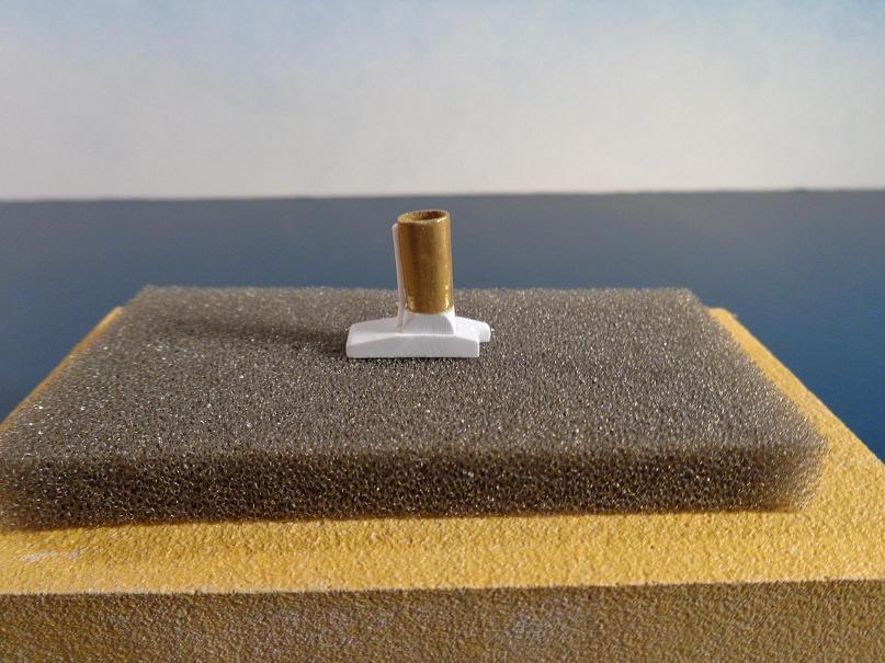

Here is an image for the same kit Midship makes (USS Stack DD-406), specifically of the part I will soon reference (the trunk*)
The Midship kit goes not seem to have this part. *The Trunk that joins the rectangular base of the stack with the elliptical top portion of the "USS Stack's stack" itself.
It looks like it is missing this trunk that goes from the rectangular base to the cylindrical stack itself.
Also, I checked the height of their stack...
Guess what?!?!?!
It is too short by exactly the height of the trunk:
Here is the USS Stack

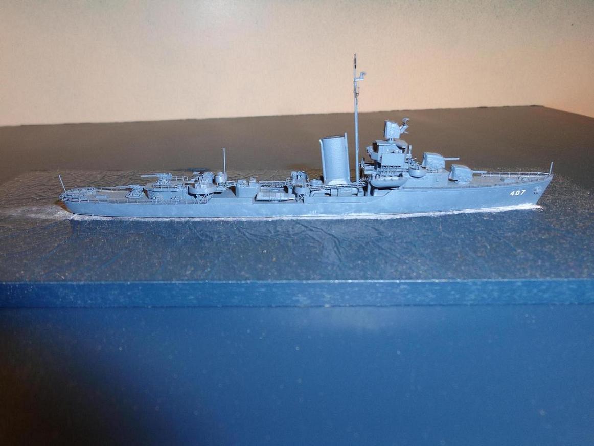

And here is their kit's side-view:
Notice their kit's stack doesn't even come up to the top of the wheelhouse.
Whereas IRL, the USS Stack's stack came up level with the fire-control turret/range-finder.
That is exactly the height of the trunk that is missing.
I am going to go ahead and do a 3D Model of that trunk, just in case that IS what is wrong with the kit.
I can have it finished by tomorrow morning (assuming I don't fall asleep, since it is almost 1am).
But it should only take me about an hour or two to get the part designed, and then it will probably take about 4 hours to print (assuming I use the high res printer - I have having to finish parts with a lot of filing).
Then.... I just need to find someone who can make a mold of it.
So... I HOPE that it is just that part.
If someone thinks it is something else, then please let me know.
Also... I have found a few pictures of Benhams that have a stack that is a flat-sided oval in shape, but they still have this rectangular-to-oval trunk-connector.
So... I can make a connector for each type.

Gotcha.
But isn't it pretty trivial to fill in that gap?
I cannot find any images of how it converges, and deck clutter seems to obscure the base of the stack.
So, If I can create a stack that incorporates these two things, then would that be the correct stack for the Benham?
I really want to get on with this, since it is such an easy digital build.
Dick J wrote:
MatthewB wrote:Also... I have found a few pictures of Benhams that have a stack that is a flat-sided oval in shape, but they still have this rectangular-to-oval trunk-connector.
I am curious which ships those could be. The Benham's all had the oval stack seen in your overhead of USS Stack. If you are talking about DD-400 or DD-401, they were the second pair of Bethlehem ships and were Gridley's not Benham's.
Oops... Yes...
So, then... I need to make one (the connector trunk) for these guys, too, since they also suffer from having too short a stack that lacks this part?

The Gridley stack was far and away the most complex of the bunch. Neither Midships stack comes even close and it will take far more than a "connector trunk" to duplicate this. The structure below the "trunk" is not symmetrical and is hard to describe. Photos are difficult to decipher.
Contact me offline for some shots that help sort out the Benham stack base. dick_jensen_44@msn.com

Gentlemen,
This was my first attempt at a Benham from the Midships kit.
The recent discussion spurred me to another stack attempt here.
Best Regards,
Mac

That looks good!

I'll second that!! :thumbs_up_1: :thumbs_up_1:
