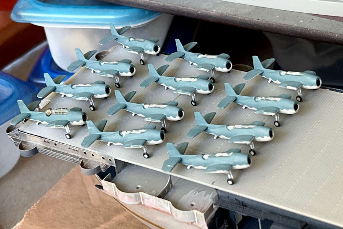

Hello:
All of the F4Fs have been painted. Still need to do some details like the wheels and props, but it's good to see them all in blue. Still need to paint the SBDs and TBMs.

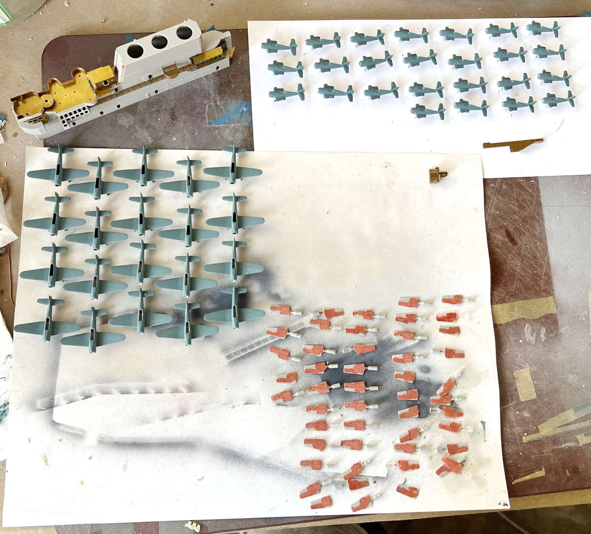

Hello:
Here's what the bench looks like. The F4F's and SBD's are all painted...or at least mostly painted...I haven't done the wheels for most of them yet. Although it looks like nothing has happened with the F4F wings, I've filed/sanded the first side and now I've puttied the second side. Most of the work lately has been on the airwing.
Work has progressed on the island. I painted the background of secondary flight control so that I can add the PE part over that area. I've also done a few platforms here and there.
Mike

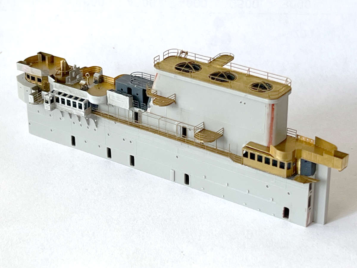

Hello:
This is where things stand now with the island. Everything here is glued down. The area between the flag boxes and the 'house' between them is rather tight, so I painted that area prior to assembly. Similarly, I painted the catwalk on the starboard side of the island before assembly since access would be difficult given the overhang from the part above it. Otherwise, I'm more or less following the directions.
Mike

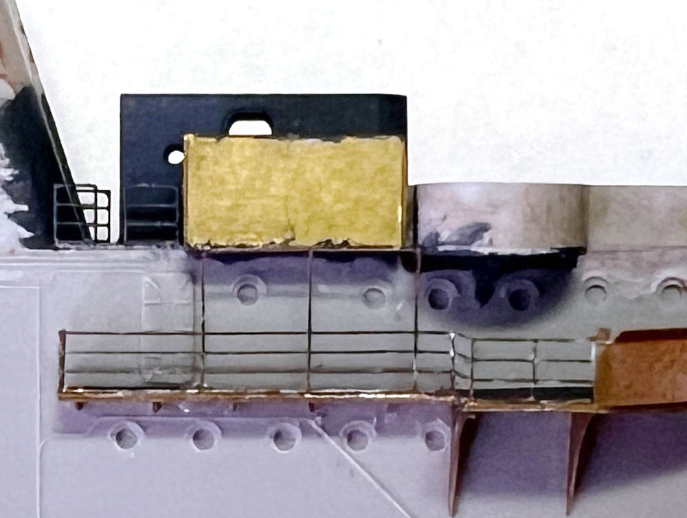

Hello:
One spot of trouble that I ran into was on the starboard side catwalk. There is a vertical extension of the railing that goes up to the flag box above it. Initially, I installed the part so that the top of that extension was under the flag box. However, that pushed the catwalk down and made it noticeably bent. So I pulled it off and tried again. It seems that the vertical part of the railing is supposed to go on the outside of the flag box to get things to fit. I also have some interference with the 20 mm gun tub above it, so I might need to trim things.
By luck, I later installed the railing for the port side catwalk, and I ran into a similar issue where the vertical railing extension needs to go along the outside of the flag box rather than under it. That part went on with a minimum of fuss.
Mike

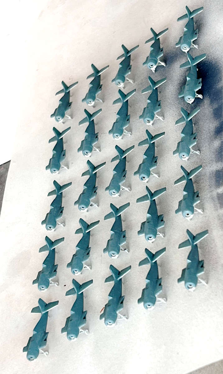

Hello:
In between all of the PE work on the island, I've been painting the airwing. Here I've painted the blue on the TBFs, and painted the wheels. For some of the wheels I was able to carefully paint around the tire without getting black paint in the middle, but for others that didn't work out so I used a piece of wire to dab a dot of paint in the middle of the wheel. The F4Fs are now at the same state being fully painted, and only the SBDs don't have painted wheels.
Mike

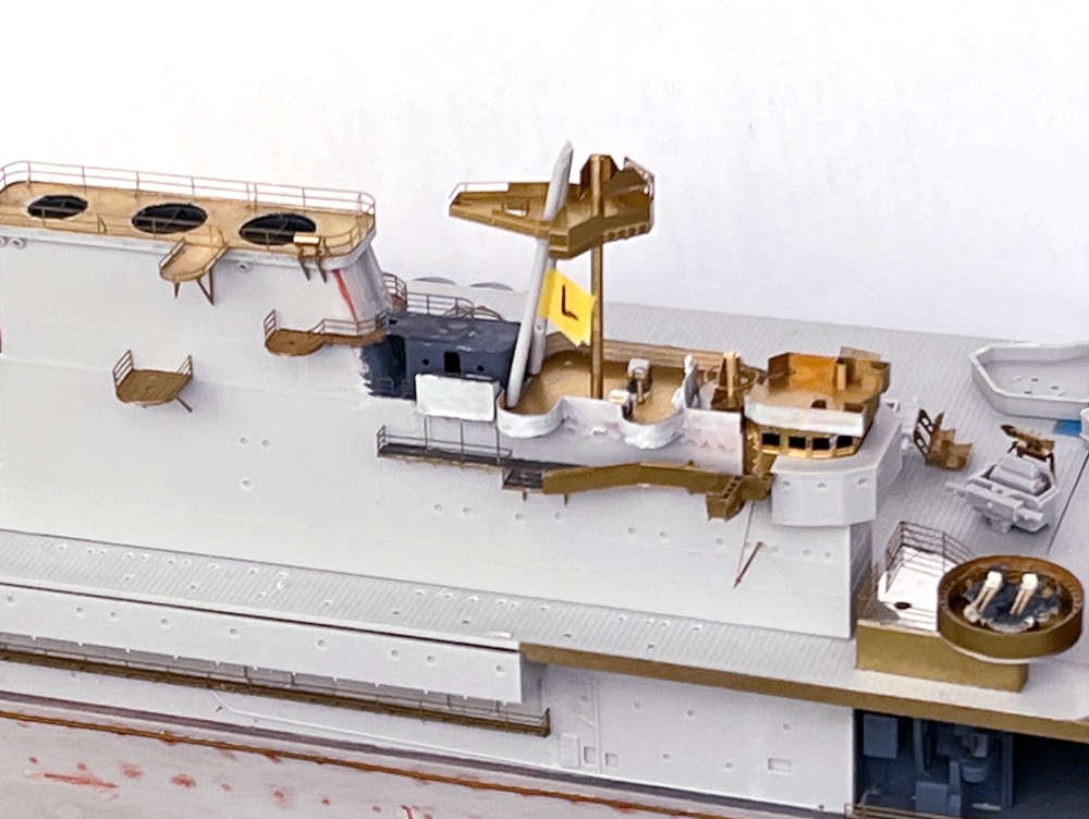

Post by mconnelley »

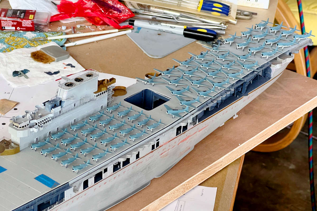

...and here's what it looks like dry-fitted on the island. The front leg isn't quite plumb, maybe because the rear legs might be a little long. Overall, it's starting to look like the Big E.
Mike

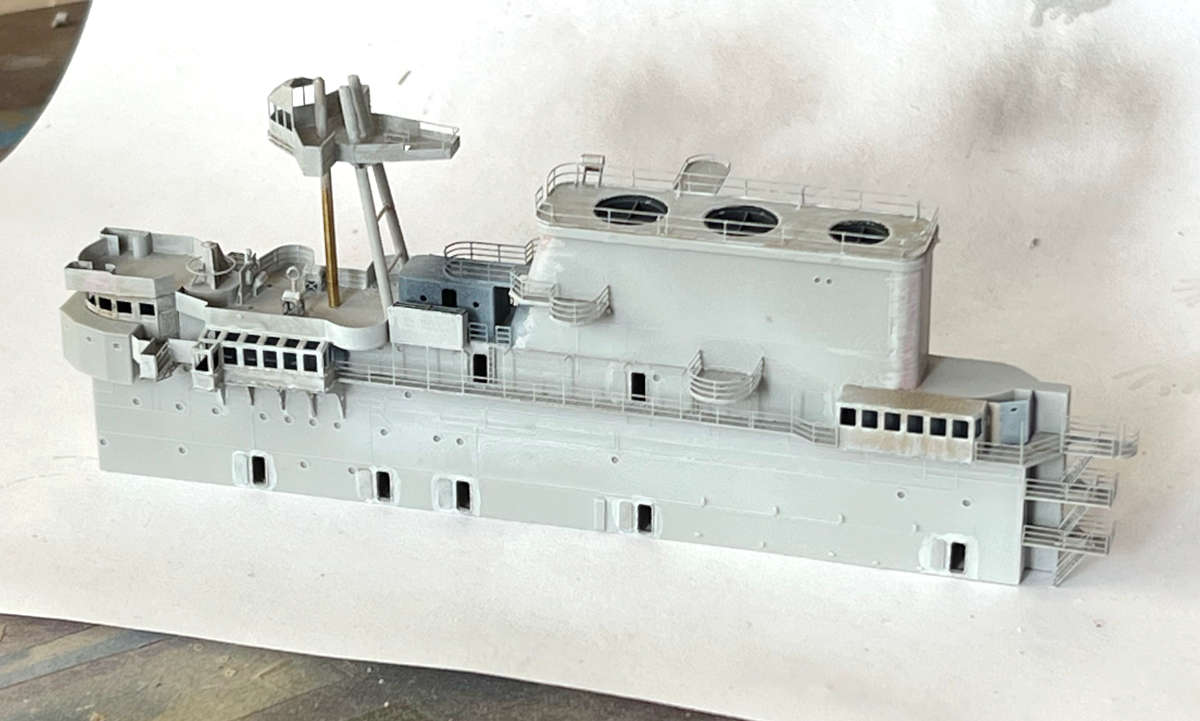

Hello:
A lot of work has happened, but it might not look like it. One key thing is that I tweaked the lengths of the tripod legs so that the front leg is nice and plumb. I gave it a coat of primer, which sort of makes the photo-etch all just 'disappear'. It's a bit sad to see the shiny brass go away, but it's getting closer to completion.
Mike

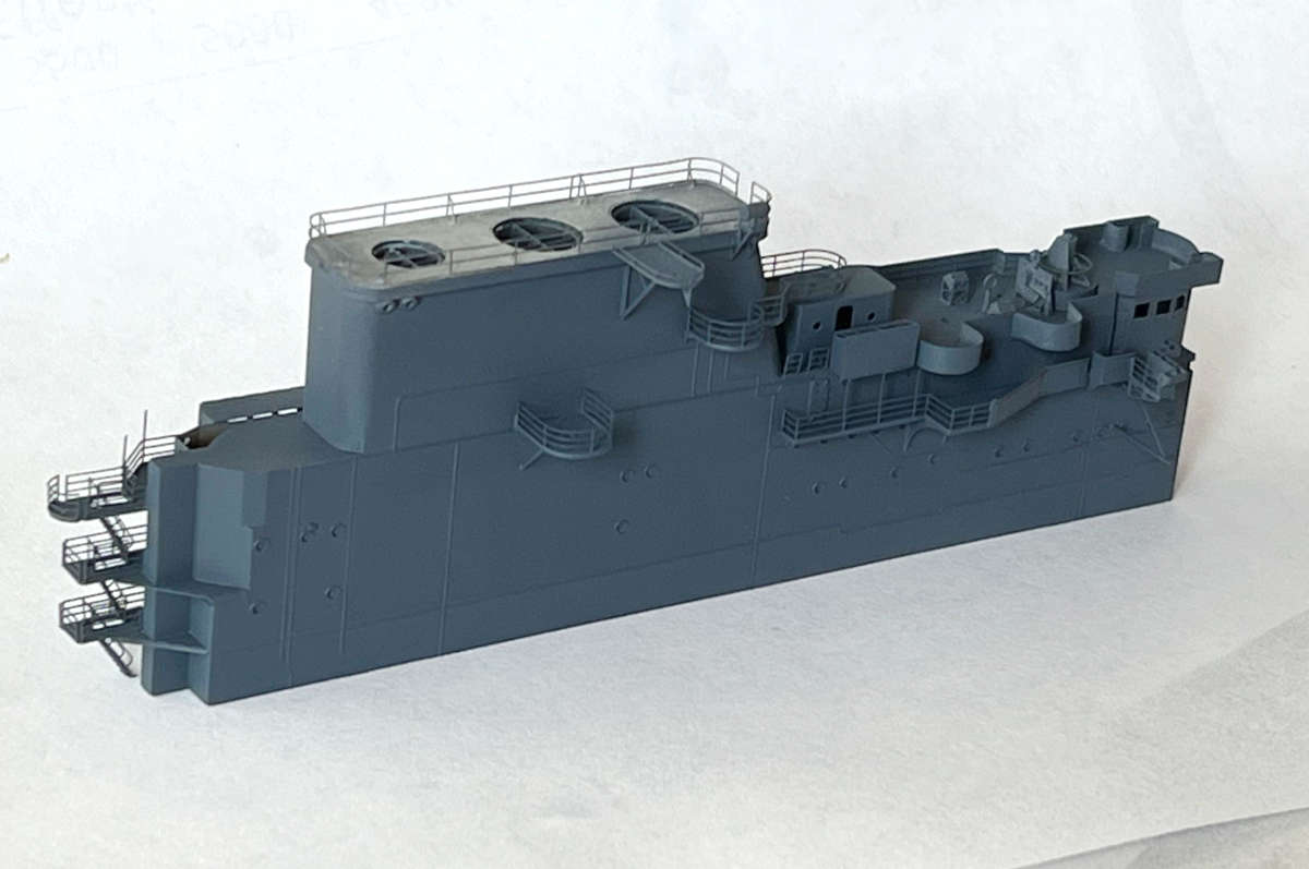

Hello:
Here's the island with a coat of paint. All that PE detail sort of melts away, now that everything is dark blue. It's a little sad to see it go away...I kind of liked the shiny brass here and there.

mconnelley wrote:All that PE detail sort of melts away, now that everything is dark blue. It's a little sad to see it go away...I kind of liked the shiny brass here and there.
I understand the feeling!
On the other hand, it's also a good thing that the PE isn't too obvious after painting, because that means you constructed it well. And if you like to weather, you can enjoy all those details a second time! :big_grin:
