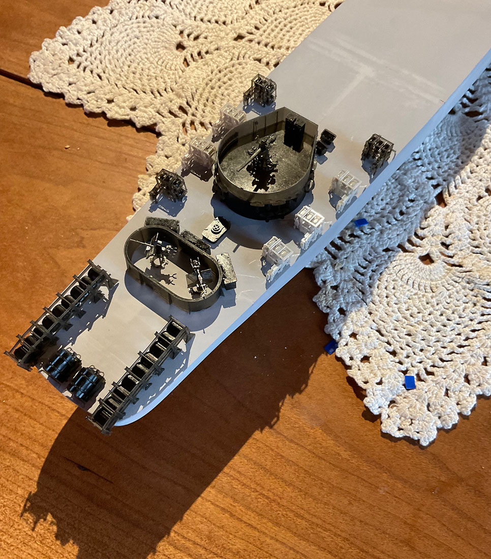

Thank you Pascal! As this was my first effort using the Chitubox hollow feature and a super long print time, I was a little conservative.
Having run out of the grey resin I switched to black, which I had a little of, printing some of the various bits and pieces for the stern as shown here. All just sitting in place. Almost out of black, provider has updated and says resin by Monday, maybe. FEP maybe by Saturday? I have printed all the K guns but they tip over if not fastened to the deck. Have a mix of 600 lb "ash cans" and the streamlined MK 9 depth charges. The Orlikons are I believe to be the MK 10 with the MK 14 sight though most photos show them covered with canvas covers. These have the open stands.

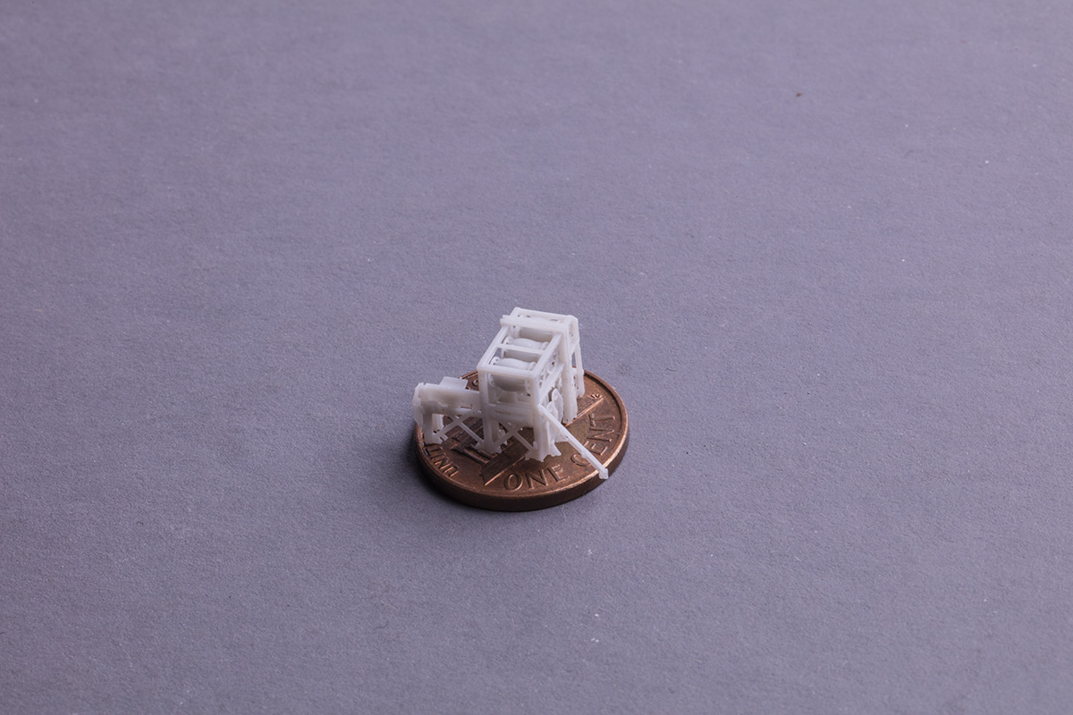

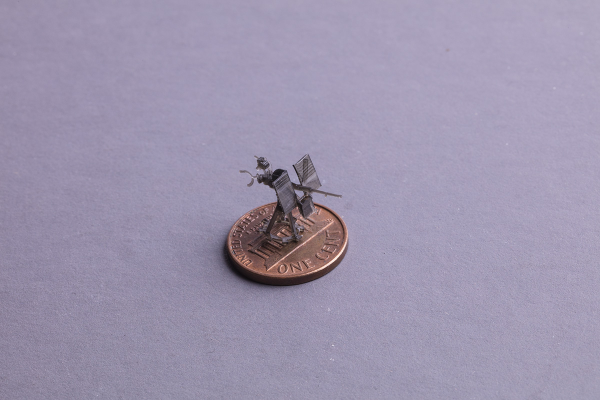

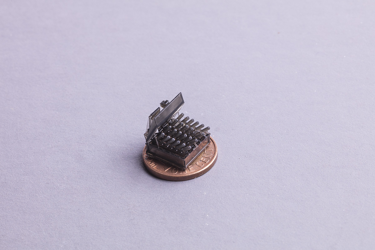

The England AOS book indicates that these DE's were originally equipped with the 20 MM MK 4 Orlikon. This had an elevating mechanism operator and required an additional crew member. My unproven assertion was these were replaced, in the case of Whitehurst with the MK 10 and MK 14 sight either before or after her Pearl Harbor post Kamikaze refit. I have modeled both units so it's not a choice of convenience.
Hedgehog, a spigot mortar defied by the British, was a very effective weapon compared to depth charges. England used hers to kill all six submarines. The mechanism was provided with a tilting mechanism for each row which compensated for roll. The angling and firing was set to provide an oval pattern about 140 feet across with all projectiles arriving at the same time. Each projectile was contact fused and contained 30 lbs of TNT. Contact and explosion of a single projectile seemed to be enough to cause eventually fatal damage to a submarine. Sinking of the projectile was rapid, about 4.5 seconds per 100 ft. Post war Whitehurst was fitted with two Hedgehog units, trainable, on the O1 level in the place of the Orlikons located there.
I showed the goopy Gray
Whitehurst was fitted with 8 K guns aft which could throw either the MK 6 Ash Can or the lighter MK 9 streamlined depth charge. Range was controlled by varying the propulsion charge. These are just the racks as the K guns modeled in 1:144, tip over if not adhered to the surface. A davit was associated to assist loading spares into the rack, not installed.
I showed the Goopy Gray model, though the Rapid Black resin is slightly more detailed, but hard to see without paint.
Tom
Tom

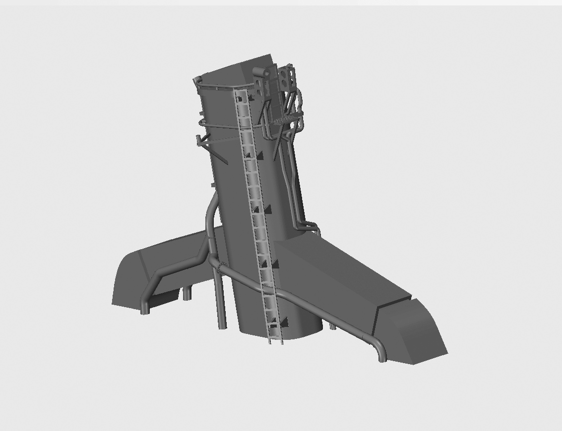

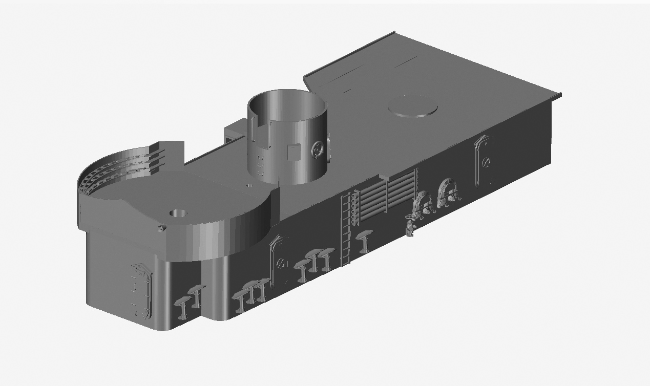

Here in the sub arctic (Global warming has been a disappointment so far) and at the end of a long supply chain the FEP and resin not here yet, maybe soon? However in 3D though one needs resin and printer supplies, design can proceed. I have been working on the aft superstructure and the stack design.
Not the simplest stack as far as accouterments go...
The use of the proto mini model is showing it's value as additional info and interpretation keep arriving. In the issue of the aft superstructure there are numerous small changes differentiating her for her sister England, especially after her Pearl Harbor repairs. It appears that the quad 40 probably replaced the Chicago Piano at this point and numerous changes made in the tub. I think I can cobble up enough info to do the power cable spooling. USS Marsh was also set up with these.
Tom

Re: USS Whitehurst One to who knows DE.
Working on the aft superstructure. The large power spools will be installed just forward of the MK 51 director tub.

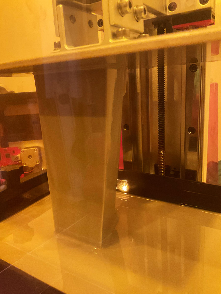

Under the "We'll see" clause of the model builder bible, We'll see.... Just started a 24 hour print of the bow section. In this case 1.5 mm thick instead of 2.5 mm used previously.

Had a false start on the first bow attempt, somehow Chitubox hadn't hollowed out as I had thought. Had to go out and when I got back and checked she was printing a solid hull. A little weird as the predicted resin amount was pretty low given the supposedly thin walls. At least I have a nice paperweight now. About half printed currently. One could print all three sections of the hull at once, though a couple of recharges of the vat would be necessary. I could have done this model in 1:120 in four sections but really didn't want a model that large.
Not entirely push button technology yet.

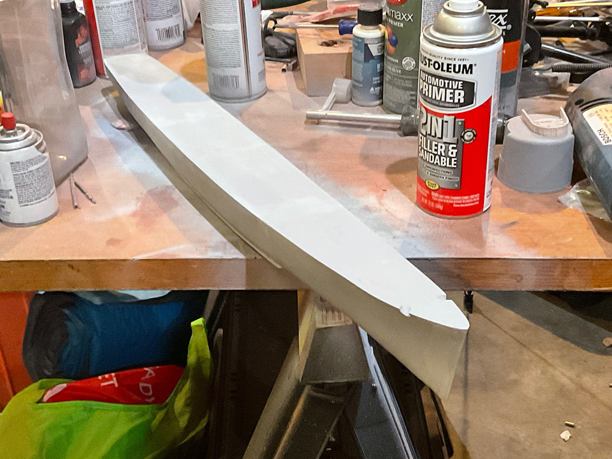

Today's hull progress. Hull printed in three sections, each close to 9" long. I like using the automotive primer/surfacer which covers most sanding scratches and allows a smooth surface for evaluating fairness. If contours are OK, one can begin to proceed to wet sanding with finer wet/dry papers. Eventually arriving at a surface for finish paint. The primer surfacer does build enough to allow one to simulate plating lines if desired.
