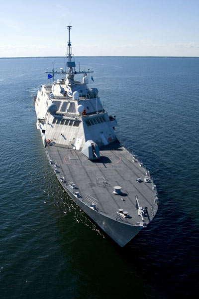

The "LCS" ship still needs to remain a very small ship, so that's the direction this project will go, so the Mk71 is totally out of the question. DD(X) still fills your ship's requirements a lot better than a trimaran, but why not go ahead and build your design as a model? It certainly falls into a light guided missile destroyer. If you would build your project, would you go 1/350 or 700? How would you build your sideshooter? Would you only have those as your whole RAM capability, or would those be in addition to normal RAM mounts? If it would be your only RAM mounts, why would you want to cluster your whole RAM capability into one location and mount it to a gun mount that has its own mechanical problems? I think it would be great fun to watch your idea come together as a model, man! Will you start a thread for it?Sciquest2525 wrote:I scaled the hull to increase hull depth and deckhouse by a level for each so the deckhouse hangar could accommadate MH-53E/K helos for MCM or SOF support. I particularly wanted to have four helos plus four VTUAVs.
- Sideshooter Mk 45 five inch gun would have 21 cell RAM launchers on either side of the gunhouse and marry five gun AAA and RAM SAM with decoy launchers in one neat package that would save deck space and was patented in 1992.
- The 8 inch/60 calibre gun would have a long range and harder hitting with optional precision guided rocket/ramjet assist projectiles able to match and exceed ranges of AGS/AGS Lite.
- Hull was scaled to allow internal changeover of mission modules ala GD trimaran design which has one active and stowed mission package that did not need port visit to swap out as much as monohull LM design.
What-If LCS Flight II: Littoral Combat Ship Improvement

Concerning the LCS-3+ concept, does anyone have an idea as to how to improve that hull as far as the previously stated missions? I am fighting over whether to consume hangar space for the VLS. If that would be the case, as many VLS cells would have to be put forward as possible (8, 16, 24, 32).
What do you think?
What do you think?

I would disagree about the size of the ship. The extra displacement (7000 tons full load, I hope) to accommodate increased fuel, helicopter hangar size and more VLS cells and heavier gun armaments.
The vessel would be a Littoral Frigate Guided Missile Helicopter Artillery or LFGHA as it would be a very capable warship and not the functionally crippled design of the baseline LCS.
I wanted to add one deck level to the superstructure and the hull so that both could handle the increased height of V-22 Osprey as well as the MH-53K Super Stallion helicopter and the increase in size is intended to carry more fuel and increased armaments.
Mk 71 is needed for NSFS role as the five inch popgun and the AGS or AGS Lite is being procured in very small quantities while AGS Lite is limited to 180 rounds of ammunition vice the Mk 71 has 75 ready rounds plus whatever could stowed in the main magazine. The 8 inch rounds are more destructive and longer ranged with rocket or ramjet assisted with an anti armour role if fitted with terminal guidance or carrier for SADARM guided and unguided submunitions and the larger amount of explosive of the unitary round.
All steel construction for deckhouse as well as the hull. Composite deckhouse in the future if costs were acceptable.
Retain the existing LCS propulsion and accept a reduction in maximum speed.
Seperate the diesel and gas turbine plants into four engine rooms (two diesel and two gas turbine) with electrical power generation in each so that a hit on one would not kill all the propulsion or electrical power as in the Cole affair.
Proper in hull protected CIC with backup CIC as in the Sa'ar IV Israeli corvettes.
Have a permanent mission module crew cross trained in all the module types so the same people could operate the ASW/ASUW/MCM/NSFS/SOF modules without changing crews for each module type.
Expanded mission bay area to have one module operating and one or two modules stowed ala Independence class LCS so module changeover less dependence on friendly ports and transits to and fro and take much less time.
NSFS using Mk 71 supplemented by navalized MRLS and AH-1Z and navalized Apache attack helos.
SOF support with SOF vehicles and aviation such as CV-22/MV-22 and helos.
Roll on and roll off ramp for vehicles and containers.
Elevator between mission bay and main deck inside the hangar safe from enviormental hazards that plagued the CGNs and able to handle up to one MH-53K with rotors/tail boom folded.
Accomodations of H-60 helos, VTUAVs,MH-53E/F helos and tilt rotors using containerized support modules as space allows with reconfiguration according to what type or types of aircraft hosted by the ship.
Gun armaments will include a bow mounted Mk71, port/starboard 5/64 Oto Melara behind the forward funnnel in Sideshooter configuration of two 21 cell RAM launchers on each side of the gunhouse.
Two port/starboard non deck penetrating 76 mm Super Rapid (120 rounds per minute) on top of the hangar firing guided and unguided ammo with on mount guidance radar.
Two Fast Forty twin port/starboard mounts firing 40 mm at 900 rounds per minute out of 888 rounds capacity magazine with dual ammo feed for CIWS and swarm boat role.
SPY-1F with two tracking and illuminating radars and a backup conventional air search and tracking radar.
Capabilities are high lighted on a larger hull, I know, way larger to accommodate more of whatever fuel/weapons/ammunition/sensors package provided for.

Dave,navydavesof wrote:Concerning the LCS-3+ concept, does anyone have an idea as to how to improve that hull as far as the previously stated missions? I am fighting over whether to consume hangar space for the VLS. If that would be the case, as many VLS cells would have to be put forward as possible (8, 16, 24, 32).
What do you think?
After listening to a web interview with Dr Friedman about LCS flexibility and mission modules which sparked a few fires:
- VLS is important. Dr Friedman noted that VLS also offers flexible capabilities (implying not just weapon capabilities) and is relatively cheap to add. I say
add them!
- I do not think LCS has RAST which limits rough sea operation of helicopters. I say add it or a similar system.
- If the Navy continues to insist that unmanned surface and sub surface vehicles are key to the LCS effectiveness, then the ship needs a significantly improved capability to launch and recover these in high sea states. The commercial off shore industry is light years ahead in active compensated gantries, cranes, and other tools to handle obscenly large and very dynamic loads. The navy needs to tap into this bank of knowledge and provide LCS with some of this capacity so that the crew can rapidly launch, recover, and repair these vehicles. It does not good to apply all the attention to low radar reflectivity if the ship takes a lot of time screwing about in the combat zone (on the "X") when trying to launch submersibles. Active heave compensated knuckle-boom cranes should be fitted.
- I still think this ship needs a hull mounted sonar, possibly VDS, and maybe a TACTASS. ASW is not something that you just fly out a couple of dozen sailors, add helo det and call it quits. Crews need to train at this constantly to develop proficiency.
Finally, someone noted that the navy had traded construction of a number of amphibs to get more LCSs and that somewhere down the road, the LCS will have to make up some of that loss in amphibious lift. Perhaps the LCS has a future as a modern APD?

Could the LM stretched 150 meter export variant of the Freedom class meet these requirements. It may have the additional weight margin for the systems and future modernization. The apparently expanded mission bay and hangar would allow more VLS cells to be added vice the LCS baseline hull used for the Israel for their proposed and then abandoned LCS-I. Hangar would have less space cut out for VLS as the larger hangar could give up more space to the VLS with less impact on the hangar space.
I think you need from 48 to 64 VLS if you have SPY-1F/Aegis combat system.
Missiles add flexibility to the super LCS.
Enlarged hangar might allow more H-60 helos/VTUAVs to be operated.
Enlarged mission bay might allow for carriage of two mission modules.
Some equipment would be fixed for ASW/MCM roles like a hull mounted mine hunting sonar and a towed minehunting sonar.
ASW would feature both hull mounted retractable sonar and VDS and MFA tail.
Need more crew.
Mission modules might be fixed and their containerized systems allow quicker and easier modernization when the ships reach their mid life update.
Build with Level II standards with more compartments, all steel construction, seperated engine rooms and more crew for damage control and maintainance, easier access to compartments for damage control and robust ASCM defenses both soft and hard kill with redundant systems that would allow some defensive systems to be backed up in the case of damage or breakdown.
