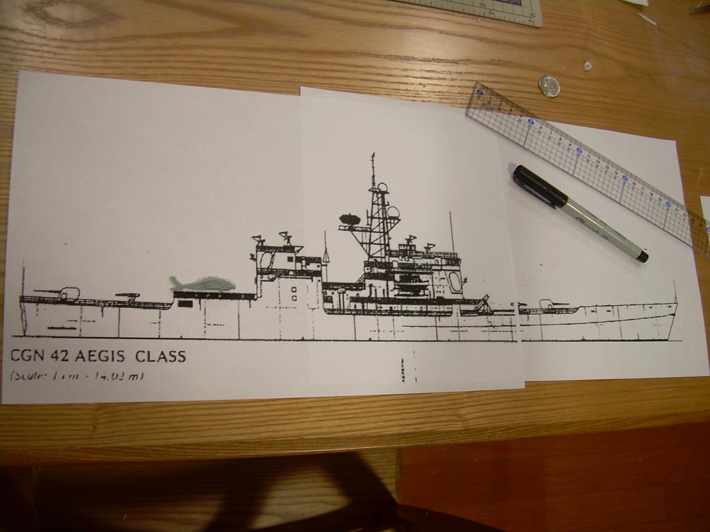

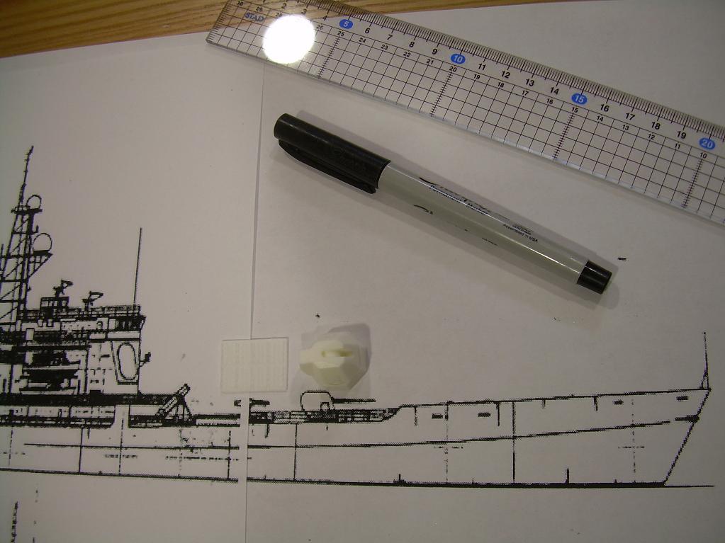

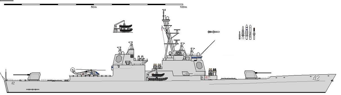

This is the format I will pursue. In the scaled picture the mast might be a little big, but the arrangemet is correct. now it's going to be time to build the super structure while the hull is on its way.
So, the questions I need to answer are:
-Stern boat deck?
-Enclosed or exposed small boats?
-Boats on one or both sides?
-128 VLS or more?
-16 or 32 Harpoons?
-Mk45 Mod4 5"/62caliber guns or Mk71 8"/60caliber guns?
Does anyone have suggestions?

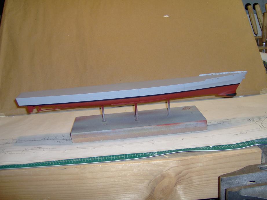

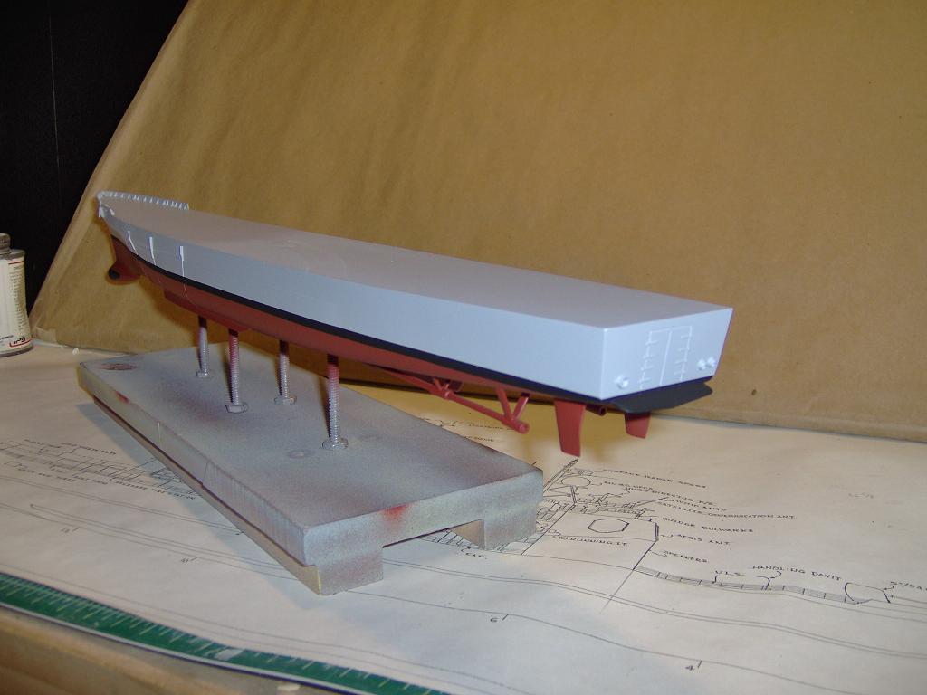

Re: CGN-42
Ladies and gentlemen, I give you:
The beginnings of the hull! I actually have quite a bit more pictures, and the hull is quite a bit further along. I am just having a horrible time resizing them. Trust me, it is absolutely wonderful. When I get this problem down you, watchers, shall be the firsts to see the hull of the next nuclear powered crusier!

I think this digital representation of the Coast Guard's National Security Cutter's stern boat deck is a very good framework for the CGN's possible stern boat deck.
The fitting of two ramps, perhaps separated by a bullhead, with perhaps a work shop just forward of it would offer a lot of benefit. I would suggest this would possibly consume perhaps 14-15 meters in the ship's stern consisting of the 11m boats' length, a catwalk, and work benches and equipment storage area.

Re: CGN-42

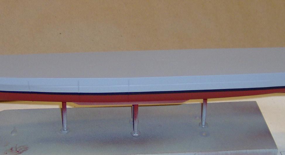

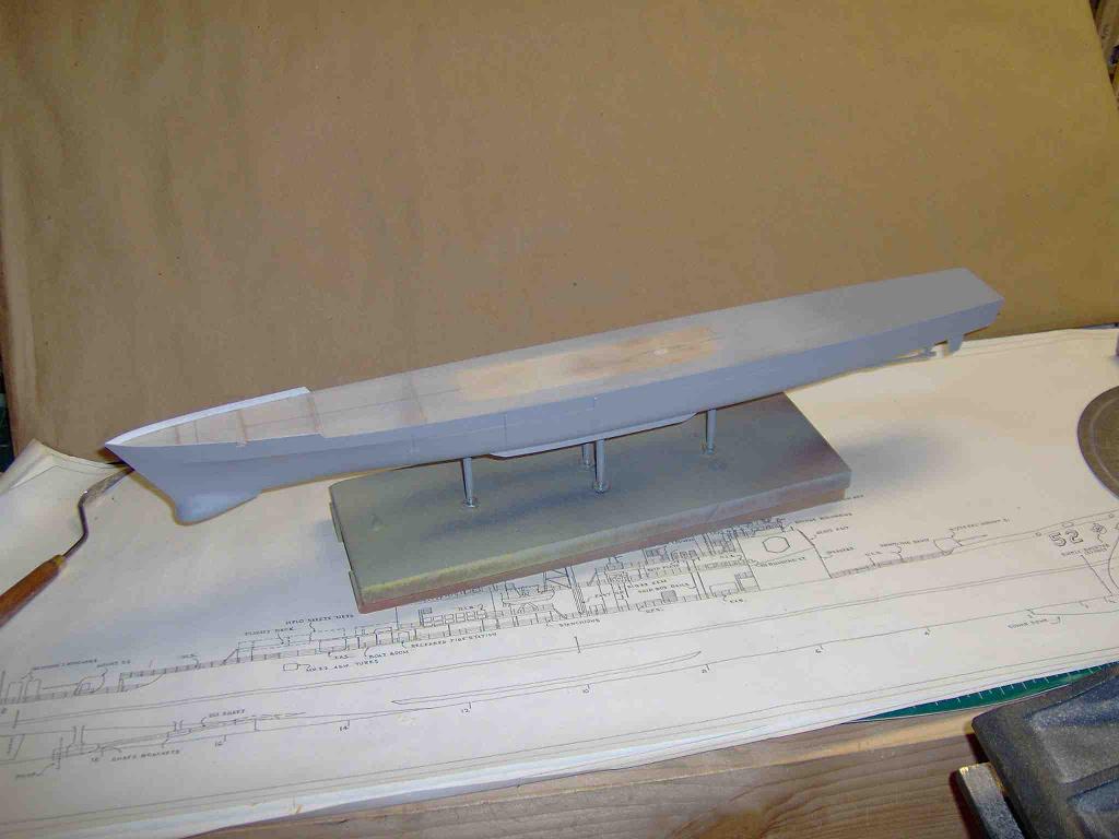

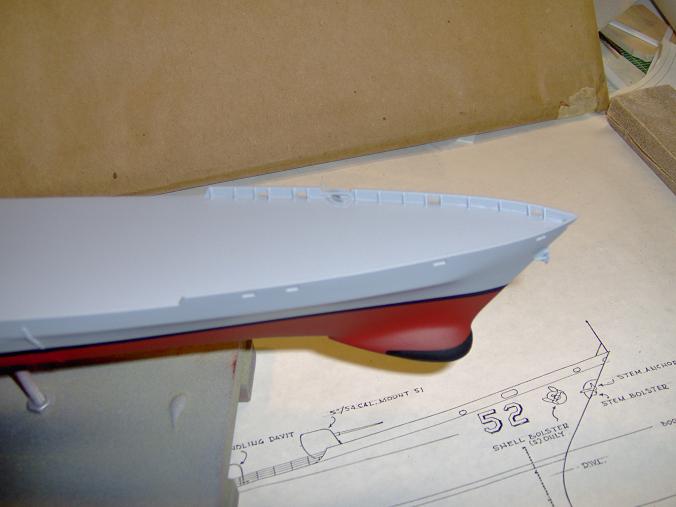

Good afternoon ladies and gentlemen!
This CGN-42 project has been moving along for quite some time, but I have not made very many posts! This is a combined project between myself and a friend of mine who is a fantastic ship builder. He liked the initial stages of the project well enough to offer to build a hull for the new version of the CGN-42, and I will scratch build the super structure.
He has been beating me in progression, that's for sure, but fear not! I shall catch up soon! Here are pictures of his most recent fantastic work. He has completely carved this out of wood and added all parts and pieces individually.
If you have a sharp eye you can see the top of an armor belt in there! Here you can see the stern has NIXIE, TACTAS, and the small boat stern deck! Oh yeah. All that I can say is BROVO ZULU! In Navy talk that means "fantastic job!"
As soon as I can alter the properties of some of the earlier pictures I will post early progress pictures of him actually carving out the hull. The progress is really fascinating, especially seeing how it goes from a chipped away block of wood to a smooth hull.
I hope you enjoy. I am certainly enjoying this build. My friend has set the bar pretty high! It has challenged my scratch building abilities. So far I have only had globs of sheet styrene that don't match proper angles, but I will get this down. I can't wait to successfully build this super structure. This CGN-42 is going to be one beautiful beast.

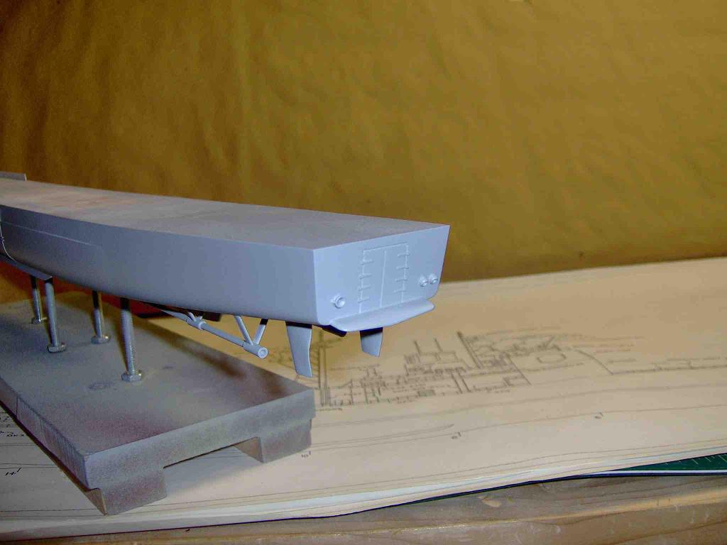

carr
- Posts: 1780
Re: CGN-42
Well, I just love this already!!
Can't wait to see more.
I see that the Nixie and Towed Array openings are very close to the waterline compared to actual installations on existing ships. Would this cause any water infiltration issues?
I also see that you've added the duckbill to the stern. Have there been any studies on applying this to larger ships? Would it provide the same benefits as on smaller ships or is there some upper limit beyond which it no longer helps?
Are you going to add underwater hull openings/sea chests? I know that level of detail may be outside the scope of a conceptual model. Just curious.
Bob

Hey everybody!
For reference, the water-line is at the bottom of the boat deck doors. For demnostration purposes I think there is no problem.
Later guys! Thanks for the interest!
I know! I think it's going to be a fantastic build. I hope to get a good portion of the super structure built this weekend.carr wrote:Well, I just love this already!!Can't wait to see more.
Not on the modelcarr wrote:I see that the Nixie and Towed Array openings are very close to the waterline compared to actual installations on existing ships. Would this cause any water infiltration issues?
You might want to look into it, but I am pretty sure LHDs have them now. Since CGs have them I think it is very appropriate here.carr wrote:I also see that you've added the duckbill to the stern. Have there been any studies on applying this to larger ships? Would it provide the same benefits as on smaller ships or is there some upper limit beyond which it no longer helps?
That's one of the problems with the Virginia-class hull. To our knowledge there are no accurate underwater or drydock photos out and about of it. Do you know of any?carr wrote:Are you going to add underwater hull openings/sea chests? I know that level of detail may be outside the scope of a conceptual model. Just curious.

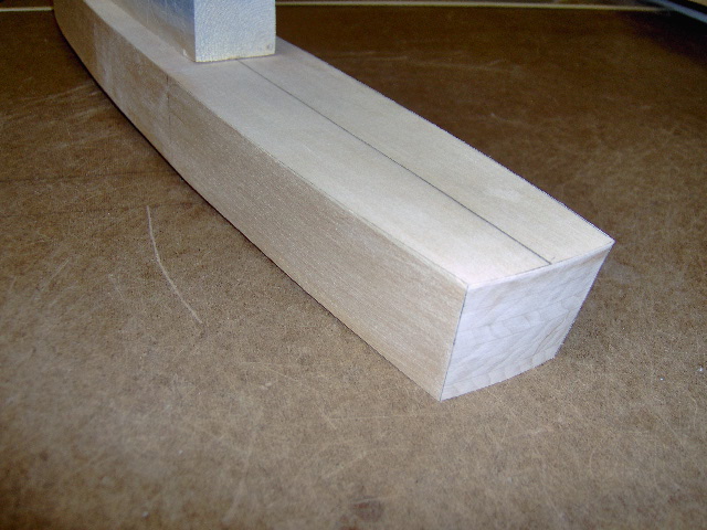

1/350 so around 20" I believe. It is carved from Basswood, and there's only one.ex-navy wrote:How big is it and what did he use for the wood and is covered in plastic or what... is this a one time deal or can it be reproduced for others.....

Stern Flap:
As best I can determine, the stern flap is being installed on Burkes and the LPD-17 class. A trial installation was also done on PC-13 (Cyclone class). I have yet to read of any reason why they can't be installed on larger ships. Fuel savings are said to average 10-15%.
Here's a shot of the flap being installed on USS Cole. Note the height of the towed array.
Here's a shot of a commercial vessel with a small stern wedge and lateral (side) flaps. Same idea, just on the sides near the stern.
Sea Chests & Openings:
I've never seen a docking plan for the Virginias but since this is a WIF you could, if you wished, make up your own. Probably more effort than a concept model warrants!
Bob

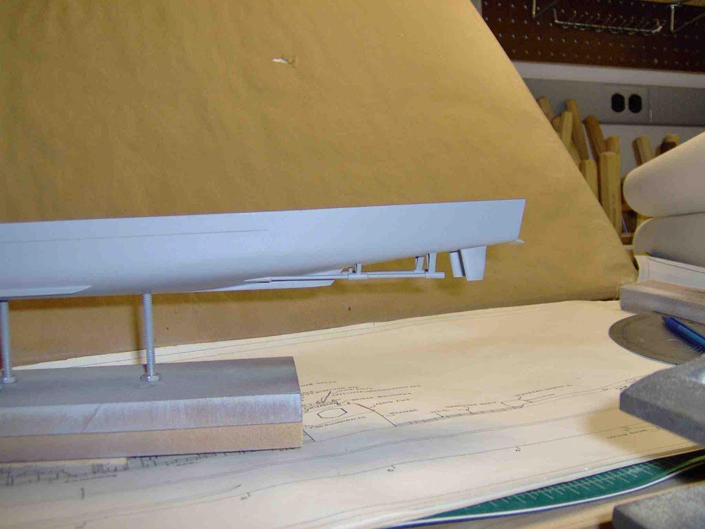

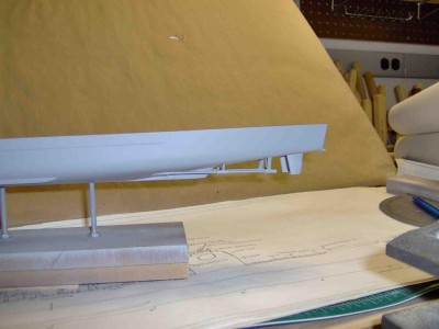

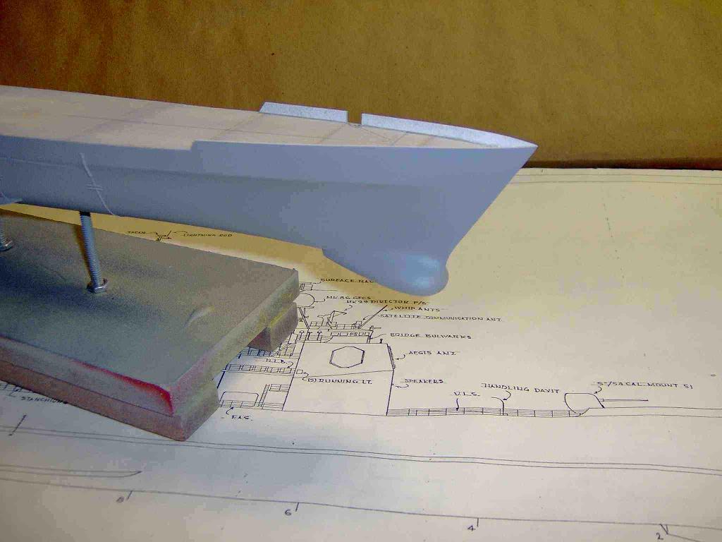

Good afternoon watchers! My team mate in this venture has made more progress on the CGN-42 hull. It is almost finished, and then it's going to be up to me to build the super structure and associated pieces.
Here you can see the armor belt I asked to be include in the hull. To scale it is protrudes from the hull by approximatley 4" and run the length of the critical engineering, CIC, and berting spaces. What a fantastic job. It's going to be up to me to do work that measures up to this. I plan to build up this super structure in small sections that I can place together. The first is going to be the O-1 level that the super structure sits on in all of the CGN-42 concept photos and the RFI test model at the Naval Academy. Then I will build the forward super structure and hanger as blocks I can place on the O1 level.
I am going to be incorporating a lot of the changes they have made to the Arleigh Burkes in recent years to the structure shape, electronics placement, and mast. Man, is this going to be fun!

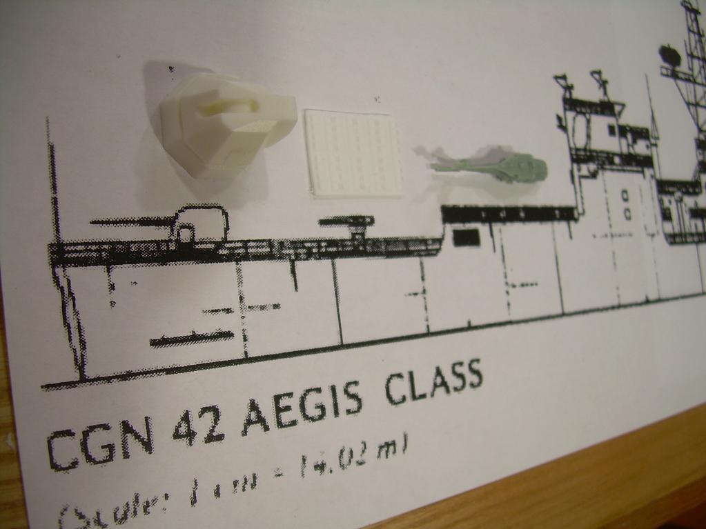

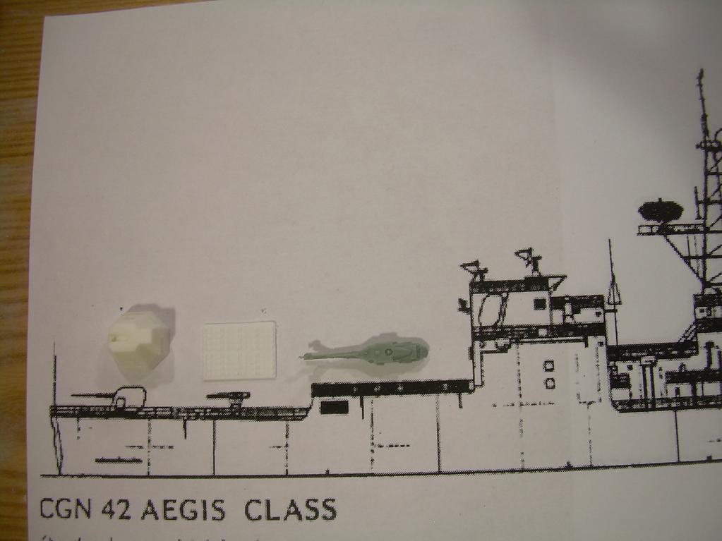

Alright, I am taking a method from the really successful scratch building guys on the board here. I have blown up drawings of the CGN-42 to 1/350 scale, and from here I will be able to draw my own plans based on these dimensions. This drawing is from when SH-2s were still planned for the ships so amongst the many other things like RCS reduction, new mast, different armament, etc, I will have to do a little modification to the landing area to accommodate the SH-60 famliy and expand the hanger a little to accommodate UAVs and associated workshops.
Another thing I still need to determine is whether to keep the RHIBs like DDGs have them or if I should try to enclose them like other countries like the Koreans do. I am open to discussion on interior vs exterior storage of the RHIBs.
Thanks guys.
Thanks guys.
