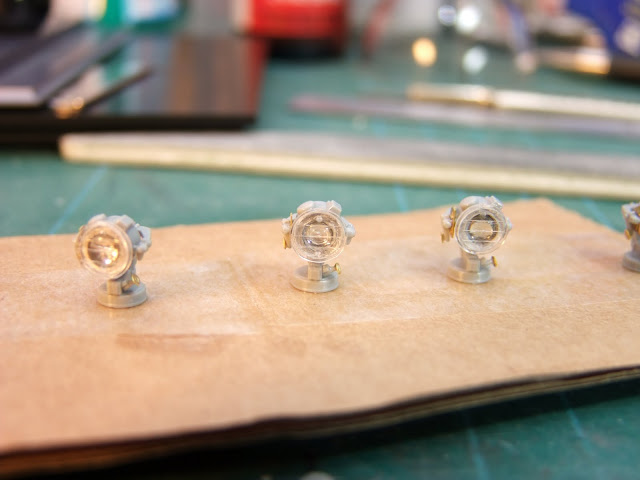

I've started to rework the searchlights. The clouded resin has been sanded down flat, then the large drill bit has been used again but to only make a small concave impression in the light. Silver has been added and set aside to dry.

On to business. I was looking at your searchlights and a thought hit me. I dabble in airplanes in 1/32 and 1/24 scale. I often use Future floor polish (I think they now have it branded as "Pledge With Future Shine") to make a glass lens effect in the instrument panels. It hit me that the same thing might work for searchlight lenses in 1/350. Try setting the searchlight part on its back and fill the depression for the lens area with Future. Then set it in a sunny spot (I put my IPs in the window sill to dry) and let them sit until the future is dry. It should set up within 24 hours, but depending on the amount you have to use, it might take a little longer. It should give you a very passable impression of a glass lens. I'm going to try this on the next set of searchlights I come to on the two kits I'm working on now.
If you should try this, let us know who it works.

It's not too late. I'm letting the silver dry til I get back. I'll fill one light with future and one with a new, fresh batch of clear resin. I'll post both so you can see the different results.

Have you considered adding a Grief lens used by armour modellers? I put 3mm ones in mine but wish I had gone with 4mm to reduce the thickness of the case.
Rob.

Your searchlights look great. Thanks for that suggestion. I've always built ships with solid lights. So, I've taken to drilling a shallow indent into them and painting the indent silver in an attempt to mimic that exact look. This is the first time I've worked with hollow lights and clear lenses. I think the flat walled, deep, hollow can doesn't reflect enough light if left stock. But, I had no idea that such a lens as you've mentioned could be purchased. I'll finish this build with the silver paint, and look into those lenses the next time I do searchlights.
