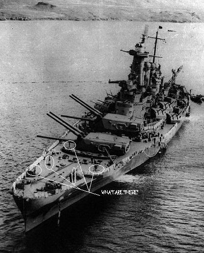

The top picture is what I h ave from Rick, albeit it's a crop just to show the 1.1"s and directors.

I did not notice any 20mm mounts either but after scanning the pics you guys posted and checking out the Washington website http://usswashington.com/photos.htm you guys directed me to I came across these items that may or may not be mounts for 20mms, if not what are they?pbudzik wrote: I found the bow cut out to be a bit challenging. In the photo of the Washington's bow after the collision with Indiana, I saw no evidence of 20mm mount as there was in North Carolina.
I was wondering if you guys think maybe the would "stowed" some of the light AA guns when not in a "Hotzone"?
To be honest I can not tell the North Carolina from the Washington so the only pics I know for sure are Washington is the ones withe a crumbled bow.(Edited to Add: I can tell them apart now,Platform on conning tower!)
Let me know what you guys think.
CWatson

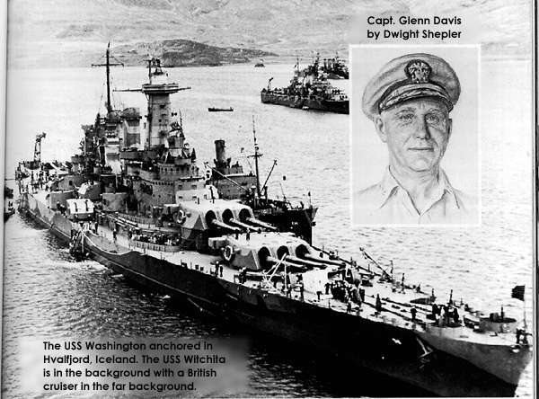

Is it confirmed the pic below is Washington? If not when did North Carolina get the cutout in the deck removed?
CWatson

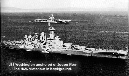

Digging through pictures of USS Washington on the net I came across these two . They are labeled as Washington but are they? I could have sworn I saw them labeled as North Carolina somewhere.
If these are Washington then the light AA fit is more accurate on the Trumpy kit then I thought.
The upper pic looks to have three 20mms in the gun gallery on the main deck next to "B" turret with two in the gallerie above it. The lower pic seems to show three 20mms on the second deck though. The upper pic seems to show a couple MGs or 20mms on the starboard side near the bow.
So what do you guys think BB-55 or 56?
Thanks again CW
Thanks again CW
AA Military Research
That's BB-55 and the things the yellow arrows point to are mounts for water cooled .50's. BB-55 lost her anchor washboard cutout during her refit of July-Sept. 1944.CWatson wrote: Is it confirmed the pic below is Washington? If not when did North Carolina get the cutout in the deck removed?
CWatson
Washington, Hvalfjord Iceland no question. You keep identifying mounts for water cooled .50's as 20mm mounts.
CWatson wrote:Digging through pictures of USS Washington on the net I came across these two . They are labeled as Washington but are they? I could have sworn I saw them labeled as North Carolina somewhere.

56 no doubt! there is the bare citadel/foremast 55 had one extra observation level halfway up.AA Military Research wrote:Washington, Hvalfjord Iceland no question. You keep identifying mounts for water cooled .50's as 20mm mounts.

Did 55 always have the platform? Looking at some pics of 55 early in the war I do not see it. I may be looking at the wrong platform if I am let me know.bb-56 wrote: 56 no doubt! there is the bare citadel/foremast 55 had one extra observation level halfway up.
I do not see the platform in the first pic but I do see it in the second. Is this the right platform?
